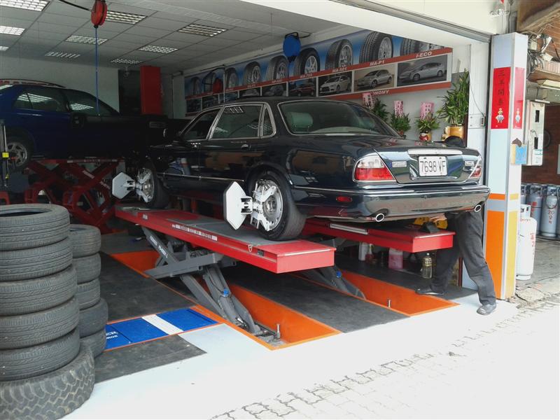

I made a whole research case about aligning my Jag last year, but really, there is nothing much special involved as long as they have reputable equipment and know how to use it.
The aliment settings are in the equipment's computer, and if you want, you can check and bring the settings out of the Jaguar instruction book.
There is one general issue discussed on this forum before, and that is the TOE- IN setting for the fronts.
Perhaps not scientifically proven, but coming from Brutal, a well respected member, they say it is better to use a spreader bar while setting the toe-in.
You can replace the spreader bar by just human force, push the front of the tires out while setting.
This should reduce the infamous tire wear on the inside of the tires.
Finally, camber on the rear can not be set by adjusting, but needs other spacers. You should be within the green if nothing strange happened though.
E.

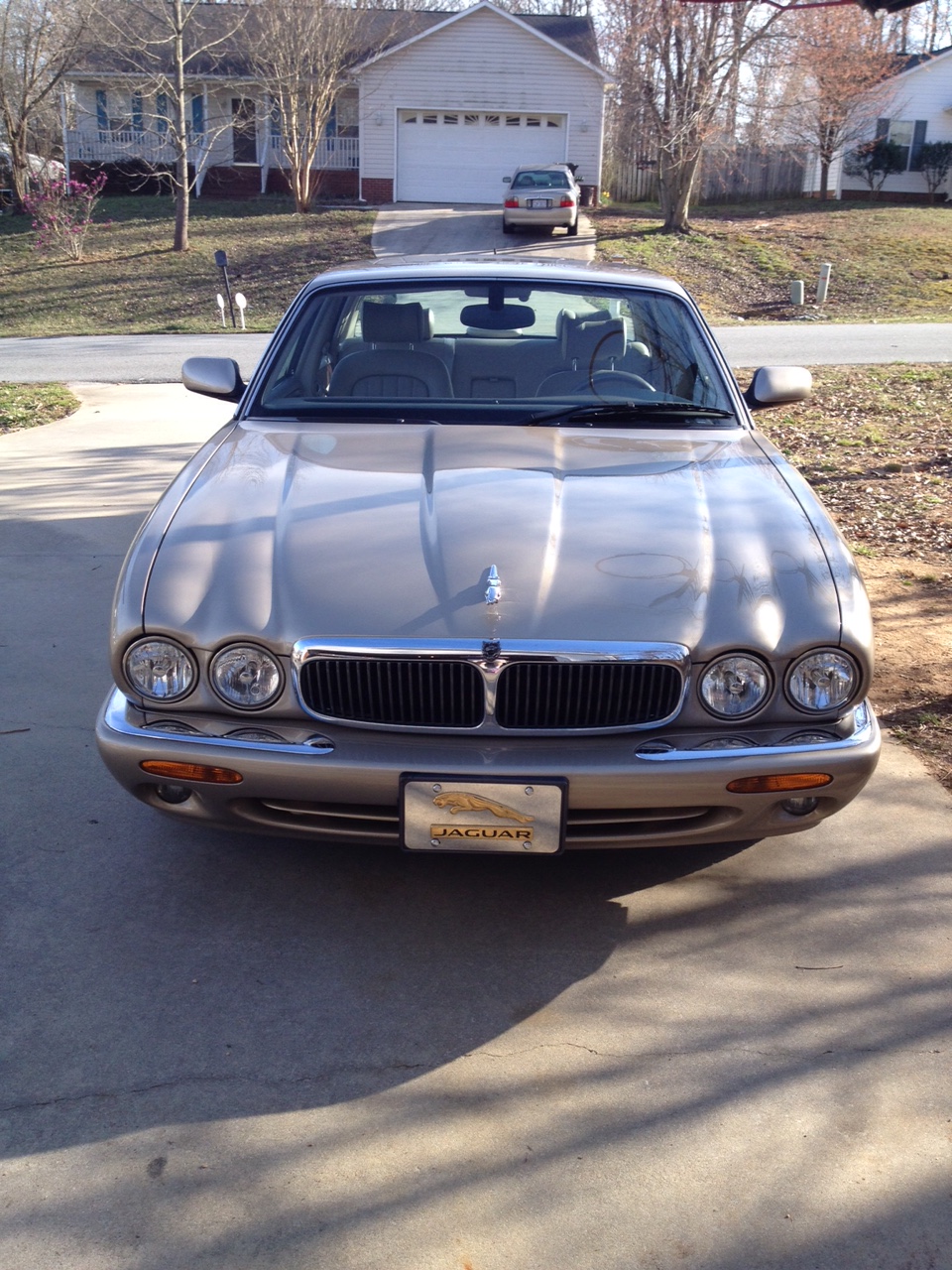

What is the best way to diagnose a hub bearing? If I can't hear them when driving then I generally assume that if the wheel doesn't wiggle when the car is off the ground, that the bearing is fine. I replaced both front hub bearings on my E30 just because of their age (23 years at the time), but they weren't giving symptoms.
I just washed and waxed the car, too. Looking really good!
P.S. -- Interestingly, the vibration does not seem to happen if braking uphill (off ramp to overpass for example).

She's looking nice, mine likes a nice coat of McGuires #26 yellow wax, ...she's picky.
To check the hub bearing, get the front wheels off the ground or one at a time. Then (preferably with gloves) grab the bottom of the wheel with one hand at 6 o'clock and put your other palm at the top at 12 and try to move it. Picking up and pushing in. If you get any type of clunking, there's a good chance you have a bad bearing. But it may also be a spindle ball joint. Either way, you shouldn't have any clunking and have located the issue, repeat other side. To check your tie rods use almost the same procedure, but only one wheel off the ground at a time for sure and using the 3 and 9 o'clock positions to check for play. This could also show a bad rack.
