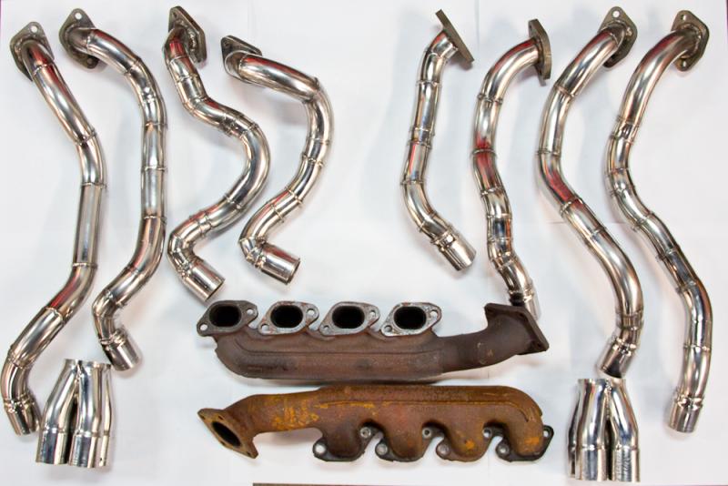

We are introducing our prototype long tube headers for the 98-03 jaguar xj/xjr platform. Very sturdy construction and hand made here in house. These headers will flow much more air then the stock manifolds which will render some very nice horsepower and torque gains dyno results are pending. This is a tight fit but we made it work, the headers are unequal length primaries that have double walled ends to prevent leakage which is a very innovative idea that came from our design team that flows into a scavenging 4 to 1 collector. This product as stated before is pending dyno results and we will have that information up very soon! We will also announce a group buy on this product once we have final dyno testing results, so if anyone is interested and have any questions please feel free to ask. All purged and hand Tig welded stainless steel construction.
Headers feature:
- 8 T-304 stainless steel 1.75” 16 gauge Primary Tubes
- 2 1.75” to 3” Collectors with velocity spike w/o2 sensor bungs
- V band clamp to mid section
- T-321 stainless steel ½” thick flanges
- New gaskets and hardware will be supplied
- Some modification to O2 sensors required, all instructions and material included
We hope to have more models very soon, as we would need test fit cars and if anyone is in the Atlanta area that is interested in this please contact us so we could work out details.

looks very nice I gave up the idea of the equal length as you probably found out as well almost impossible due to tight quarters. I am working on a bigger manny but will be very interested to see dyno results on these please post up quickly. I have be interested in going this route instead. Also a guesstimate on price of the group buy and how long of a wait time once order is placed tht would be great. Good job

Is that a mock-up or final product? Are you guys going to go with a mandrel bent process, or welding each section like that. I would think the mandrel bent would flow even better. Still, those look nice. What kind of adjustments are required to the O2 sensors?

Yes the equal length is almost impossible as you stated. We are hoping to have some results within a few weeks, we have a few track events that we have to attend to so we are getting ready for that. Estimate on price will be around $3500 give or take a bit but dont qoute me on that number.
The is a prototype in the photos, it will be hand made with madrel bend piping and much less welds on what you see there. Since the cats will be further down stream the rear o2 sensors will need to be extended.

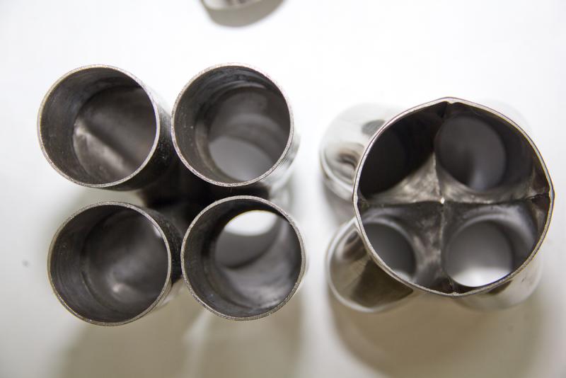

They stopped this development as the exhaust manifold would crack. cyl 7 and 8 which fire after another where you could get some gains is also not solved in this setup.
Attached pictures are from another try from a company in the UK, these are about $2600 (excluding fitting, cats and exhaust modification). These look already better, although 7 and 8 are still too close together, so not worth it imho.
The ones from bip do look the best, but if installation costs have to be added, custom cats, and exhaust modifications, you are looking towards $4000-$5000. I doubt you get massive gains (or even moderate ones) which would be assumed with these prices, but let’s wait and see.

When you keep referring to 7 and 8 being too close together and causing a crack, are you referring to the tube cracking or cracking at the flange?
If they're getting too hot, you can have them ceramic coated or wrapped with a woven ceramic or copper wrap. The wraps work very well. I had to buy block hugger shorties for my Ramjet 350 I installed in my Jeep because longshots wouldn't fit. (The Paramount set looks like a set of shorties.) Anyway, the headers ran HOT (and cooled FAST) and I was concerned about issues with my wires. I wrapped the headers and noticed a drastic improvement.
After dealing with headers on different vehicles, I would never recommend buying a set and installing them without properly wrapping them or sending them out for a true ceramic coating. Some companies offer a ceramic coating on their headers as an option before purchase. If you think about it, it's almost intuitive. You're going from a cast manifold which dissipates heat over a slower duration to a thin walled tubing header which dissipates heat drastically faster than a cast part. It's like heating a steel rod in a forge, then dipping it in cold water vs setting it in ashes to cool. What happens?
Lots of guys have used Jet-Hot Ceramic Coatings with great results.
So with the 7/8 cracking claims, did anyone wrap their headers or have them coated to see if that successfully mitigated the risk? Or were they simply installed and the results are as such?
