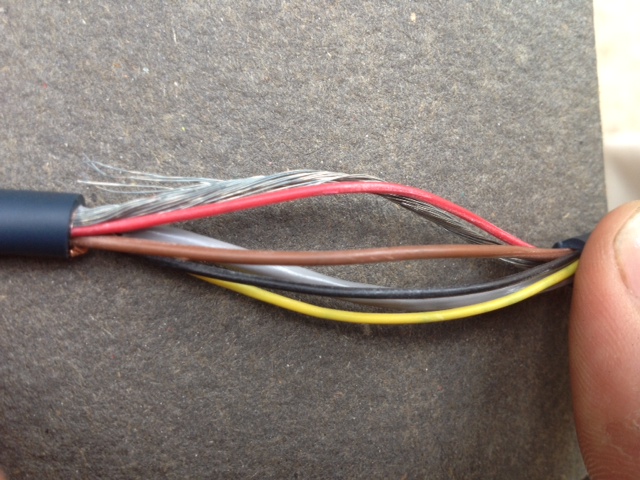

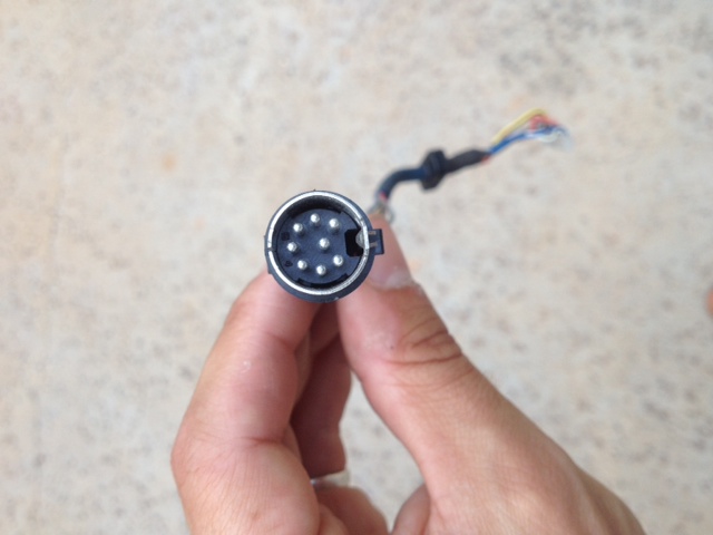

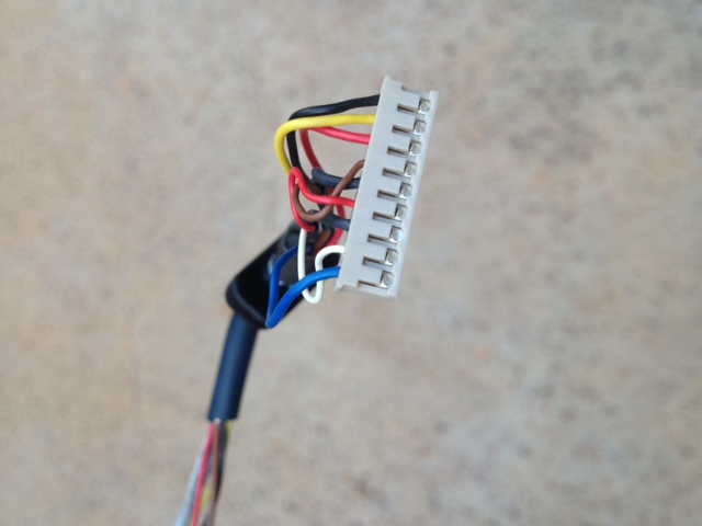

Here are the pics of my particular unit. I think it must be different because the wiring diagram and wire colors are different... Could someone please tell me which wires are ground / left / right?
I don't need the CD changer to work afterward, I just want to tap into it to run an AUX wire that will be used for an ipod when the original factory stereo is in 'CD' mode.
Thanks!!

Should have mentioned my unit says it's from 1996, and this is the part # LXF4160BA
Hopefully that helps.
