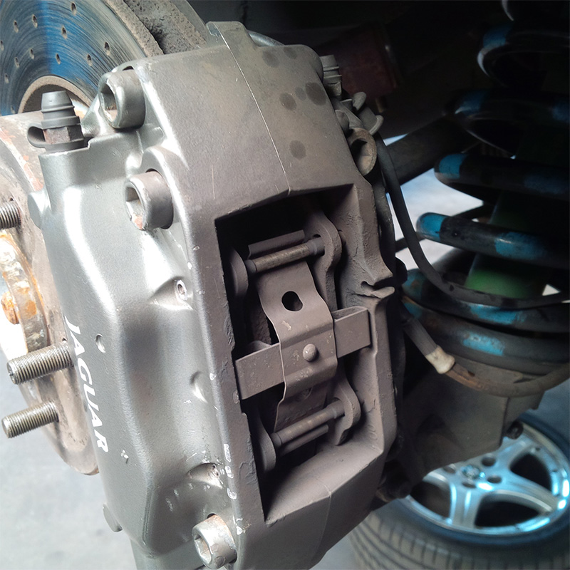

I want to repaint my Brembo brake calipers as they got some scratches and chippings. Since I want to repaint them as original as possible, I do need the RAL, PANTONE or CMYK code for the color.
Does anybody did this already and found a caliper paint whose color comes close to the original color (see attached picture of the rear caliper)?
I picked up the RGB color values with the pipette in Photoshop and ended up with PANTONE 424C (see attached pics) or PANTONE 422C (the lighter one), dependent from which picture I took it.

Can you get a paint chips book? These are books of sample colours from the paintshop's scheme, when I want a match I take a part to the paintshop and go through the chips books until I find an exact match, then get them to mix up a quarter or half litre of 2 pack.

If you can flat back (sand down) with fine wet and dry paper the offending areas then spray or fine brush with a sealer primer, flat that then a couple of light coats from a paint matched 2 pack rattle can should give nice results. I've never had the calipers that hot as to lift this type of paint, as long as the original paint is generally good it should be fine.

After doing a little further research, I came along the caliper paint kit from E-Tech in graphite.
This looks quite close to the original color. I'll report back, as I get the time to repaint the calipers.
