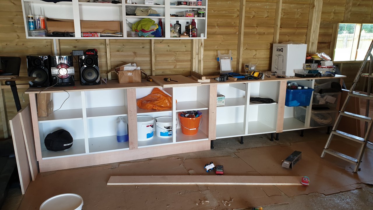

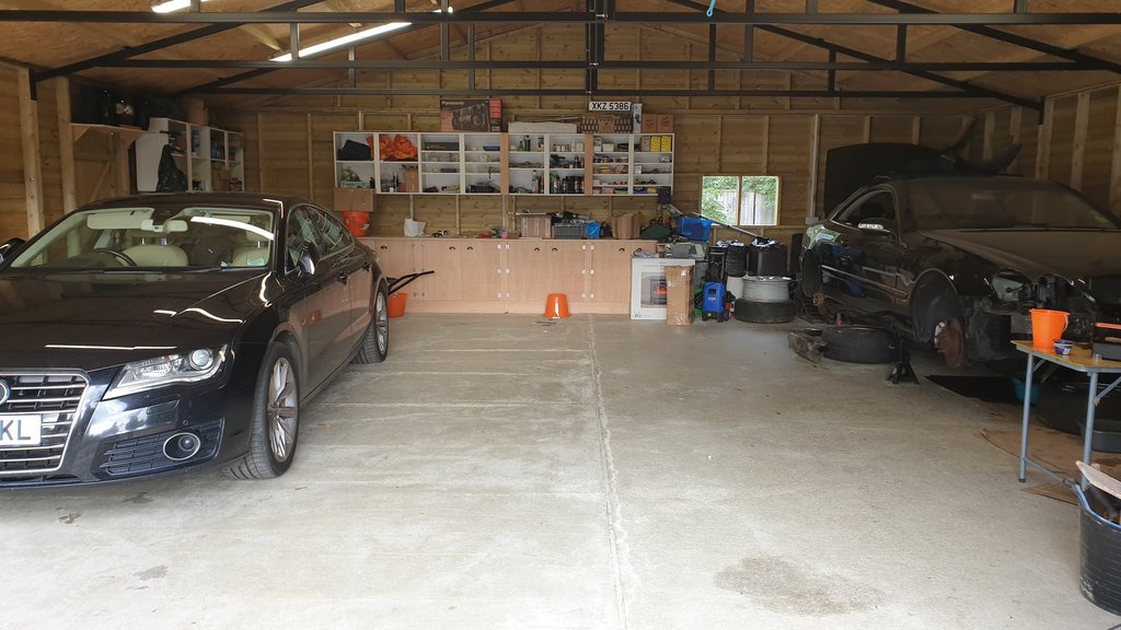

The big garage has gone from a giant empty space, to being full of the three cars and loads of our "stuff" from both the shed, house, cars, and garden. I needed to sort out the storage cupboards properly, so I could clear up and put some stuff away.
Last weekend I finally got to spend a day on it.

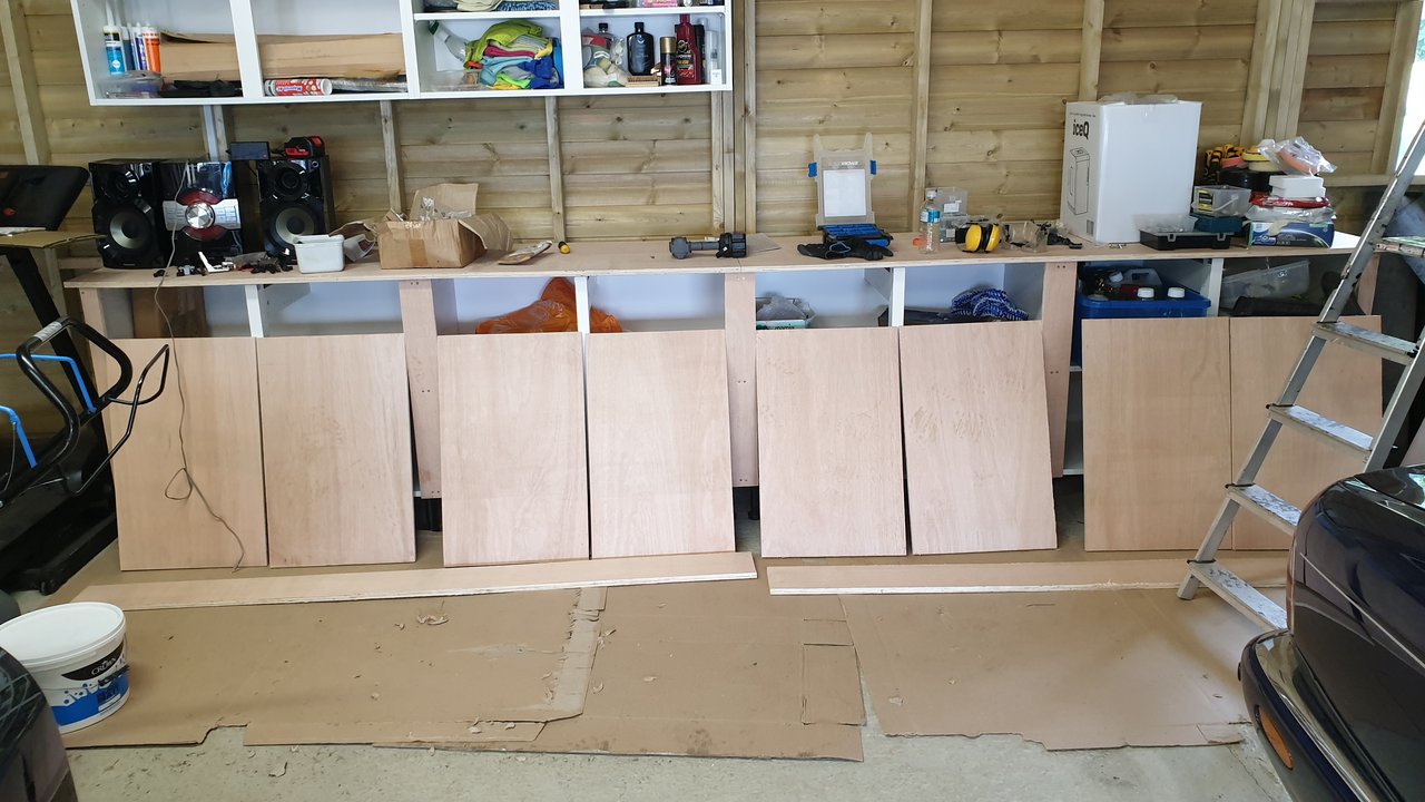

I ordered four sheets of 18mm thick marine ply board, and some timber. I had noticed that the 38mmx38mm timbers I had put in at high level to support the wall cabinets had twisted, and the cabinets had started to sag. I therefore had to take them all off and replace the timbers with some 100mm x 50mm pieces that could be secured better. These helped immensly.
Aston helped out as usual, by looking after the cabinets I removed from the wall.

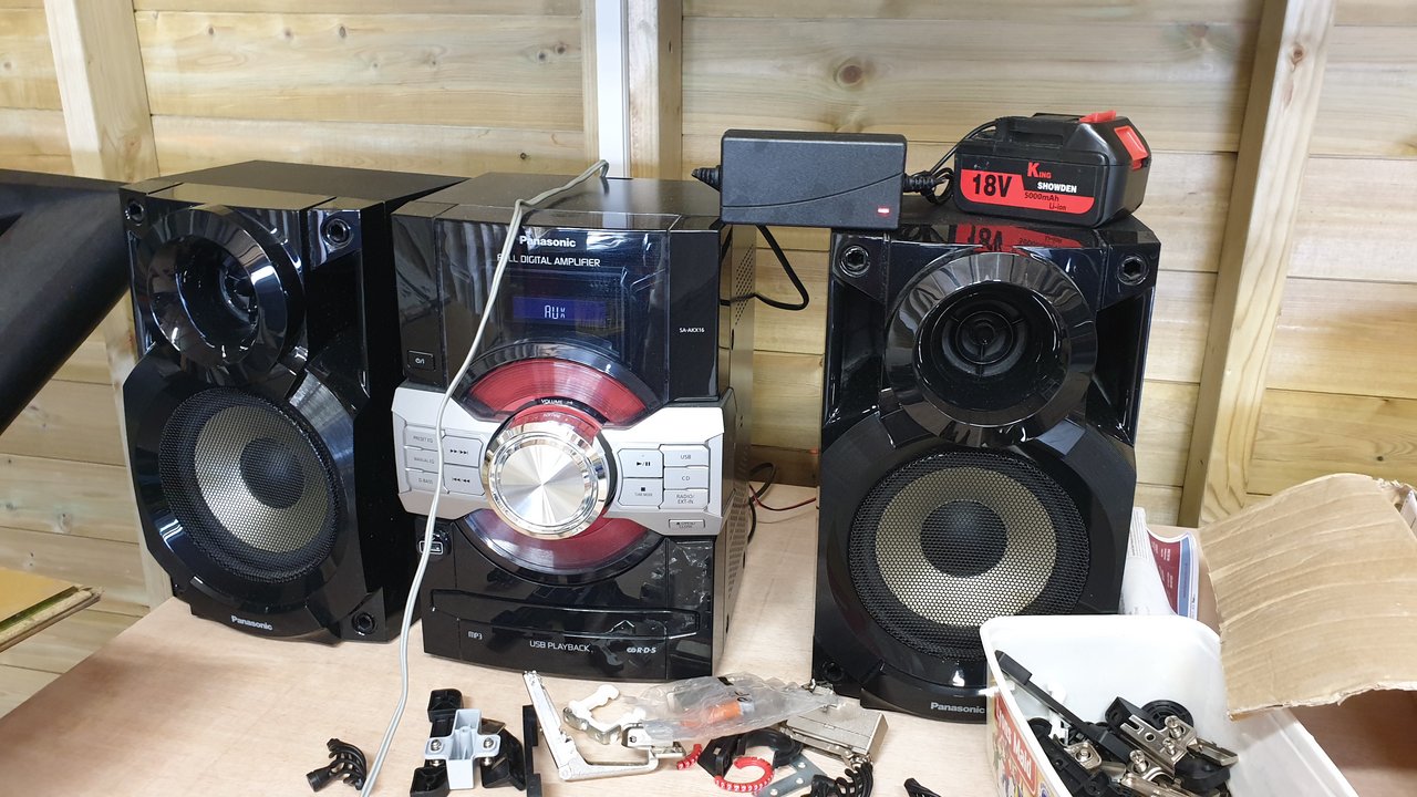

I set up my 10 year old Hi-Fi that had been lurking in the loft. This will come in handy for some "garage" music (Pun intended).
Then I setup some buckets to rest the large 1200mm x 2400mm sheets of plywood on, which I sawed them into pieces for the cupboards.
I then fitted kickboards, and center supports to hold the doors. I am going for an "industrial" look for the garage; which co-incidentally is much cheaper than all those posh kitchen cupboard doors you can buy.
OK, you got me, the cheapness is actually why I'm doing it like this... but I like it.
So that's it and up to date as of last weekend. I ran out of time, and had to down tools, but I also had no hinges or handles for the doors. More for me to do next week!

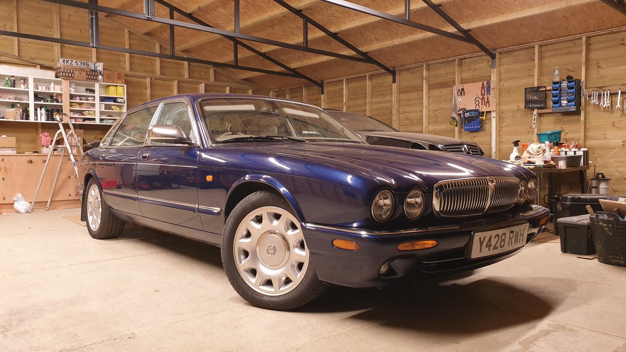

The Daimler finally gets some love and attention

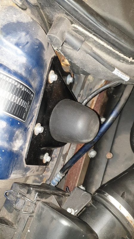

Nothing particularly exciting, but I finally got a few minutes to spend on the Daimler last weekend. I replaced the top front shock mounts, which are prone to going without much indication, and I am hoping are the source of my subtle "knocking" over bumpy roads.
It was so much easier than I expected, and I had both sides done in not much more than 30 minutes.

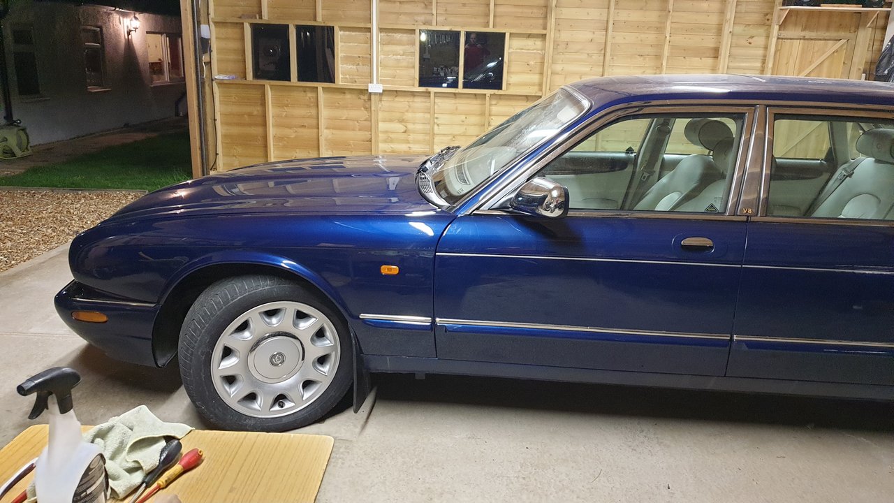

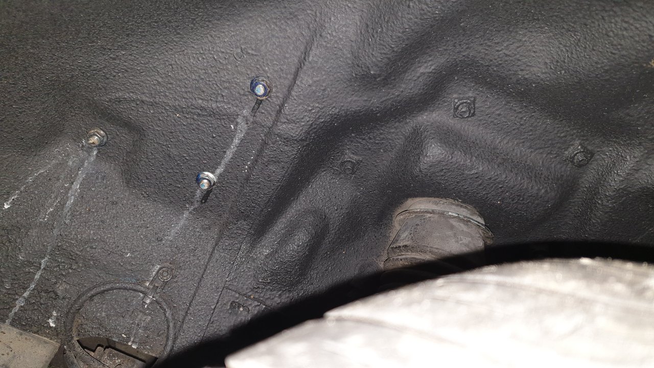

Before drivers side (no visible damage):
Before passenger side (damage visible, and this is the side that knocks):

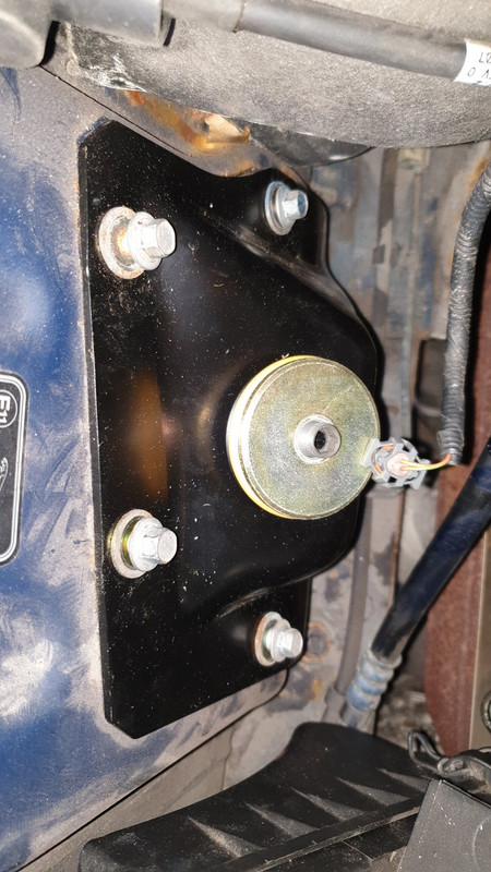

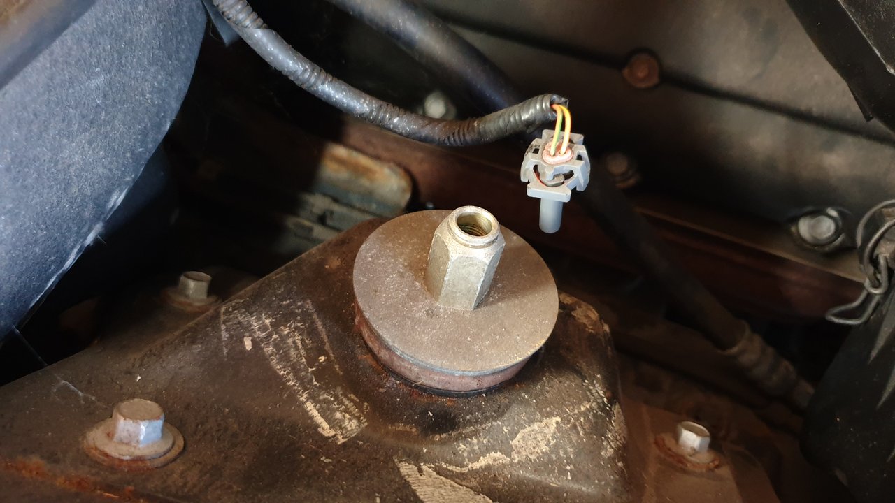

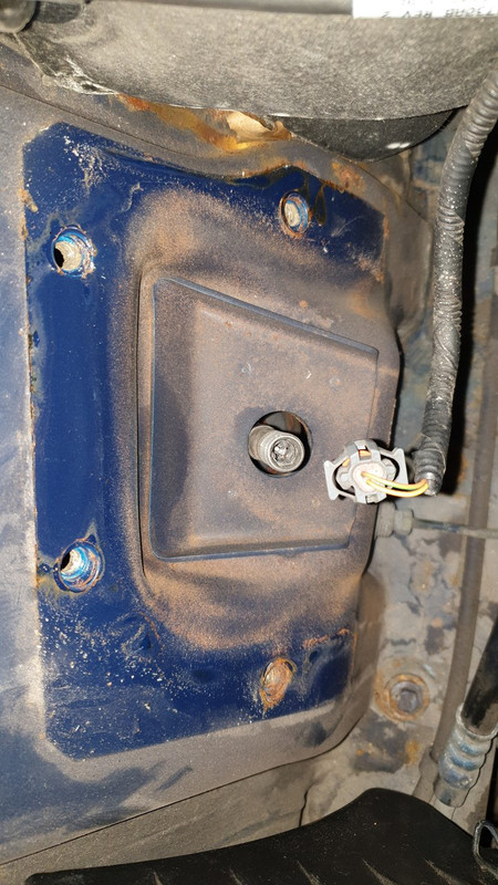

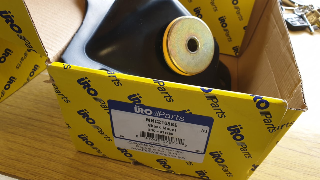

I purchased two replacements online from a USA company, because these CATS models seem very rare, and I could find no stockists in the UK, or at least not at sensible prices.

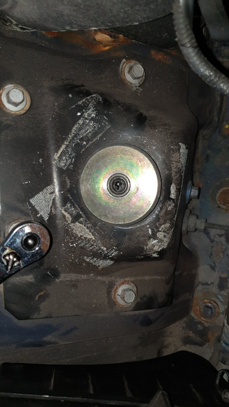

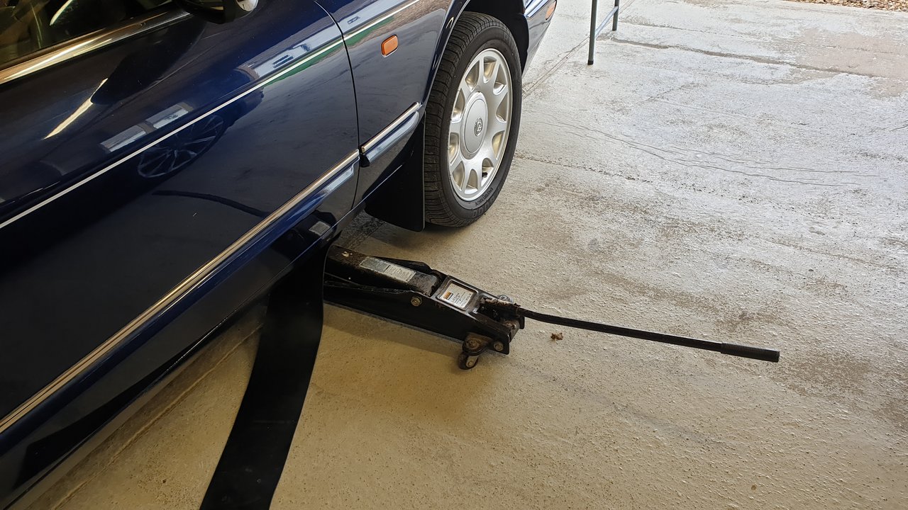

Steps to replace.... Jack the car up so that the wheel is just touching the floor:

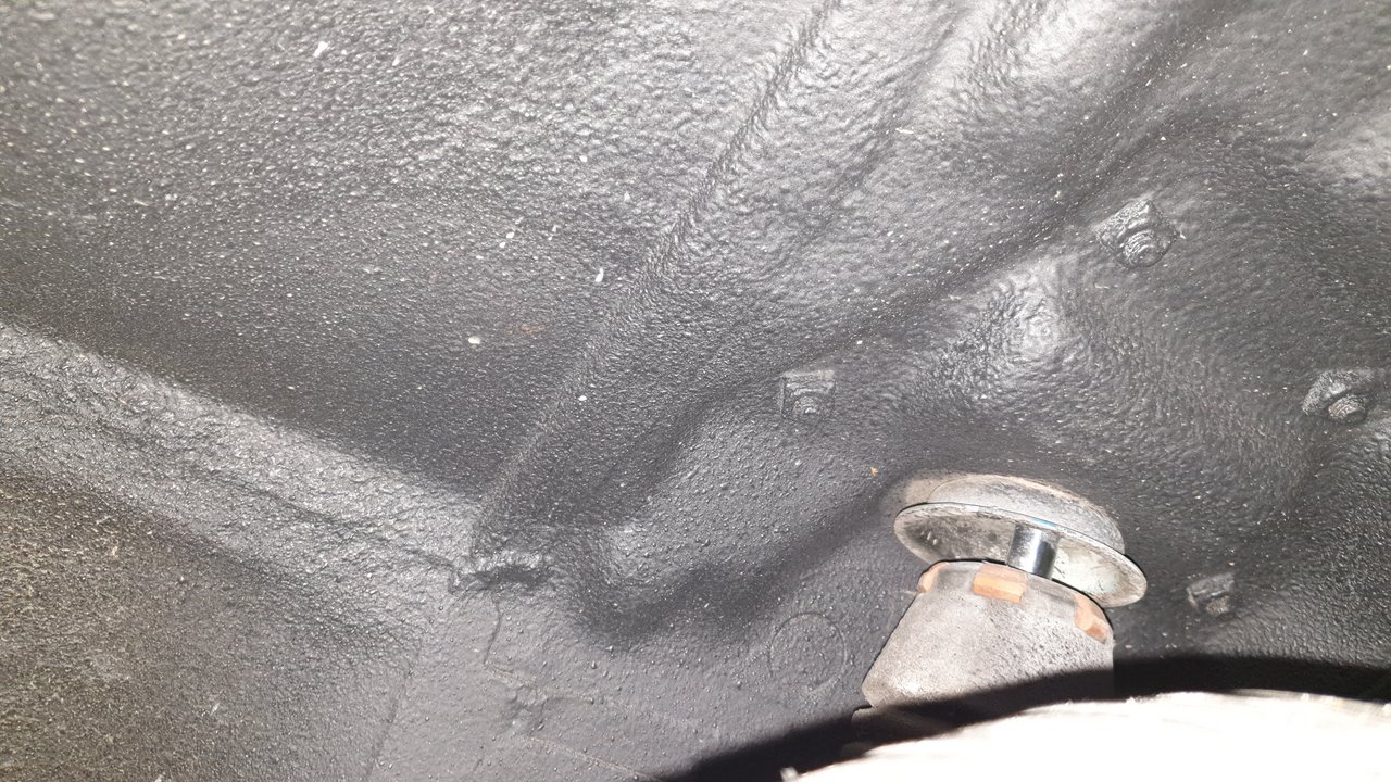

Remove top "tall" nut:
Remove the 5 hex bolts that hold the assembly in place:
The lift it away, the position of the strut poking through can be adjusted with the jack.
Fit the new assembly, making sure the strut top is poking through (again adjust with jack if necessary):
Tighten the tall nut back on. A pair of mole grips can hold the strut in place under the wheel arch:
Then I also purchased a used strut top cover a few months back, and popped it into place. This will keep the CATS (Computer Active Technology Suspension) cable safe.
All done!

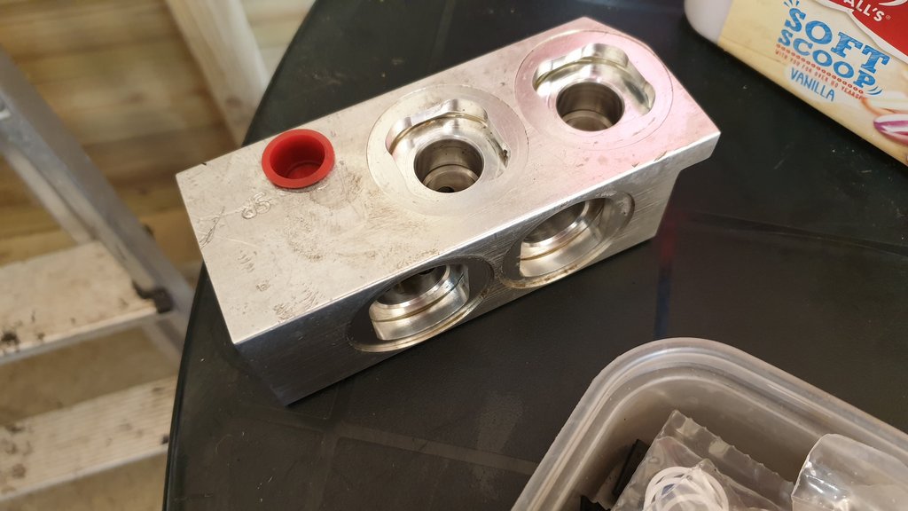

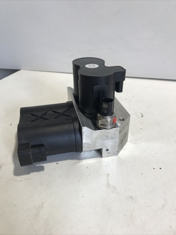

But when it came to the block, I quickly realised I had made a mistake. I foolishly assumed the W216 blocks were backwards compatible, and I purchased one at a steal for £108.10. I now realise the reason it was cheap is because these hardly ever fail, and are not suitable for fitment to the W215... Doh!
So I have ordered another ABC block, this time a W220/W215 version. This time I hope it goes without a hitch... shame it cost me £205!!

Replace rusty front ABC valve block (The W216 block I bought £108.10 is no good. Replacement A2203201258 ordered £205 Ebay).

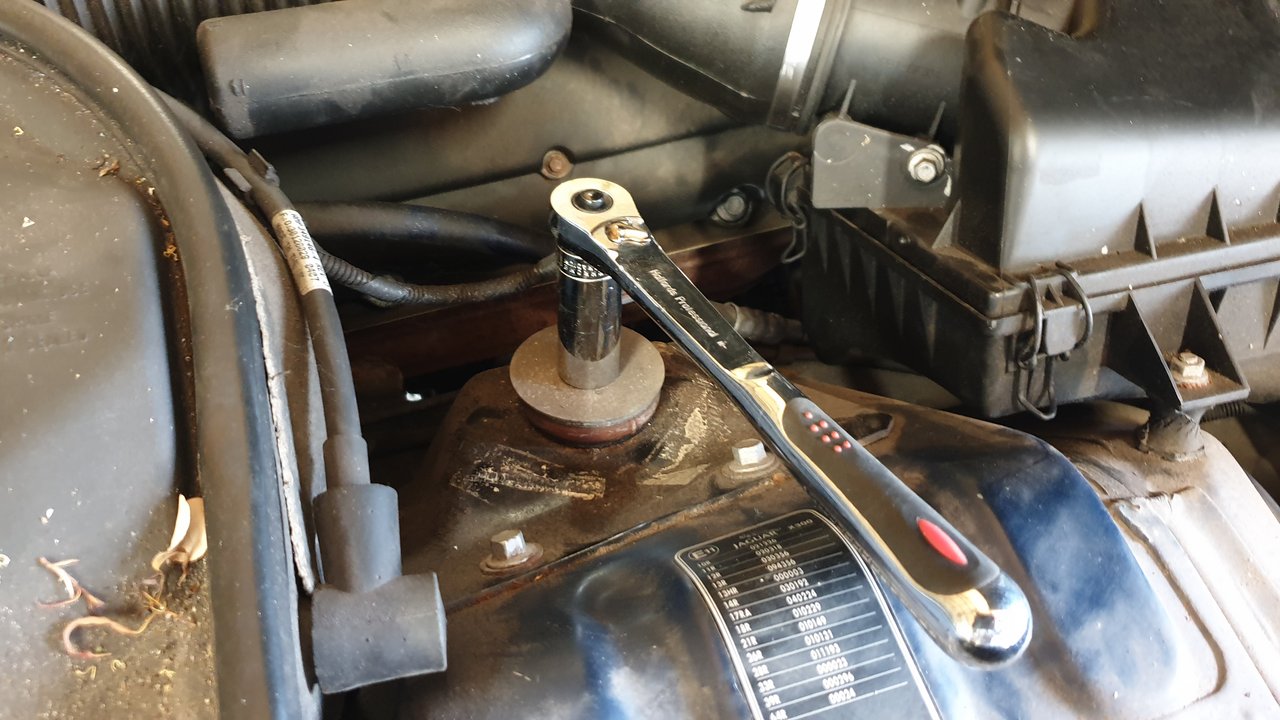

All done!

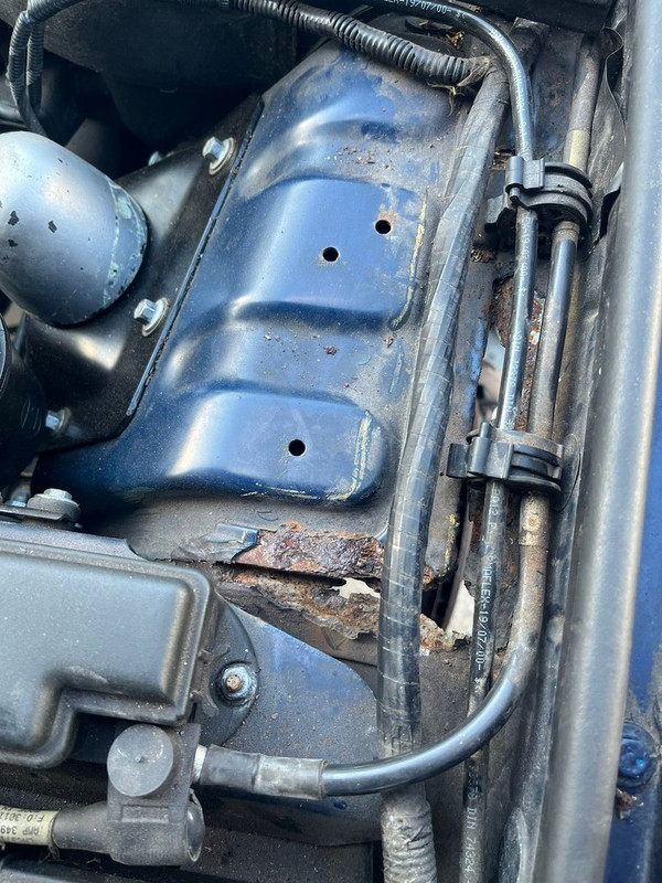

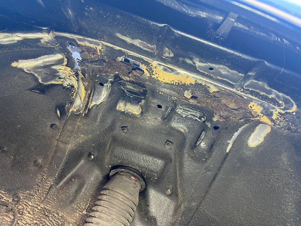

Turns out it's pretty serious, as when the paint and loose rust was broken away this is the state of things! (Same both sides)
...and this is it from inside the arch:
It needs this section cut out, and fresh metal shaped and welded in. Luckily I found a good panel beater and body shop who know each other and work together!

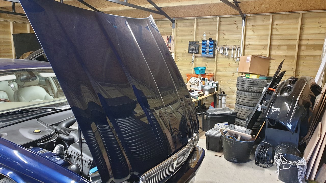

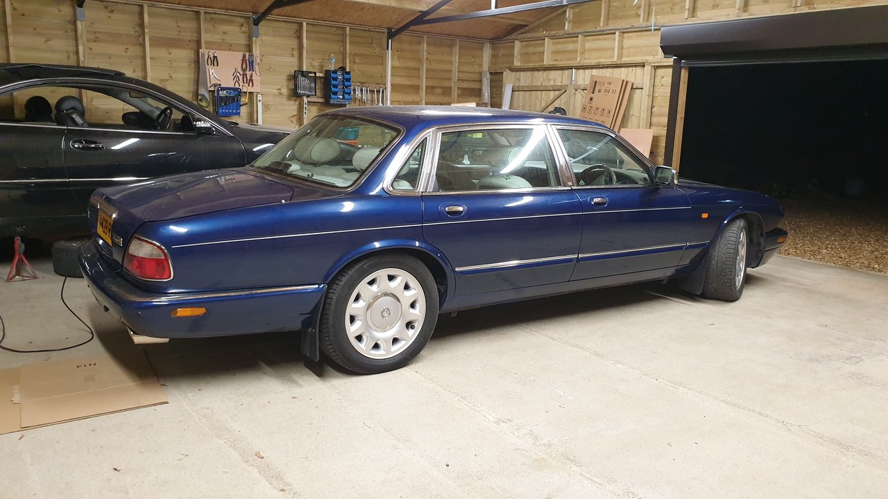

The Daimler was dropped off at the bodyshop, and we were left with a nice empty garage space in the middle. The eagle eyed will also notice my lower cupboards at the back now have doors. I did this a few months back, but I still need to sort out the high level cupboards.
Also notice the orange buckets... Aston has been using them as steps so he can tinker with all my stuff!

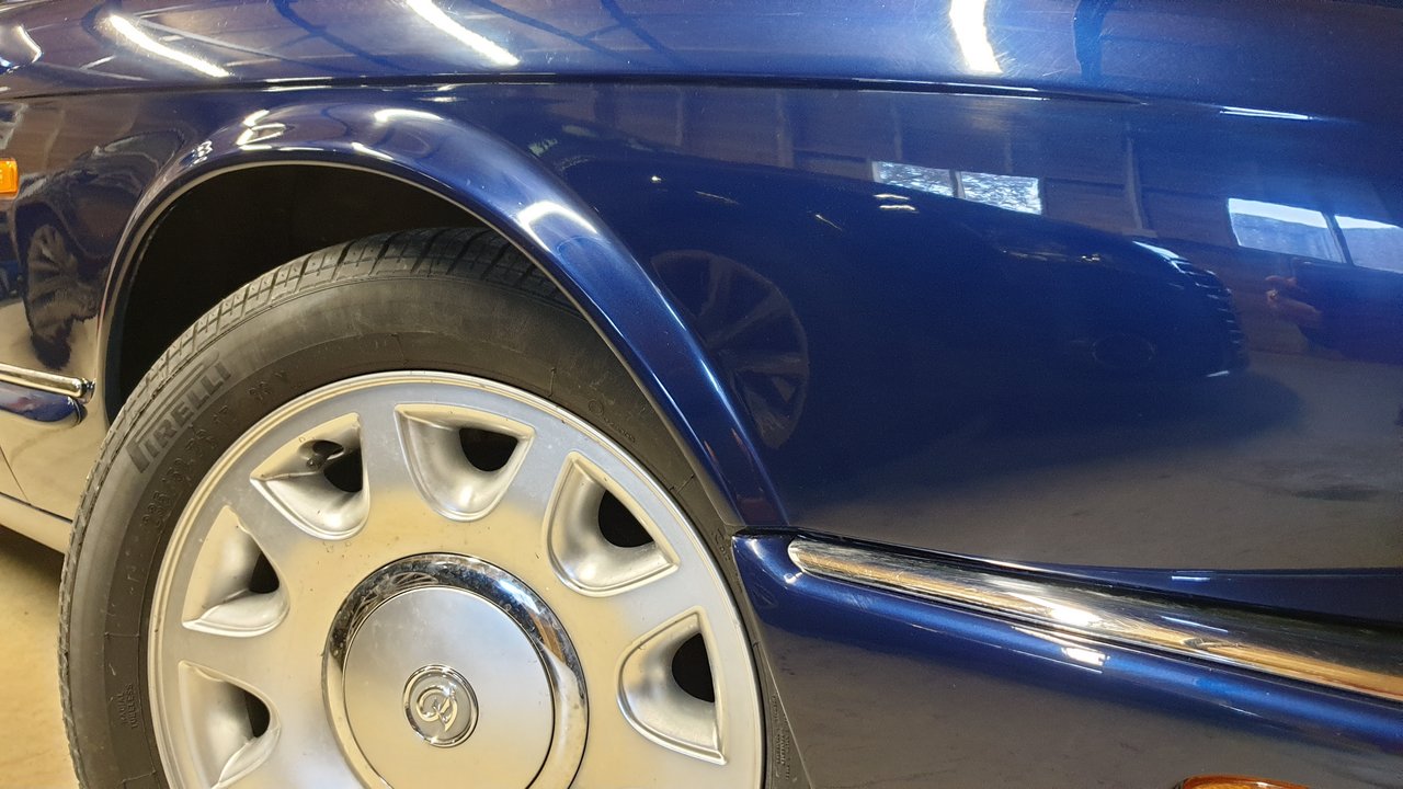

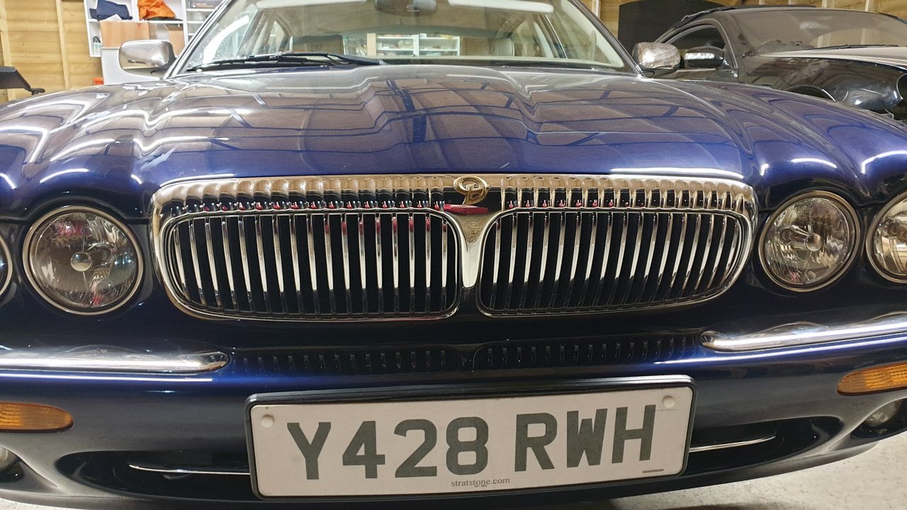

But what I forgot to mention before, was that I also took the Audi to the bodyshop to have it repaired too... this now looks wonderful!
They have done an amazing job, and the car looks near perfect now. It runs out of MOT in November, so my plan is to put another 12 months on it and then move it on (sell it!). Sadly I have become quite fond of Jellybean now (the Citroen), and the Audi is therefore surplus to requirements.

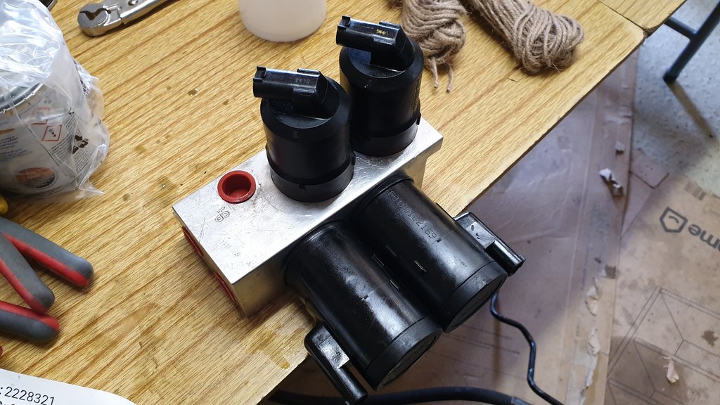

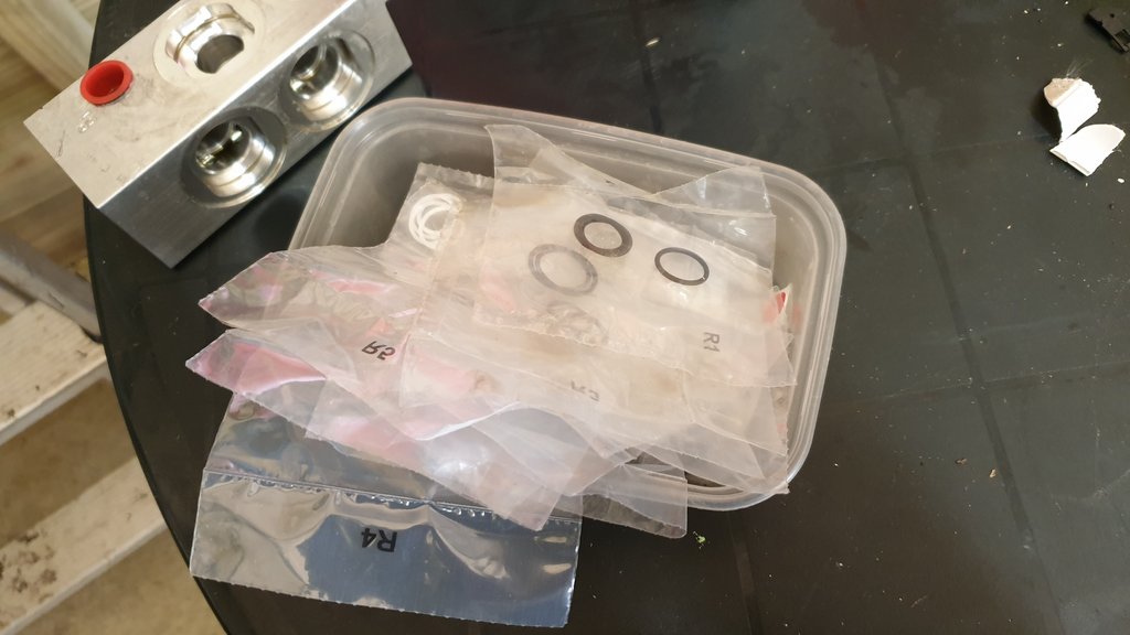

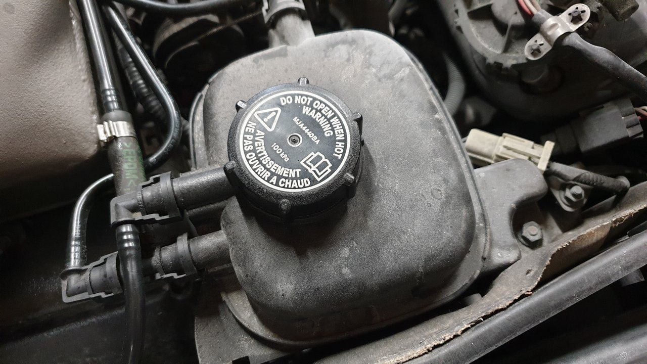

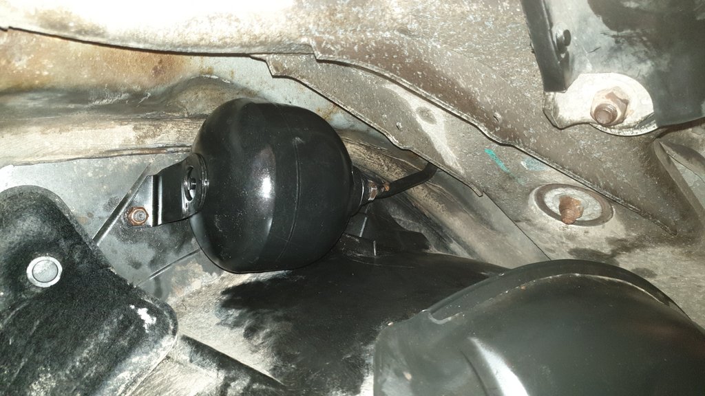

So fast forward to Saturday 24th September, and more work on the Mercedes CL happens!

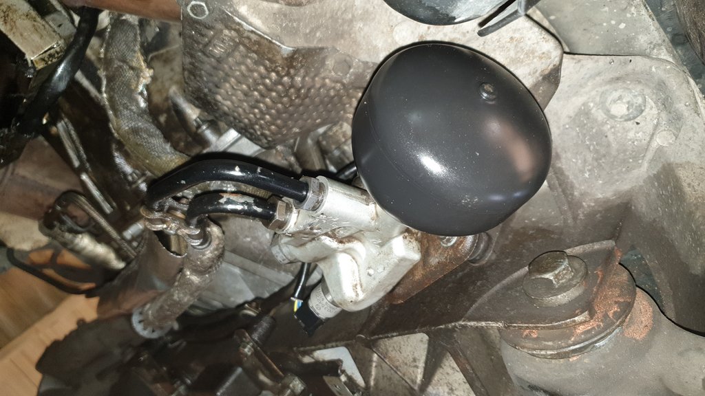

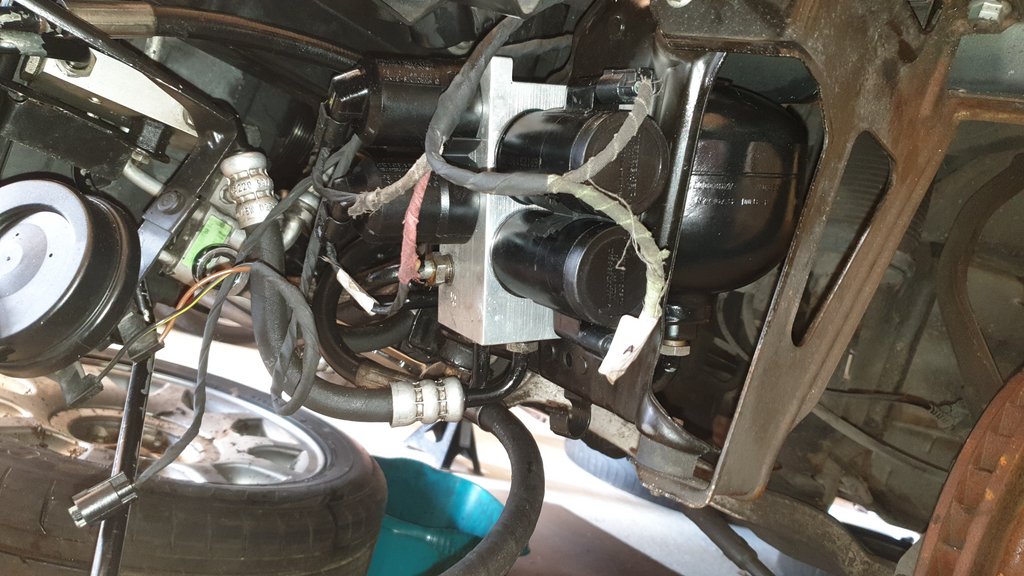

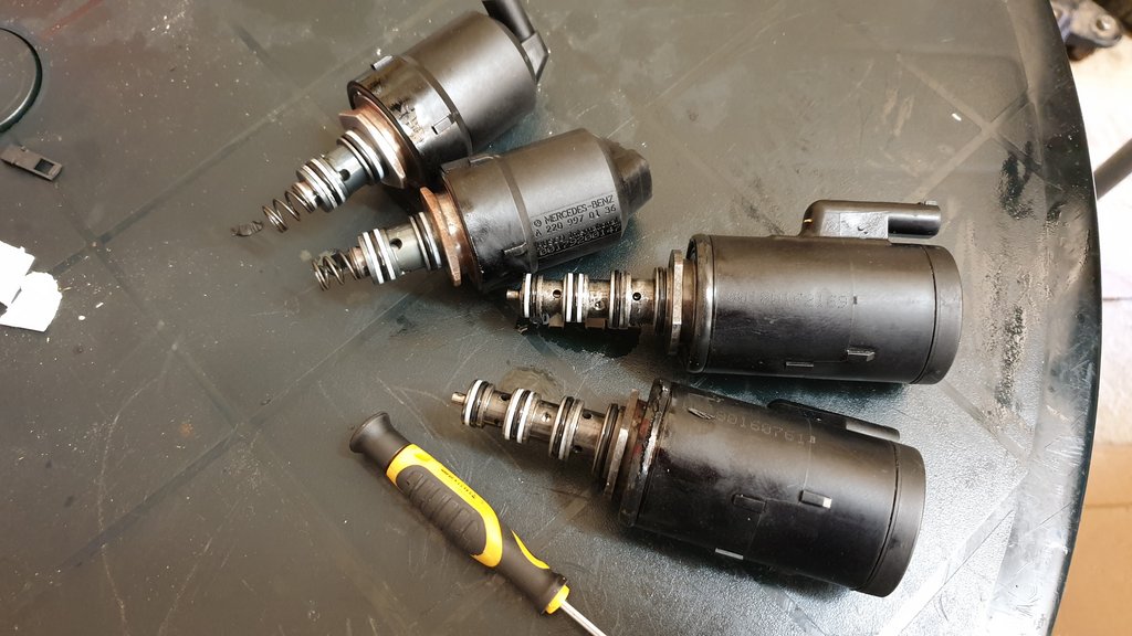

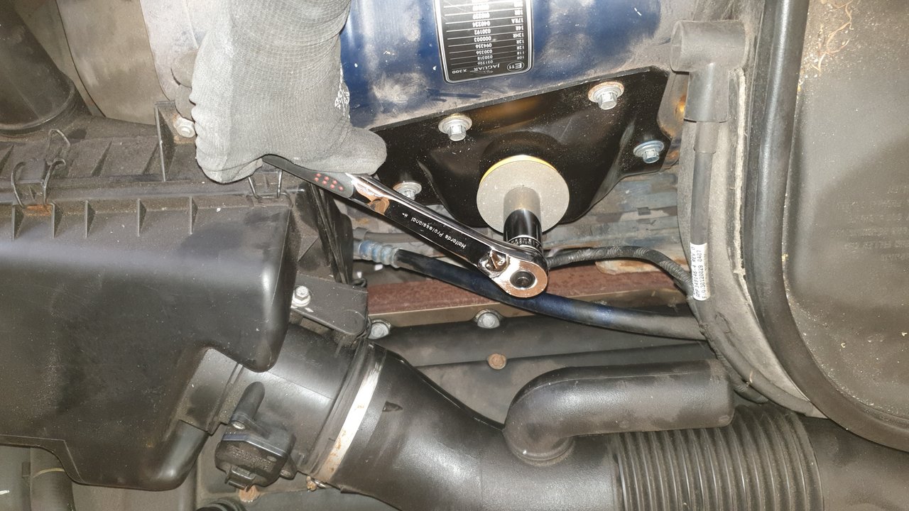

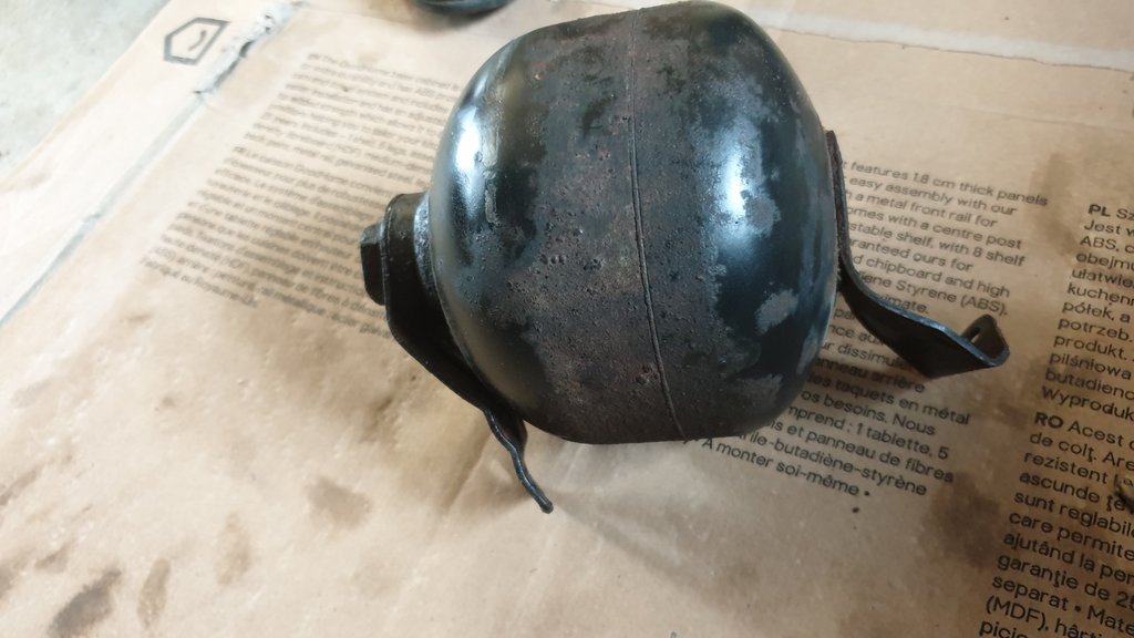

First of all, we manage to get the old Pulsation dampner off, and replace it with a crispy brand new one!
Then I received my replacement ABC block for the front, and was able to install the refurbishment kit to it, and then fit it.
All fitted with accumulator!
We also managed to remove the rear main accumulator too, and replace with new.
Due to access this was a real pain, and I had to bend over the mounting legs to rotate it and get it out, as the hose fittings has seized completely. I had to spend ages freeing them up before the new one could go in.

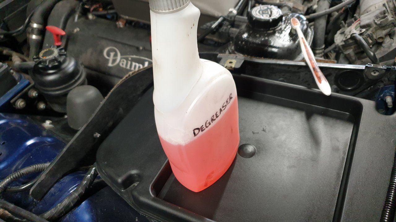

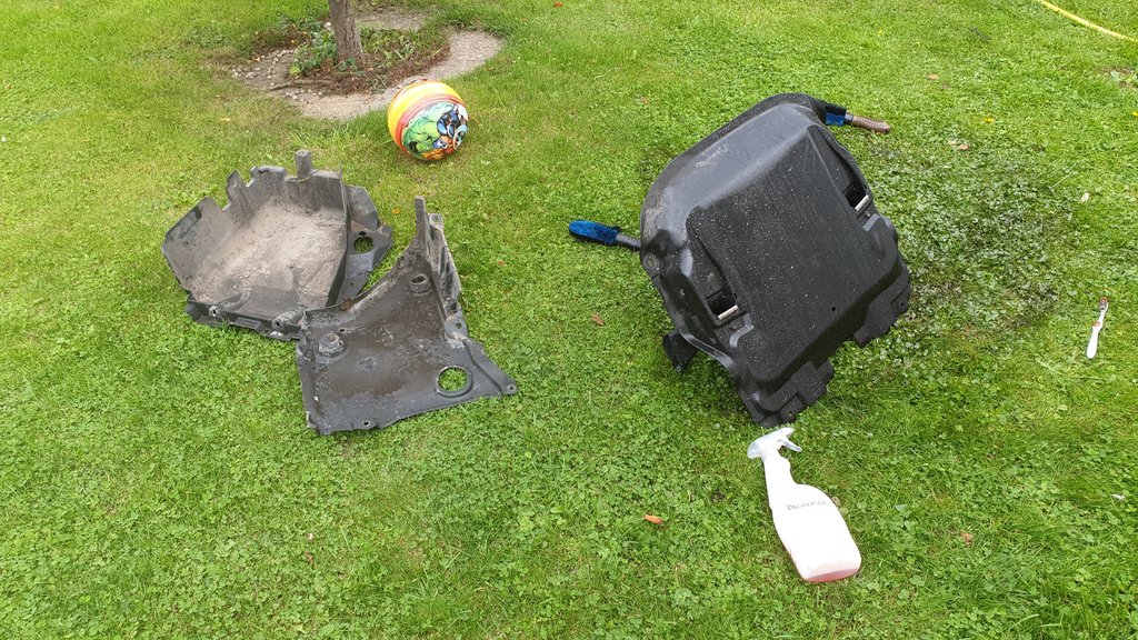

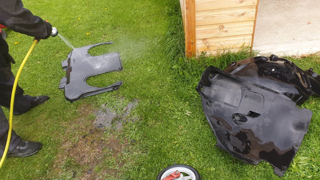

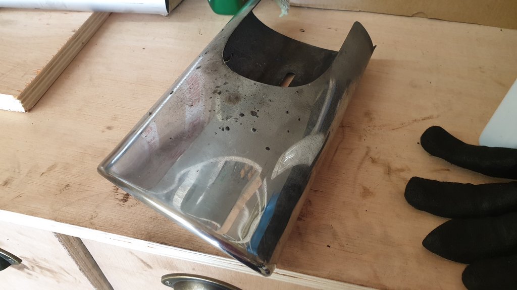

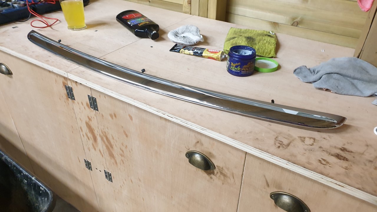

Then I decided all the undertrays needed a jolly good clean with Meguiars super degreaser and a hose!
Lastly for the Mercedes... I used tar removed, Autosol, Mequiars ultimate compound, and Meguiars chrome cleaner, to shine up the tail pipe trim from the exhaust we had to remove to get to the rear main accumulator.
So my updated list for the Mercedes CL ABC works:
- Replace rusty front ABC valve block (Replacement A2203201258 ordered £205 Ebay - Fitted and DONE).
- Replace main front hose (A2159971382 used parts on order which cost £71.66 hose - Fitted and DONE)
- Refurbish the rear ABC valve block (DONE WITH KIT FROM X8R)
- Replace front main accumulator (Part A2203270115)
- Replace rear main accumulator (Part A2203270115 I purchased a pair brand new for £257.32 Fitted and DONE!).
- Replace the third (smaller) return accumulator (Part A2203270415 bought for £154.17 and fitted).
- Replace the pulsation dampner (Part A2203270215 I purchased one brand new for £114 - Fitted and DONE).
- Top up the fluid after the above, to test (I purchased 1ltr of Pentosin CHF 11S for £15)
- Inspect/clean OR replace the ride height sensors (Part 0105427717 at between £20-50 each - not purchased yet)
- Change the ABC fluid and filter (may get a Mercedes specialist to do this...)

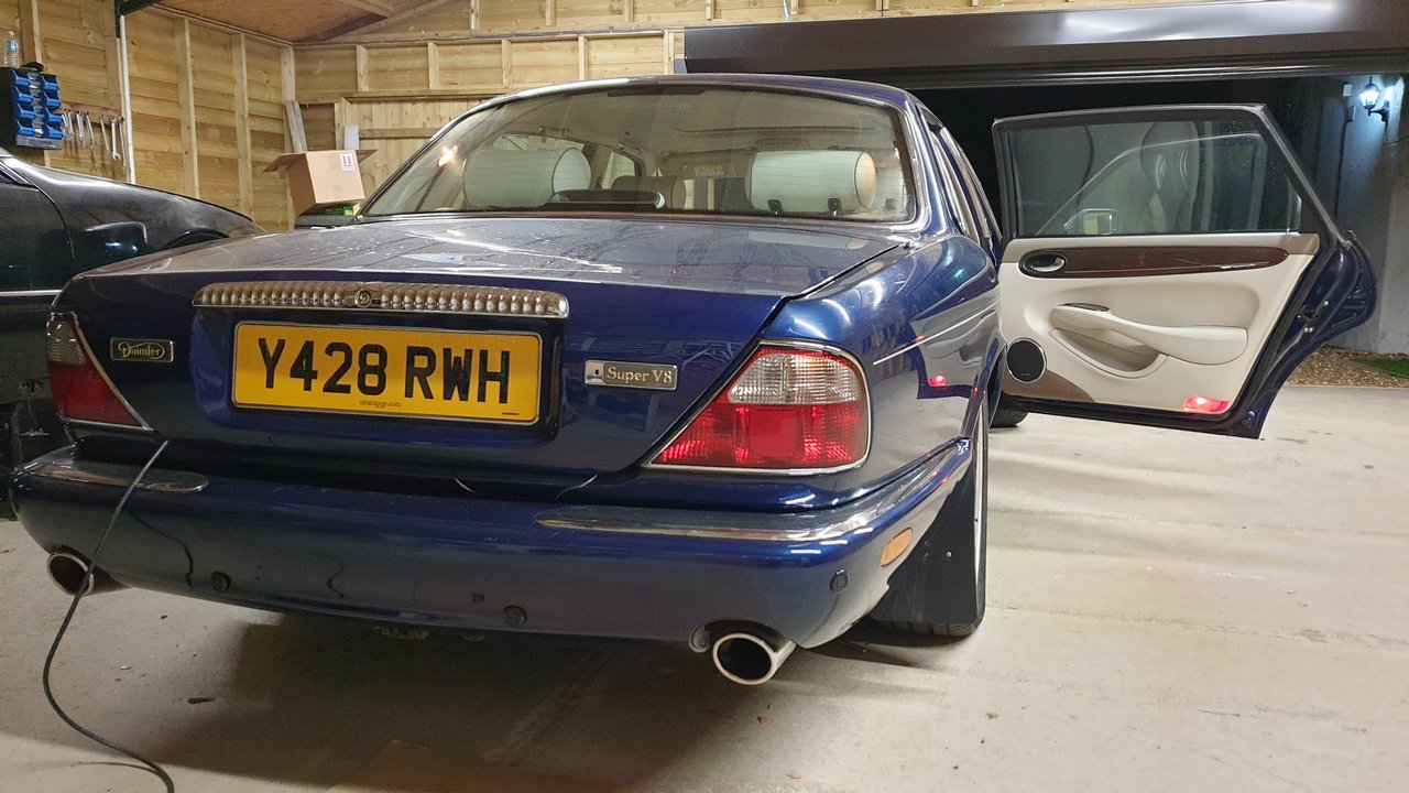

After cleaning up the Audi on Sunday, I did not have much time to spend on the Mercedes CL500.

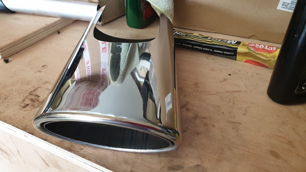

I re-fitted the drivers side exhaust section (which had to be removed to get to the Rear main accumulator), and it looked fantastic with a cleaned up exhaust tip.

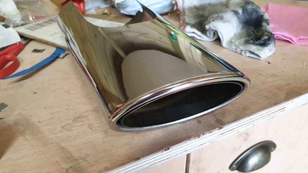

So I decided to do the passenger one too!
They were cleaned with Autoglym tar remover, polished with Autosol, polished again with Meguiars ultimate compound, then a final finish with Meguiars metal polish to shine them up.
It's a real testament to the quality of this Mercedes. The whole exhaust is no doubt original, but is in near perfect condition. The exhaust tips are polished stainless steel, and they polish up beautifully, with little effort.

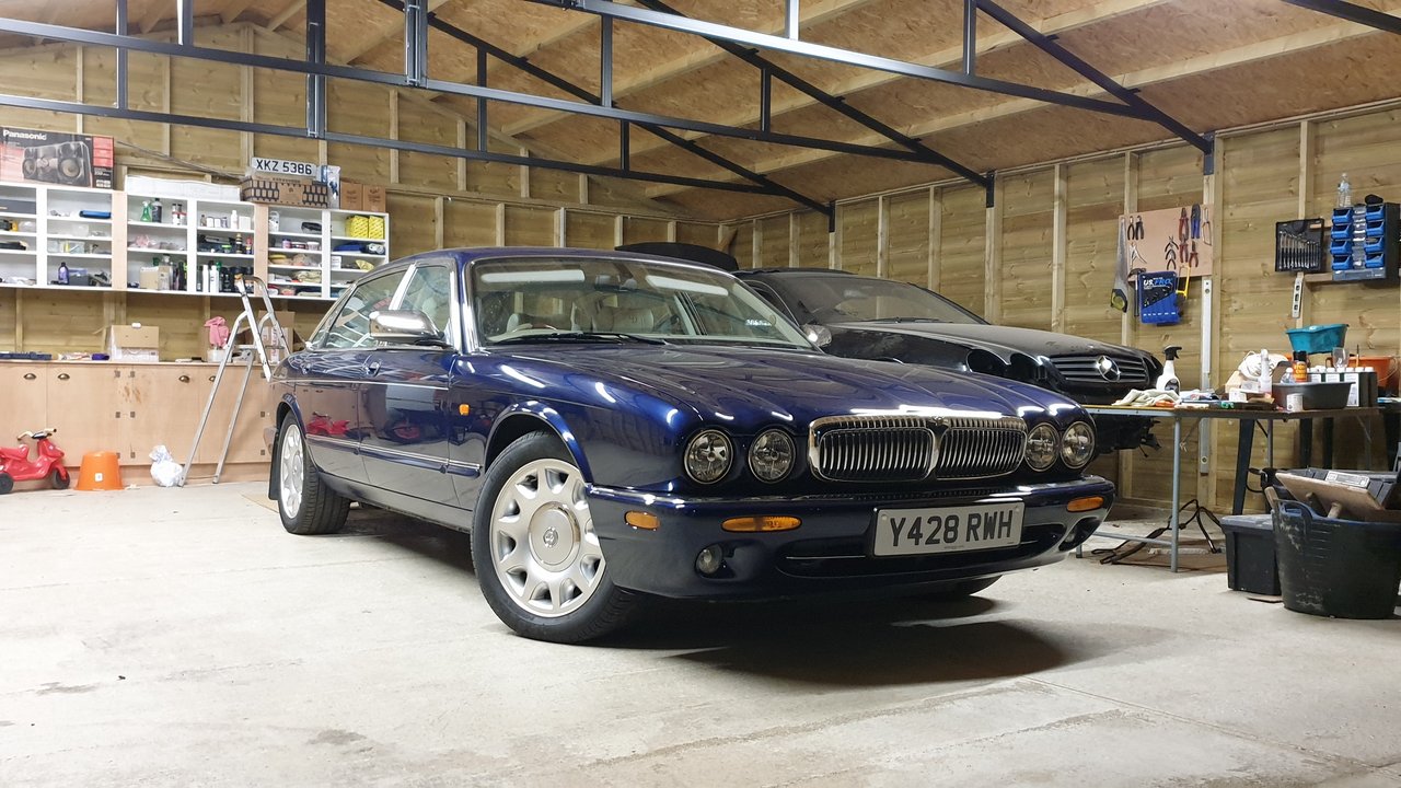

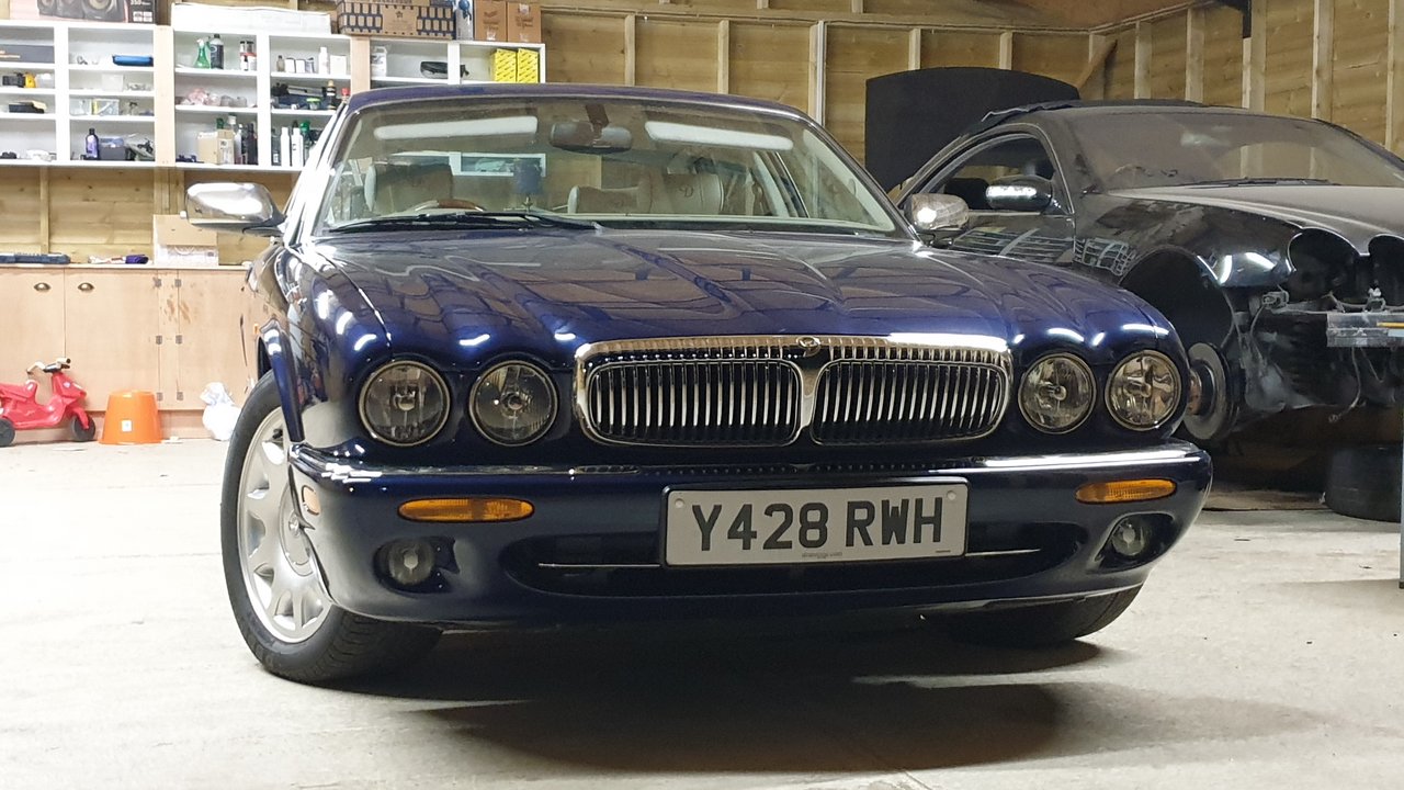

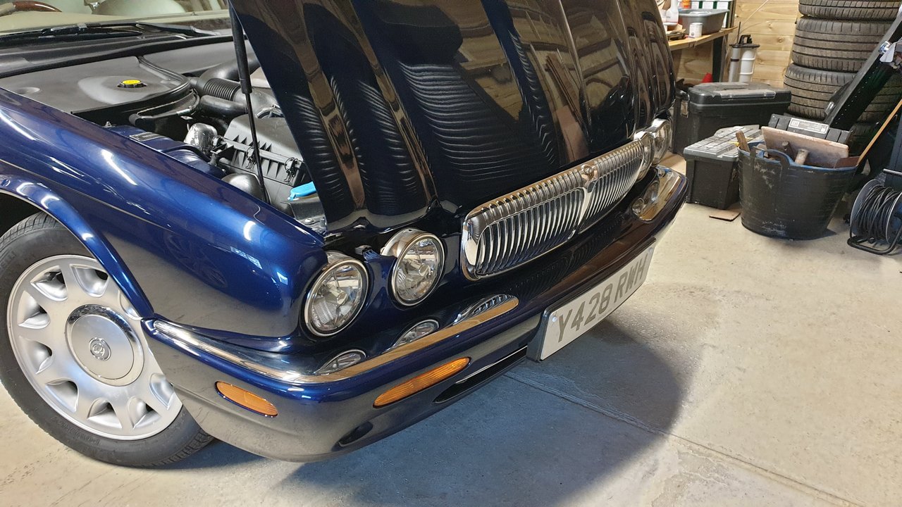

So the good news is the Daimler is back, and I am thrilled with the paintwork done. It's 100% better than the last place I used, and it means the Daimler would now appear perfect to the average person.
It has had the following beauty treatments:
The suspension struts are repaired inside and out.
Full bonnet respray, off the car. The front trims around the lights were also painted to match, as well as both front arches blended.
Front bumper removed, all accessories removed and full respray.

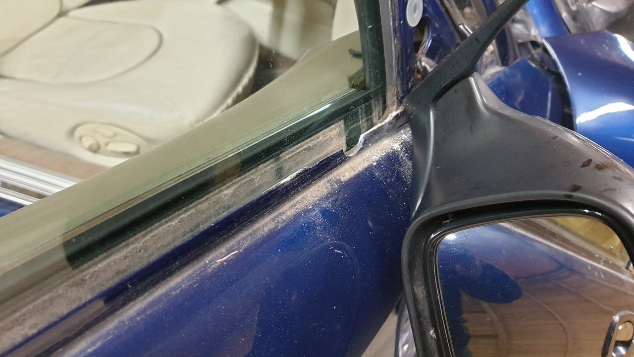

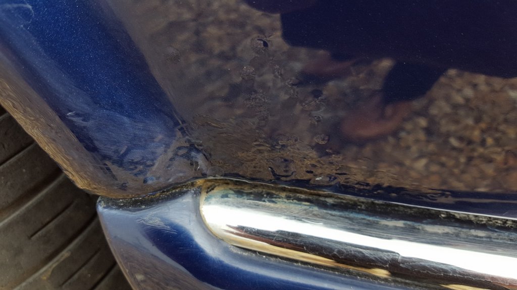

Rust repair to front drivers side arch (this was missed by last bodyshop)
Rust repair to lower edge of both passenger doors
It looks tremendous... but nothing ever goes to plan, and there are some new issues for me to sort.

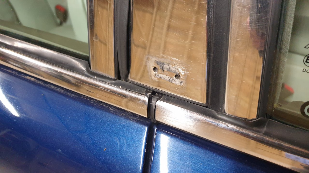

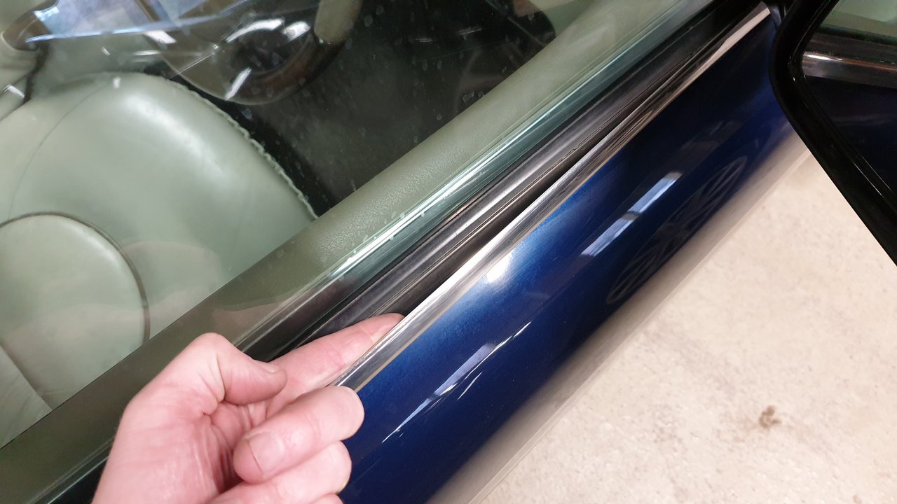

First, the spray work went over the pinstripes, and the sprayshop did not know how to replace them so left them missing.

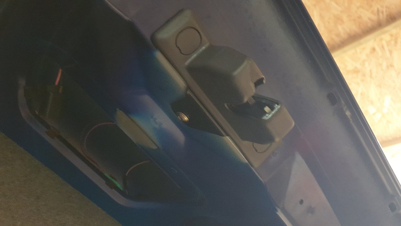

The boot now only opens by key. The boot lid button does not work, neither does the fob button, or the button on the dash.
I can't figure out why...

Lastly, the coolant now continuously says low level on the dash, even though coolant level is fine.

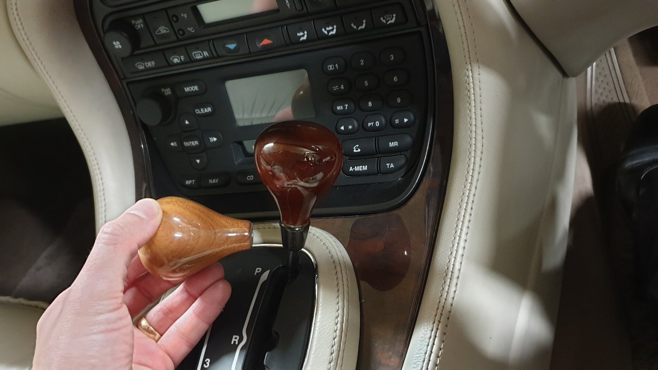

On Sunday I cheered myself up with a couple of easy wins.
I replaced the faded old gear knob with a nice spanking brand new one.

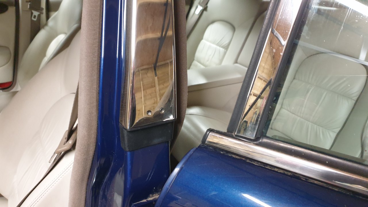

I shined up the lower chrome trim from the front bumper.

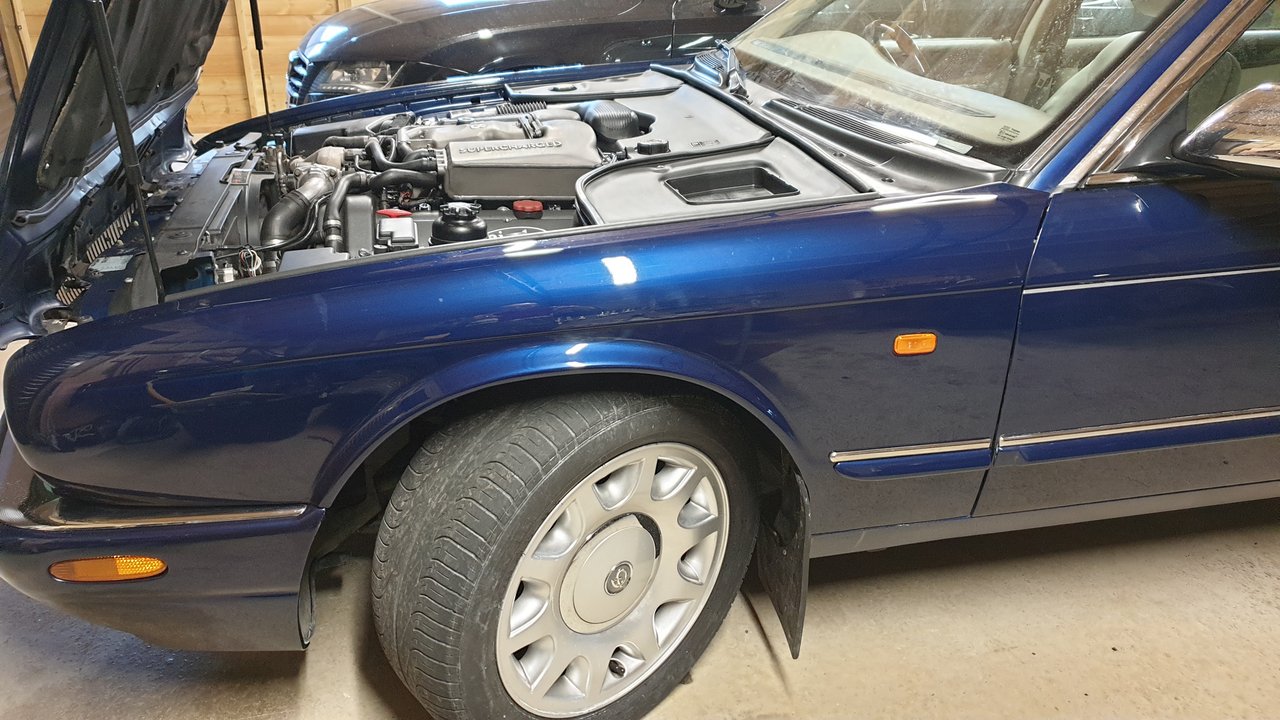

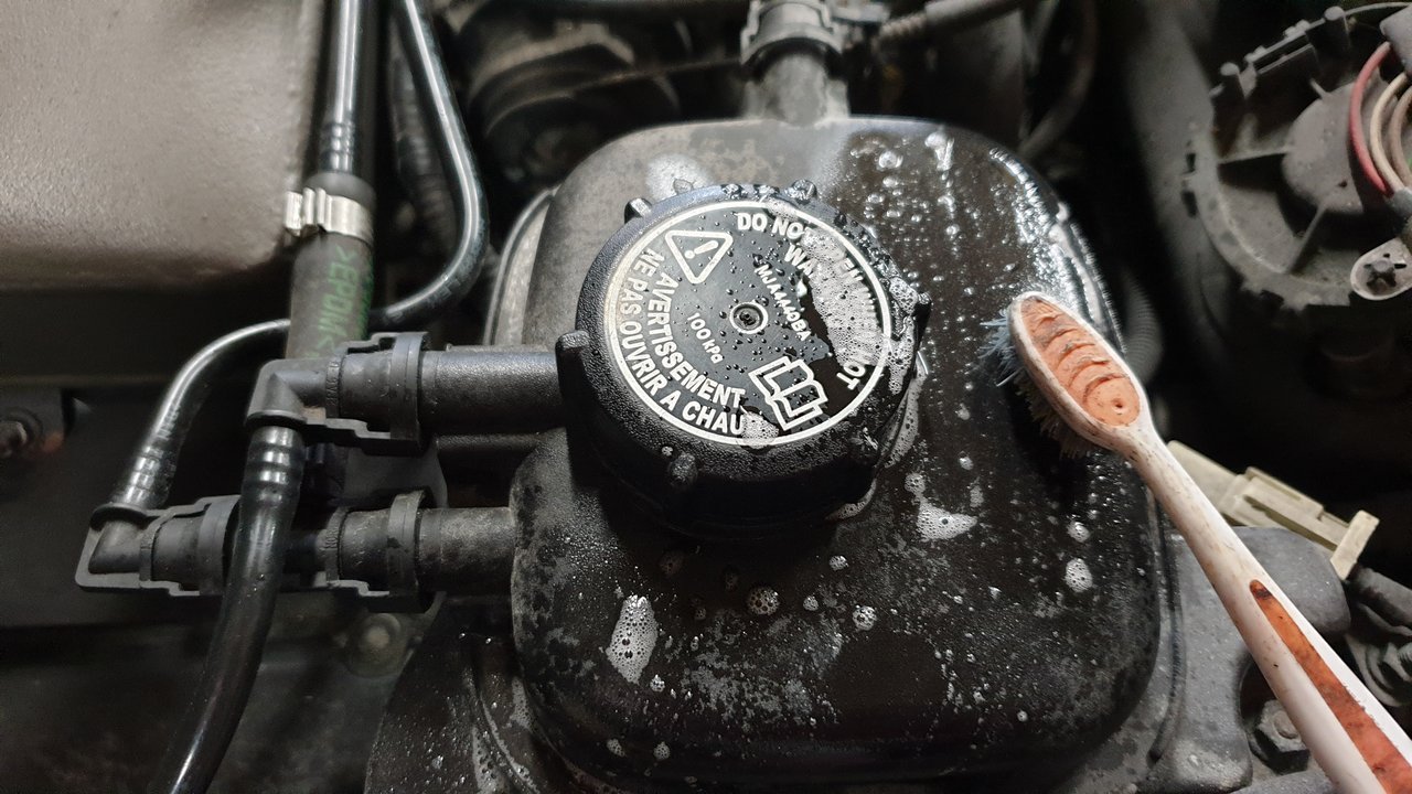

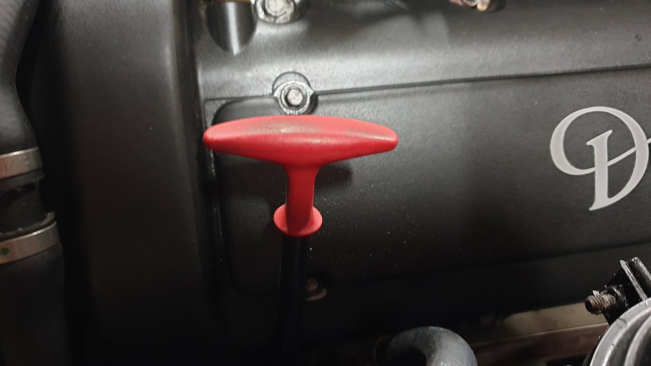

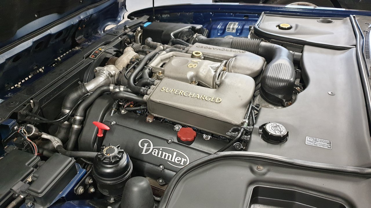

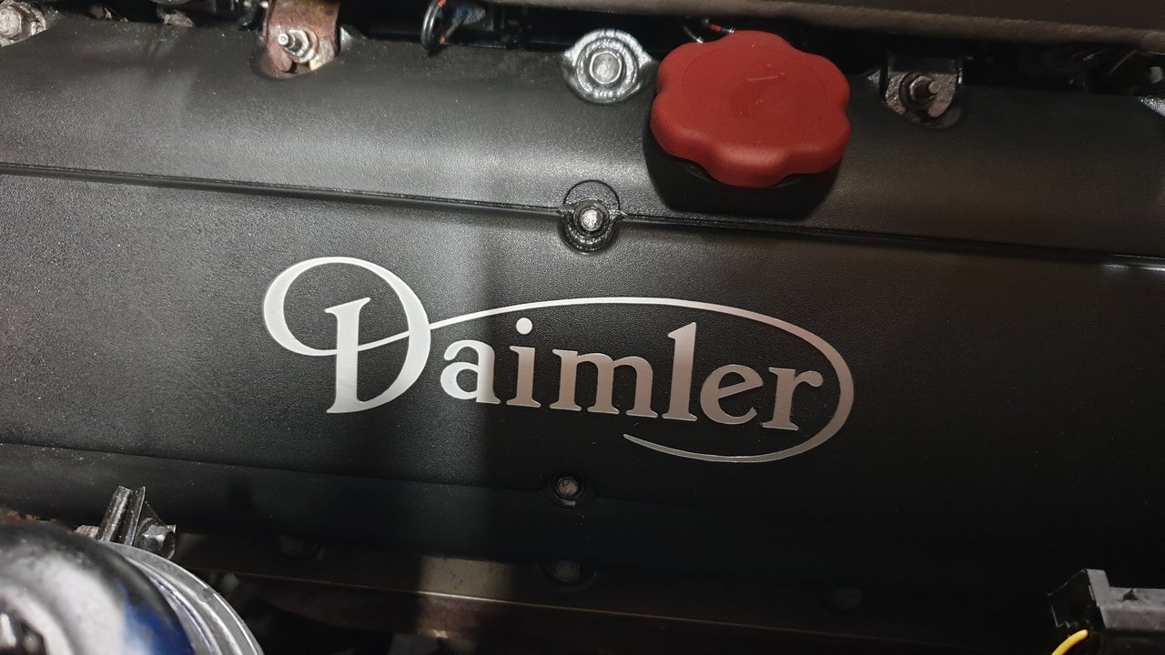

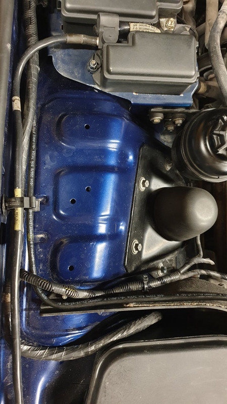

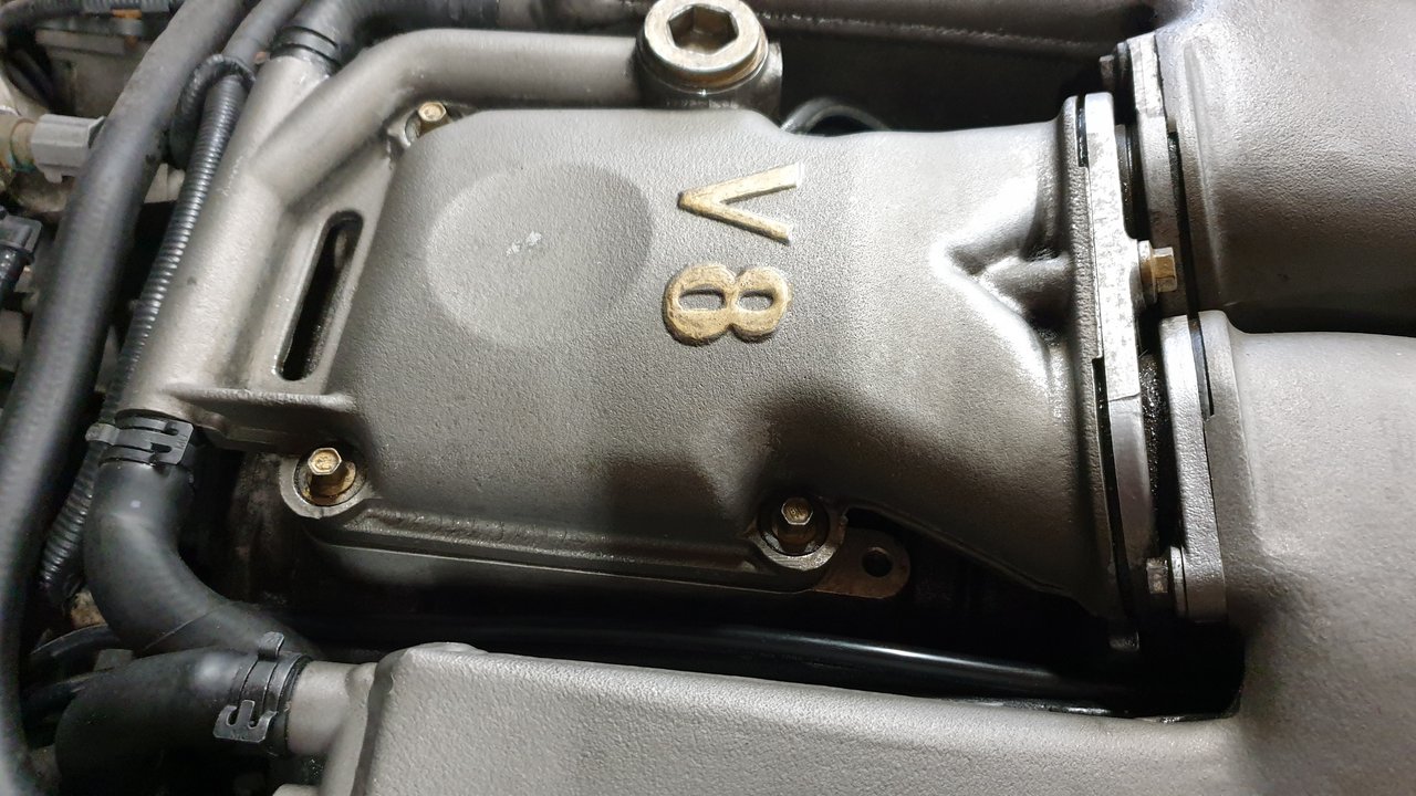

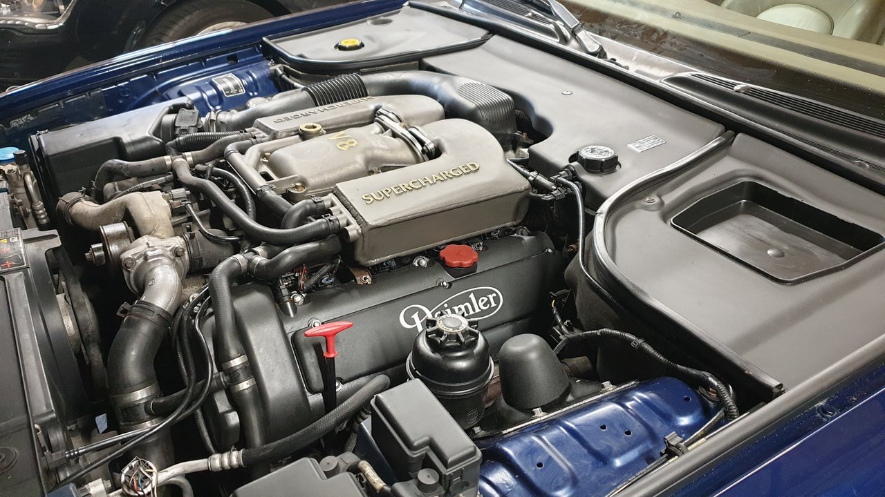

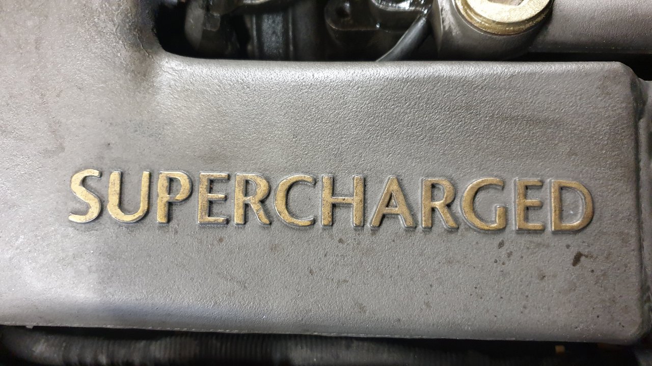

Then after two bodyshop visits, the already mucky engine bay had become embarrassing... particularly with all the dust. I gave it a light clean in some areas.
Then I decided that the DIY gold paint from a previous owner needed freshening up. I was torn between cleaning it all off or going over it. I decided to give it another go.
Before...
After...
I'm still undecided, but I will see what it looks like when I'm done.
What does everyone else think?
Still lots to clean under here, but a good start to the passenger side of the engine bay.

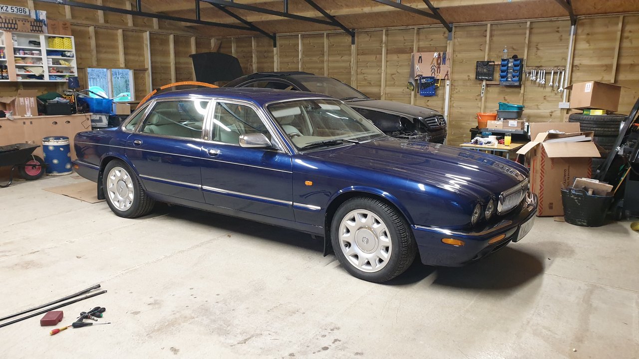

Time to have a look in the garage!

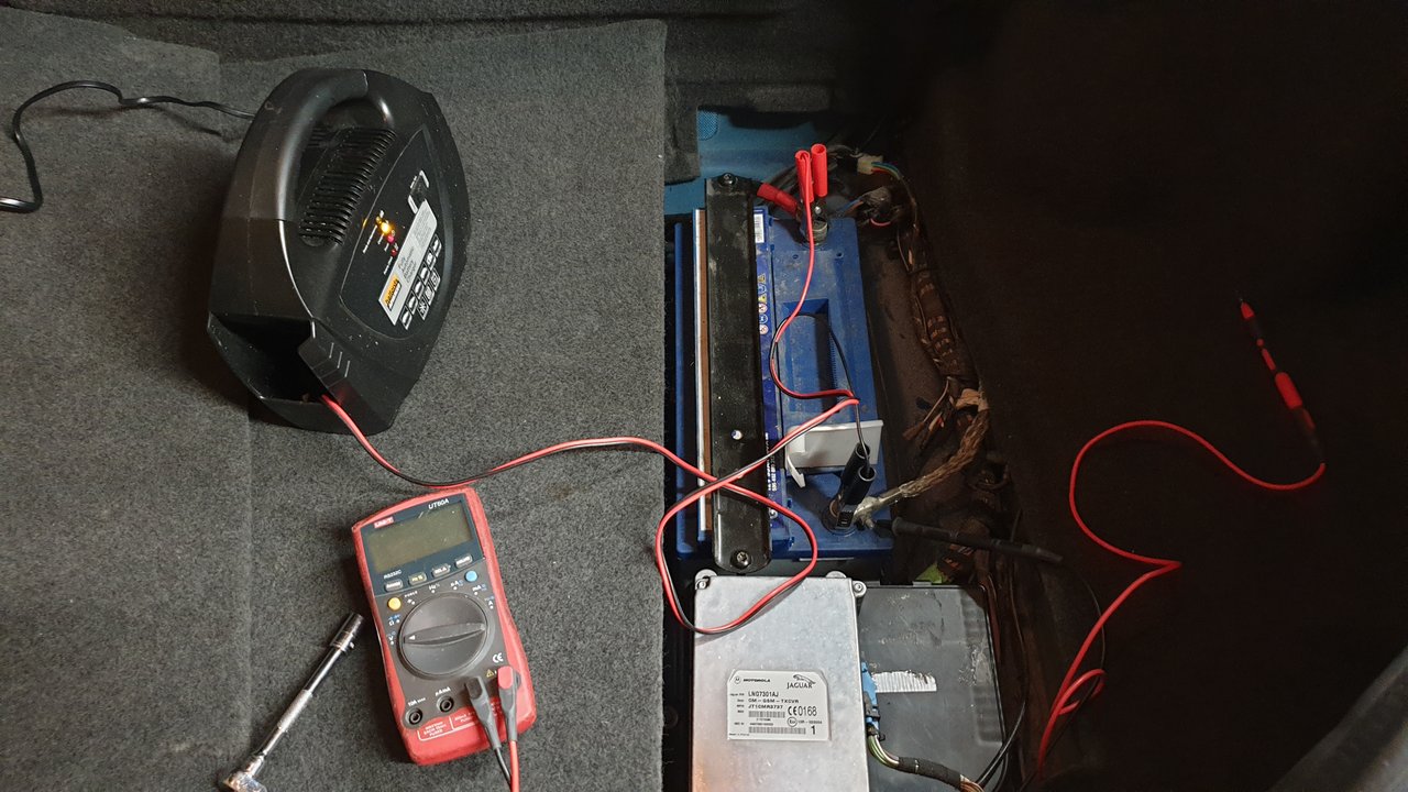

Thanks to a helpful member on this forum, I had some nice tips about things to check. But the first thing that had occured to me was that electrical problems are often due to a poor quality battery. Therefore is seemed sensible to check this out first. I could not really pull the car apart, as I had to keep an eye on sleeping Spencer, but 10 minutes could not hurt.
I put a meter on the battery, and measured a pathetic 9.4VDC! This could certainly cause issues.
So the battery is on charge, and I shall check things again tomorrow.

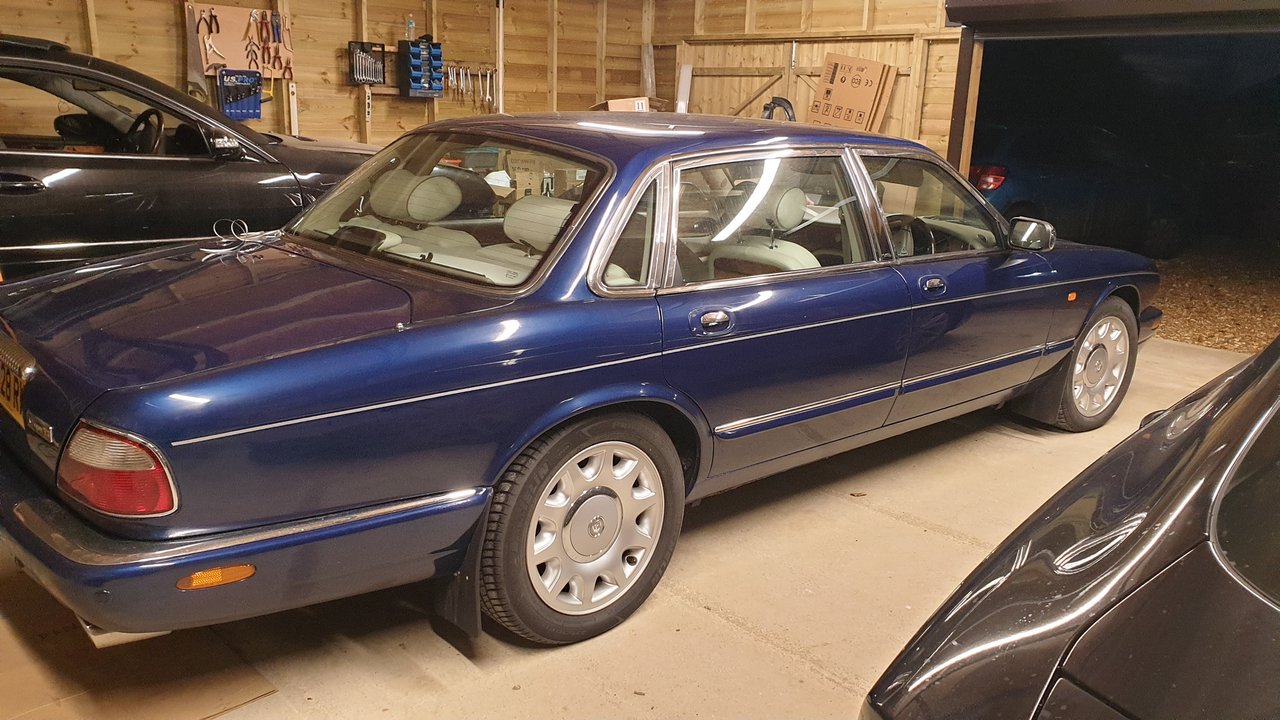

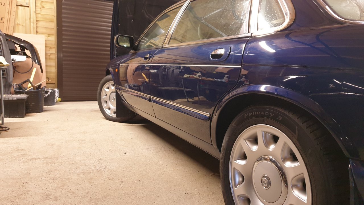

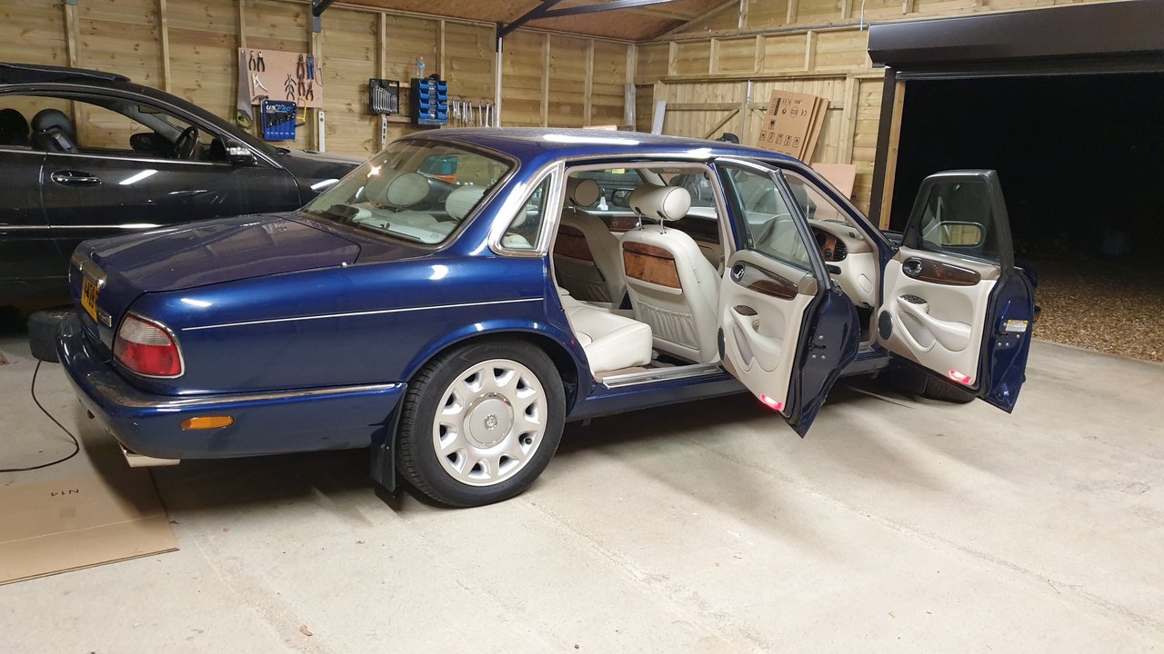

While I was in the garage I loved the way the car looked under the garage lights, so I took a few pictures.

So the pin stripe is a hand painted line unfortunately, what the paintshop could have done is give a local sign writer a call, and matching them a 1/10th litre base to add the stripe before they clear coated.
Leaves you with the other option, matching a close colour to the vinyl stripes you can buy at automotive paint supplier shops usually stock them or the usual online sites like ebay etc.
For a good result on the recharge, disconnect it and leave it for a moment then connect back up so the short term memory systems capacitor power is cleared, you start with a reset car from that point. Charging on the car doesn't give you that clean slate to figure your glitches out.
If boot doesn't come back on line...
Boot lid is a continuity check, is the V to the lights? If no, note the wiring colours and pull the right side hinge cover off to expose the loom, carpets might need to come and and split the harness wrap. locate your lights etc and check the wiring at the bend created - this is were the boot lid wiring work hardens over time and breaks, sometimes the break is obvious with wiring discolouration.

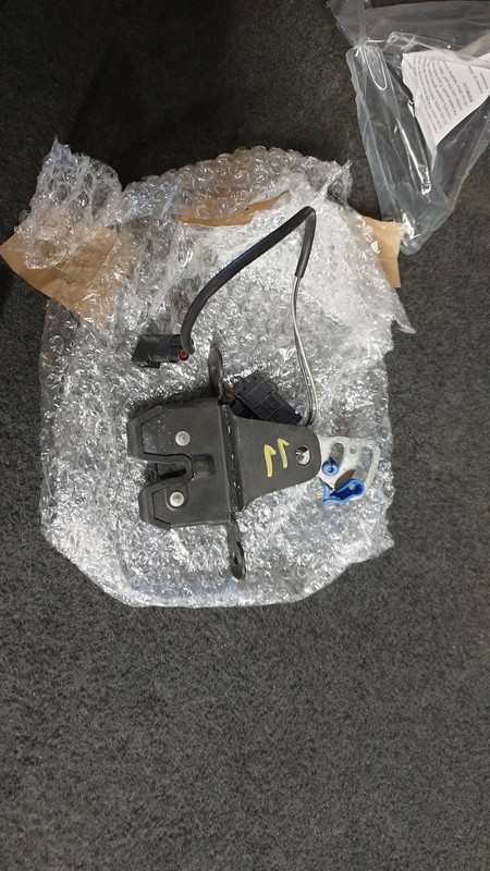

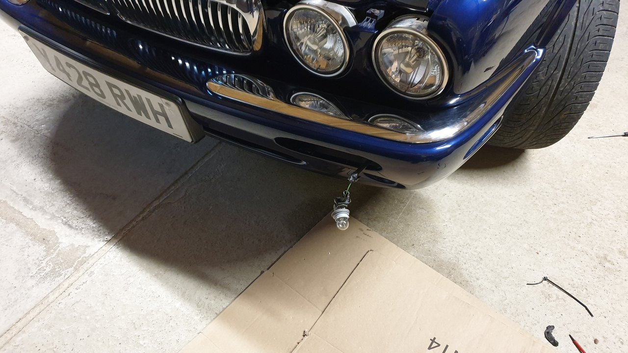

On Thursday of the week that followed (17th Nov), they gave me the diagnosis:
* The front passenger indicator not working turned out to be a connector not seated correctly. An easy fix!
* The coolant level fault turned out to be that the sensor has stopped working. At around £30ish for a sensor, I am not going to worry. Another easy fix.

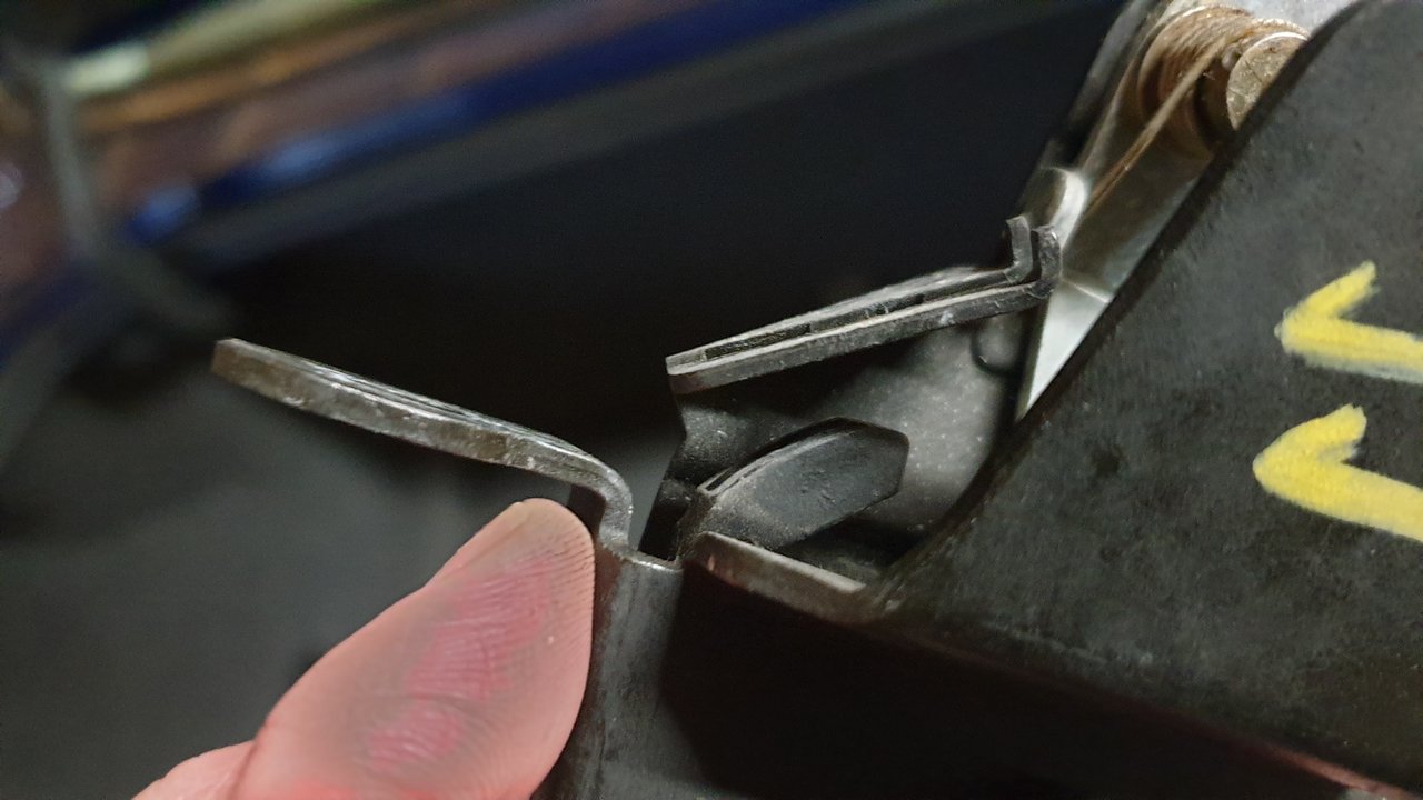

* The boot lock/opening fault issue has turned out to be a micro-switch. Jaguar no longer make the part, but I betting I can find a used one. Auto electrical are going to show me the part so I can source a used one and fit it myself.
I hoped it would not take too long; though they did say they needed to order the level sensor from Jaguar. But I did not hear anything until last Friday (25th November). I was advised that not only was the level sensor in the tank goosed, but that there was another sensor that formed part of the tank that was also gone. So I needed a whole new tank.... This was going to be another £130.

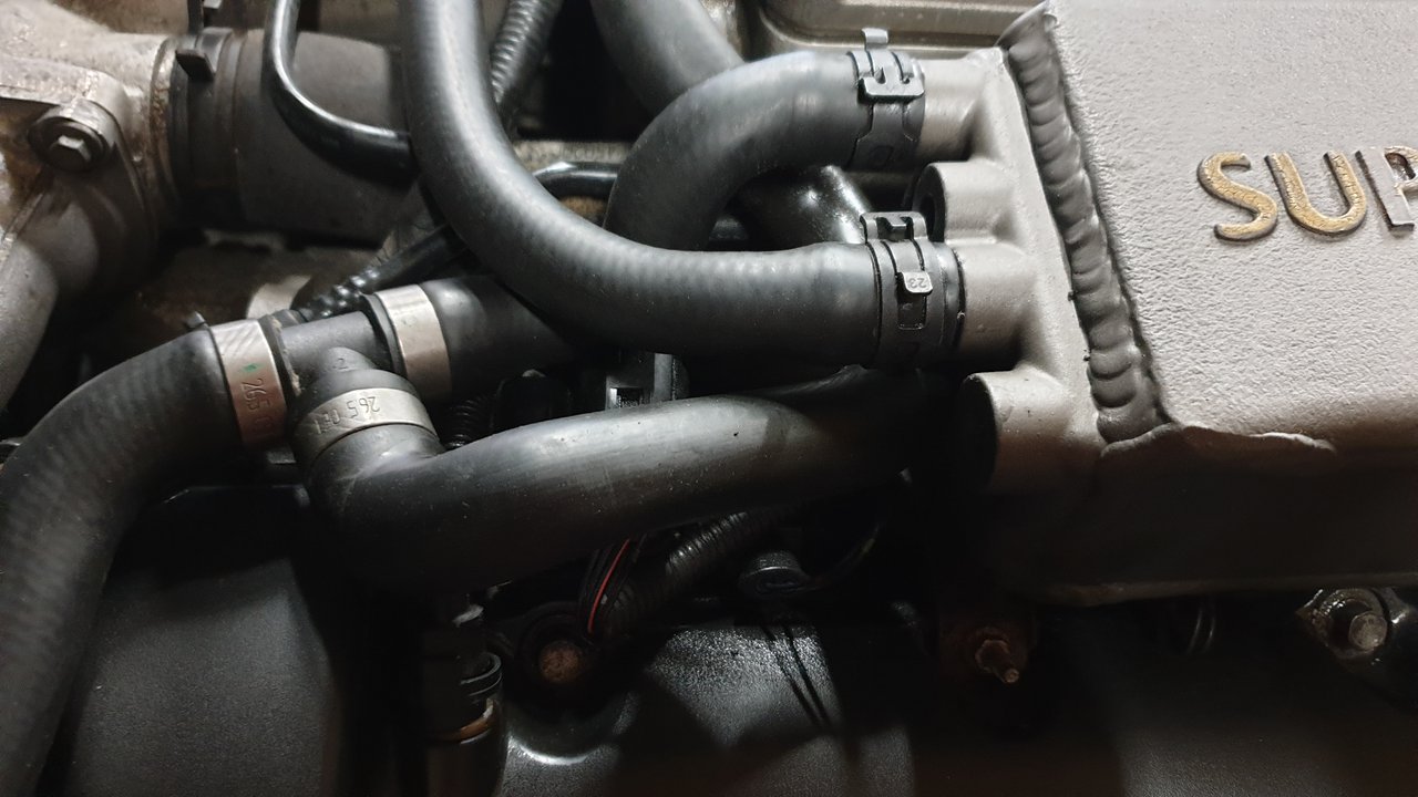

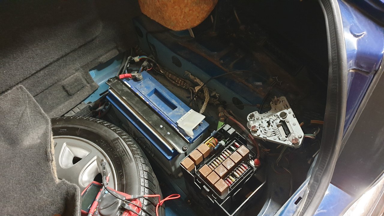

I collected the Daimler shortly afterwards. It was all fixed with the exception of the boot lock, but I had ordered the replacement part having been shown what it was by the garage.

The garage had unplugged the "boot open" microswitch and its a surprise to see it not only clears the error, but also works perfectly too, so it seems the switch has no purpose other than to let you know if the boot is not closed properly.
I decided I'd replace that when it arrived in the post.

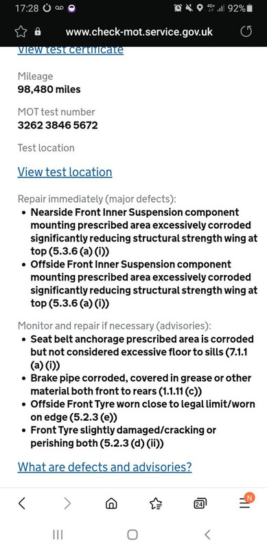

The Daimler went in for its MOT in December, and I am please to say it passed. That night Aston had his Nativity at school, he's the sheep on the left with the black ears and black gloves.
When I looked at the MOT slip, I was surprised to see that even though I had all the bodywork mentioned in both the previous fail, and advisories, it now has ANOTHER bodywork advisory. They have noted both floor pans are rusty. The brake pipes also need doing, but I can get that booked in easy enough.
Frustrating because I wanted it sorted and so there was nothing else to do, and I told the body shop if anything needed doing let me know (after all it is surely cheaper to do it all at once). When I collected it they said the car was now really solid now and I'd not have to worry for years. It seems our MOT centre disagree

The following weekend, I got some time on the Daimler as Lindsey popped out for a couple of hours with the boys for hair cuts (those who have seen me know I have no need for hair cuts myself...).
First of all, I sorted the boot lock.
It was very cold, I was praising my lovely garage! Got myself a cold drink to keep me hydrated, but also a nice hot cup of tea.
The used replacement part had arrived from Ebay. Jaguar do not make the part anymore.
The electrical specialist had told me the microswitch was not working. But when I used my electrical multimeter to check it, all seemed fine. But then I compared the new/old boot latches and noticed a striker was broken in mine. Its this grey bit sticking up in the below.
So I swapped them over, put it all back together, and had one working bootlock again! Perfect!

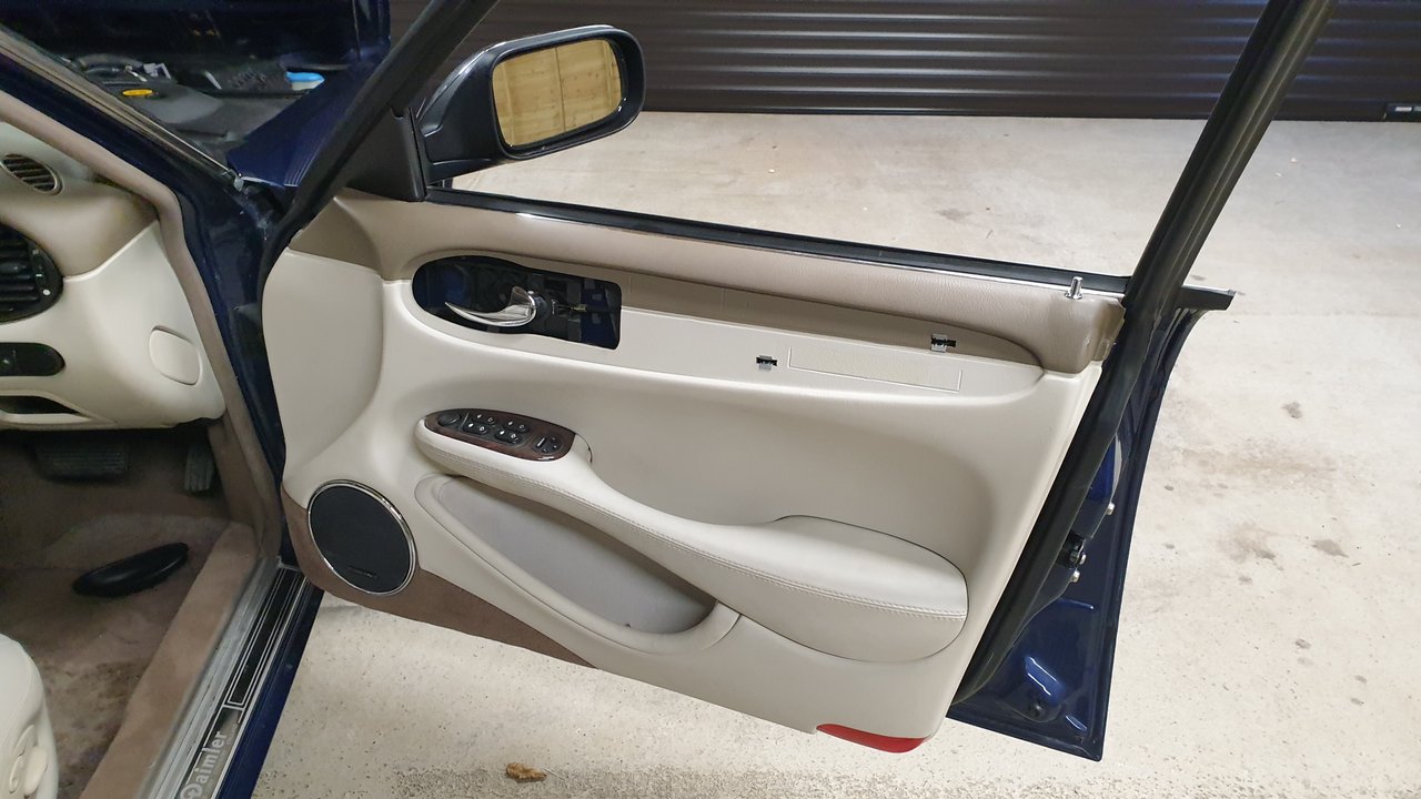

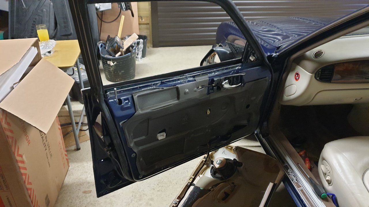

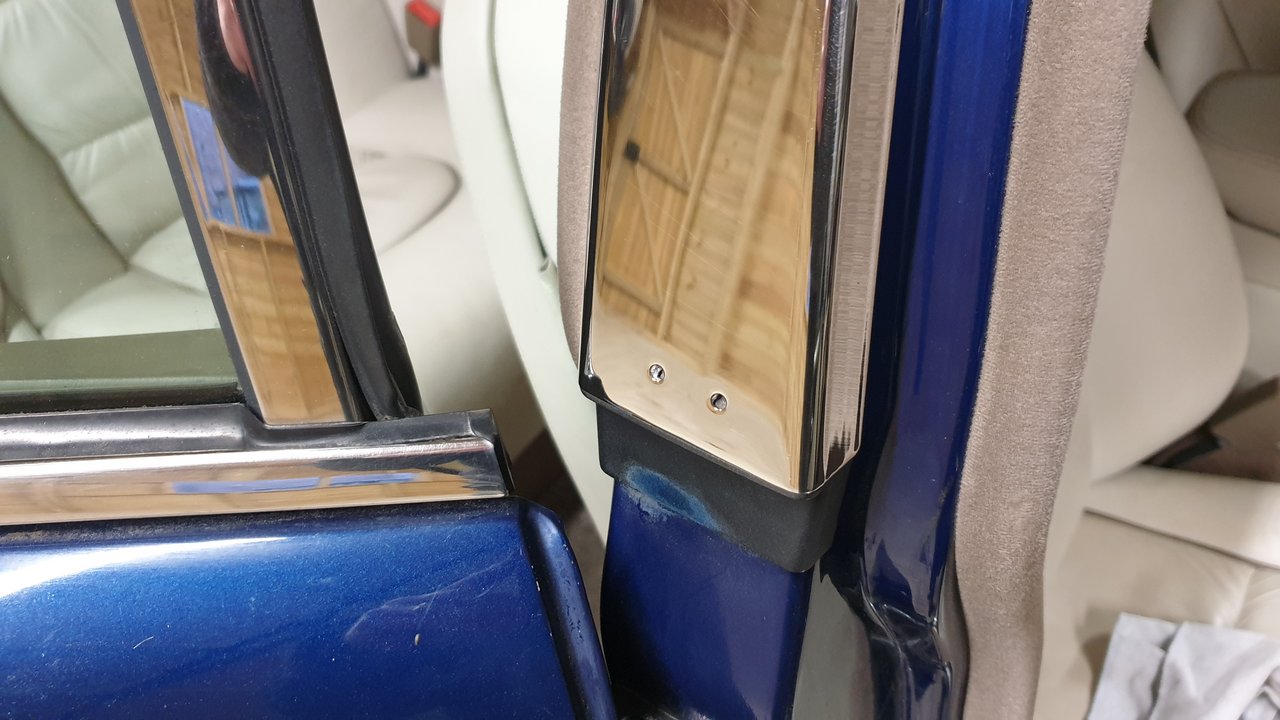

I then attended to the two front door/window chrome trims. Jaguar call this the waist trim. Mine were falling apart, particularly the drivers door one.
Need to take the door card off to do this properly without forcing or bending anything.
Then remove the mirror, and the chrome trim just pulls off.
Gave it a good clean along this top edge while it was exposed.
New trims fitted to both front doors and looking much better.
The rears are not too bad, but perhaps could do with changing one day. Thankfully they pull off easily with no need to remove anything.

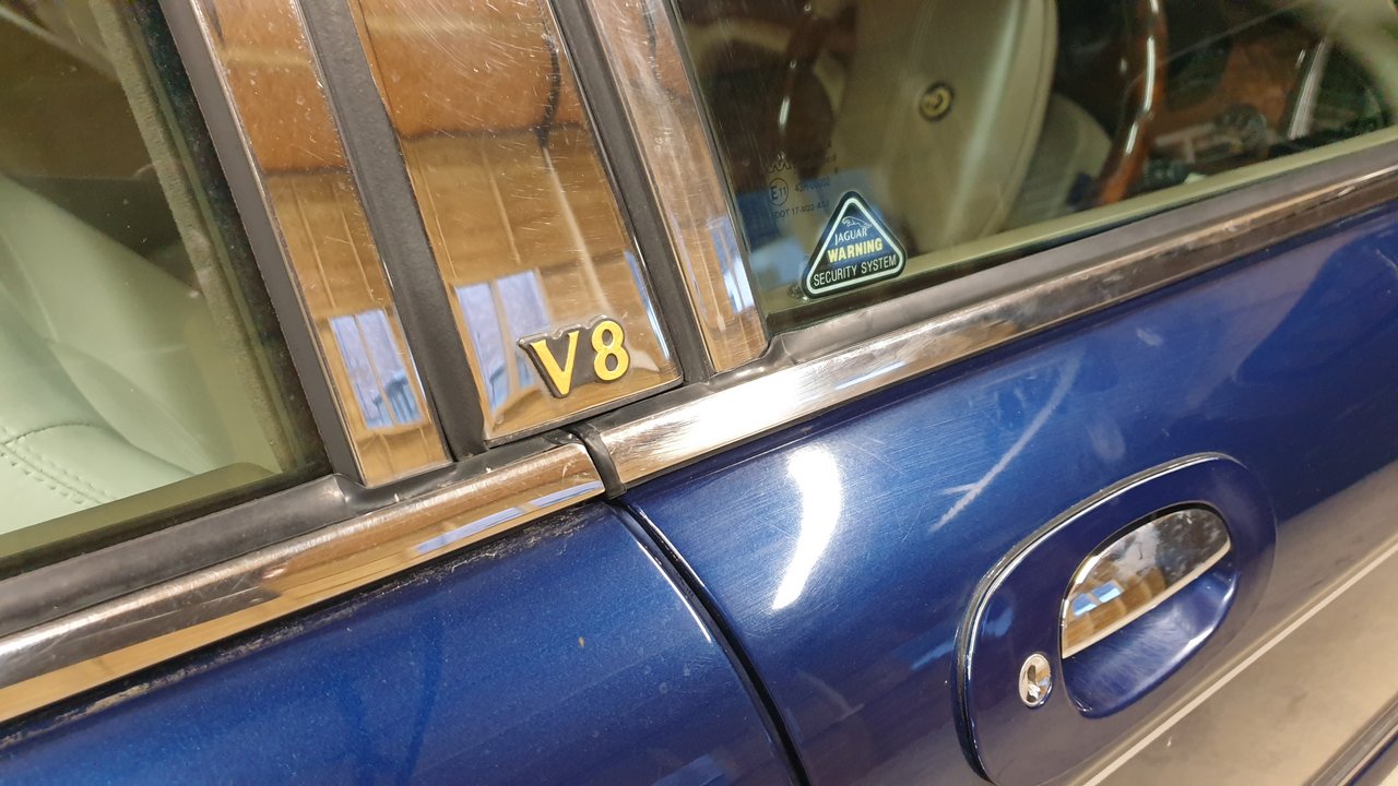

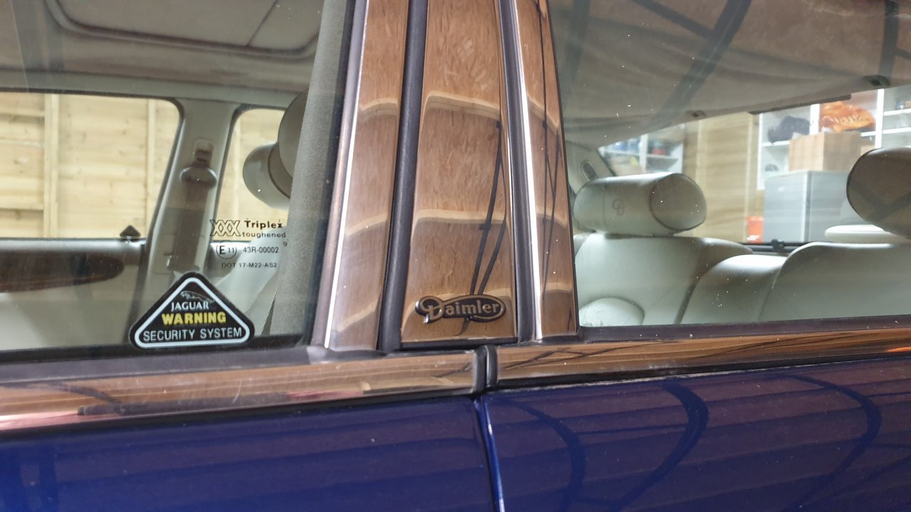

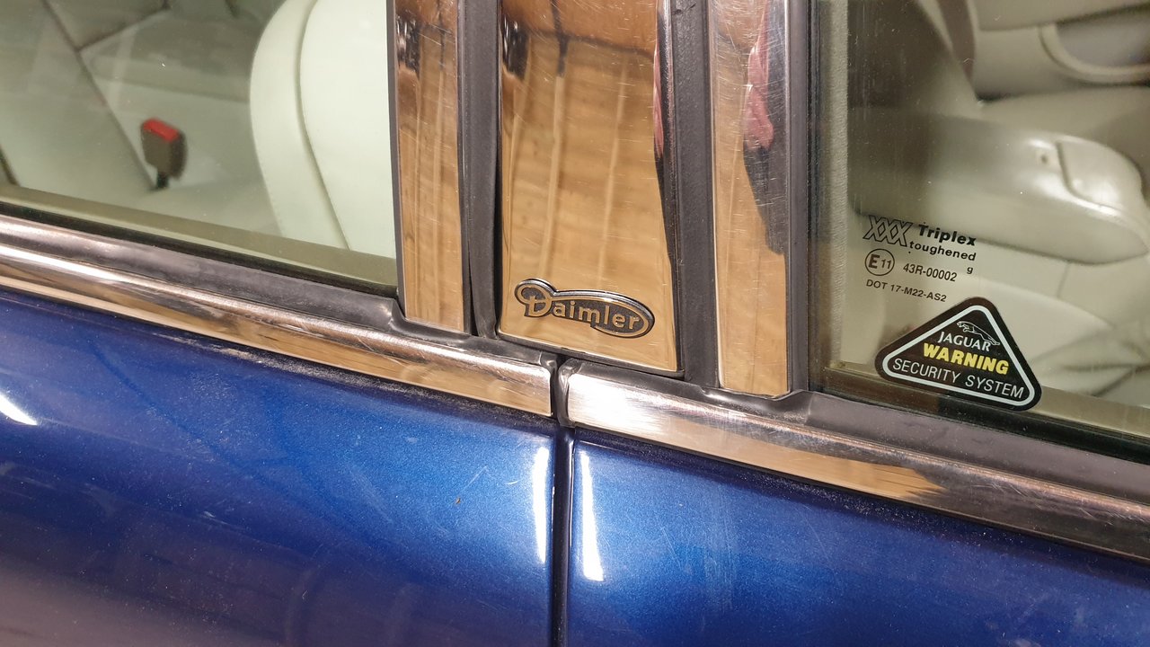

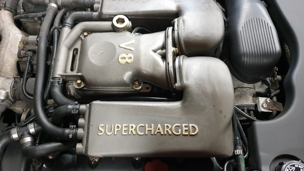

So then I turned to the pillar trim logos. On mine these are a "V8" logo. Notice mine are garishly painted bright gold by me in a cheap refirb a couple of years ago...
But early versions of the Daimler had "Daimler" logos which I prefer. To my surprise they are still available from Jaguar, so I ordered a nice brand new set.
They come with the sticky pad seal, all ready for fitting.
Bit of residue when I removed the old.
Easily cleaned up...
...and drivers side badge fitted.
Then on to the passenger side.
I prefer these Daimler ones, but I guess its personal taste. A future owner may scratch their head why this car has the older style badges fitted 🤣
Lastly I attended to the missing pinstripe on the two front wings where I'd had the spray work done.
I cleaned up the area with methylated spirits, then heated with a heat gun. Then I carefully stuck on the strips, cutting to length as I went. I stuck over the old stripes using an off the shelf 5mm vinyl silver stripe, then extended on to the front.
I know they are not the painted originals, but they will do for now and I think they look pretty good.
