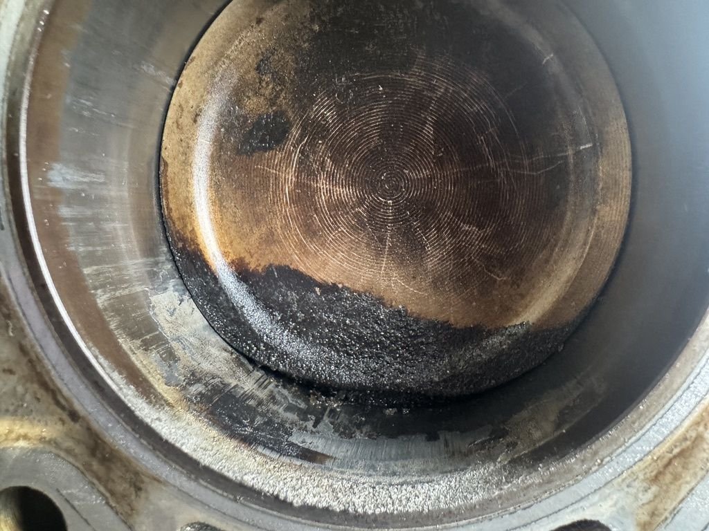

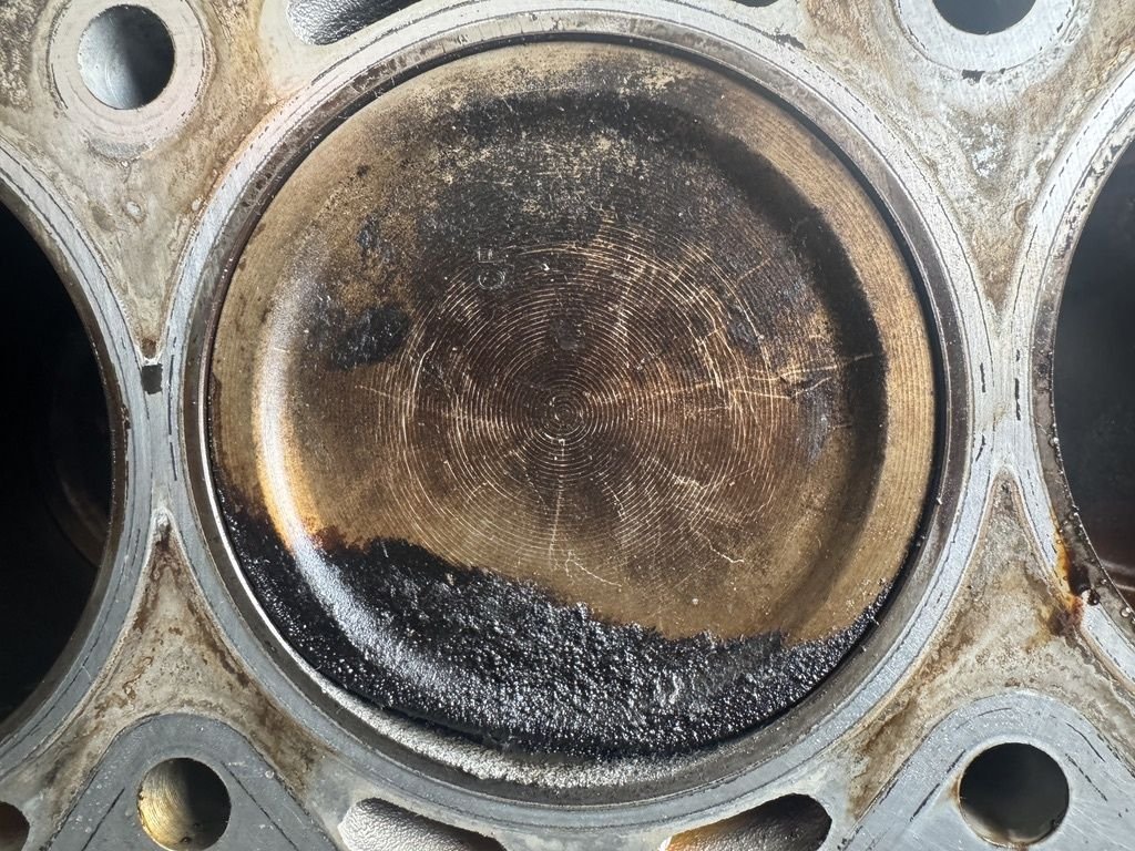

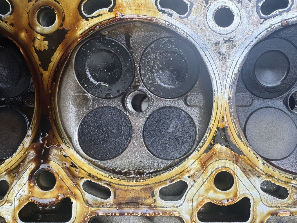

Got a lot done to the car over the last few days, and that piston and cylinder wall are hammered for sure. The MLS head gasket looked good on both sides, so nothing to concerning there.
I don't see any valve damage or piston damage. My guess here is either oil starvation, extreme lean condition, or ring failure on that cylinder. Regarding the heads, they seem to be in good shape, especially the drivers side. Not sure what the verdict is going to be on the head with the bad cylinder, but we'll have to see.
The new block should be here tomorrow, and am glad I went that route. So, everything should be off to the machine shop this week if all goes well.

Yeah that bore is not healthy at all is it.

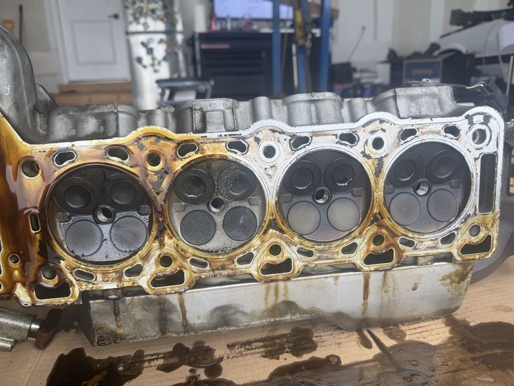

Quick update. Been receiving a ton of various parts that I've ordered and dropped the cars original Heads off at the machine shop, should have them back sometime next week. At first glance, they weren't too concerned.

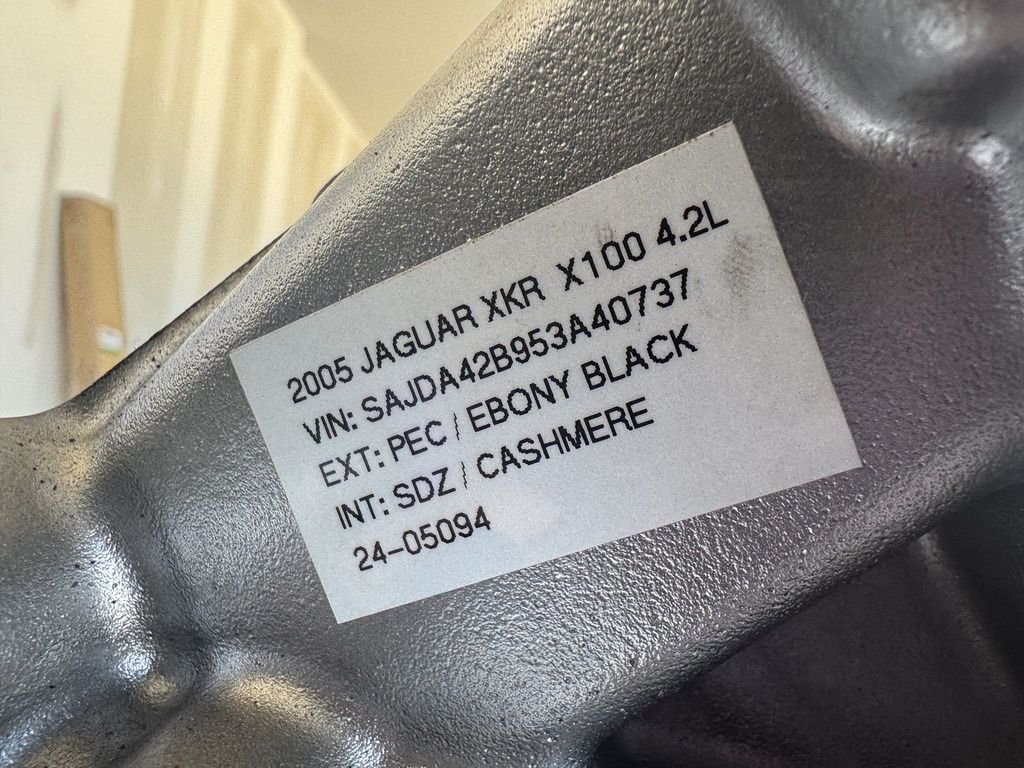

The eBay 4.2 engine block is on the stand and I'm going to work on disassembly this week. Been trying to find the mileage from the VIN (SAJDA42B953A40737), but no dice at the moment. Once the new engine is disassembled, I'll send the block out to get inspected and cleaned before reassembly.

From what it looks like it was ring failure. The original block had over 209,000 miles on it. When I pull it, I'll probably refresh it as well (as it's better to do it now while parts exist) and I'll keep it as a spare for the 2001 XJR.

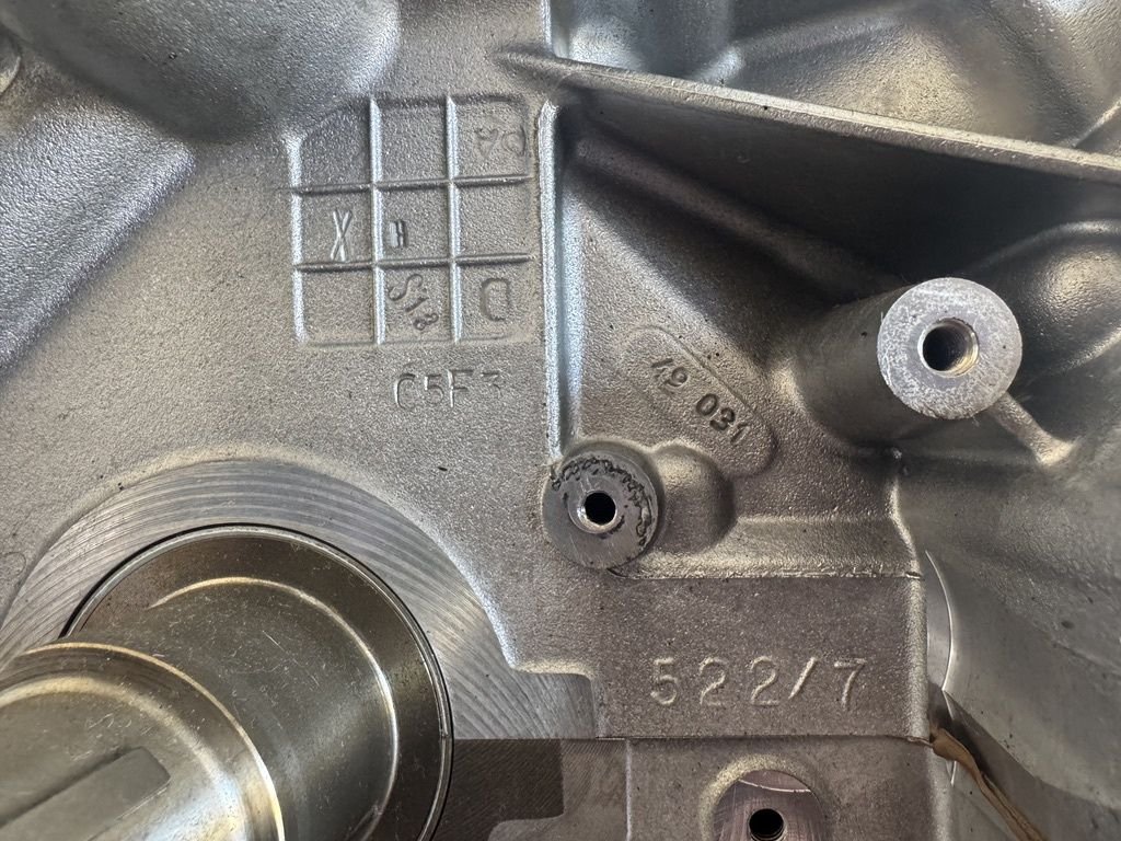

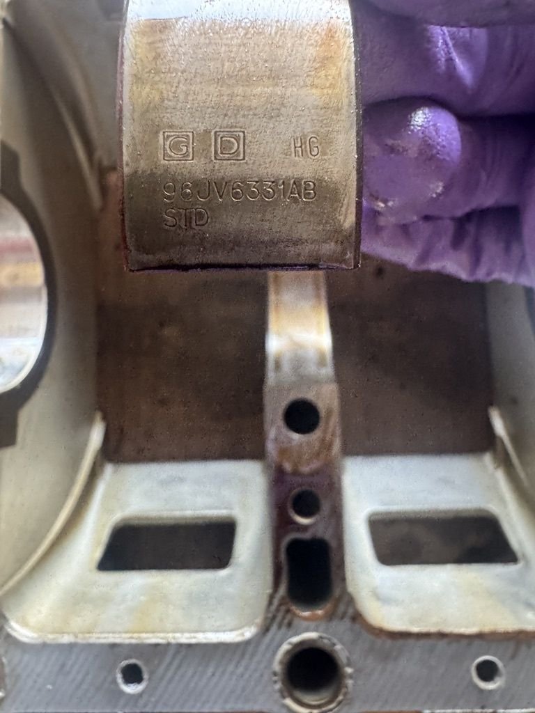

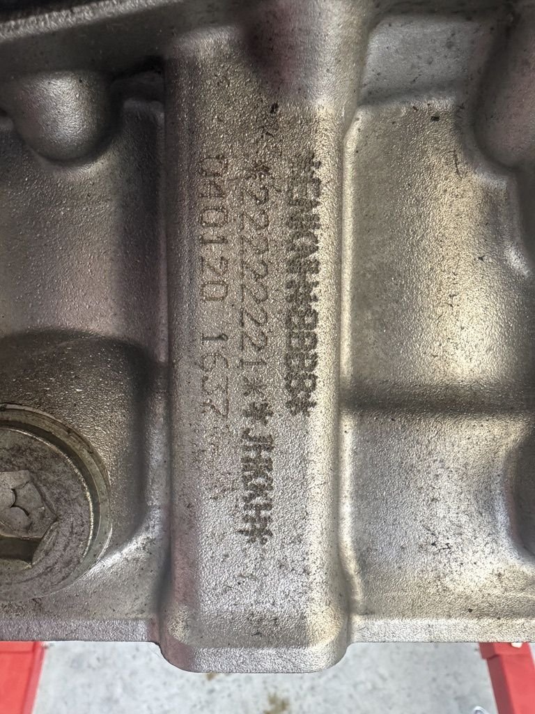

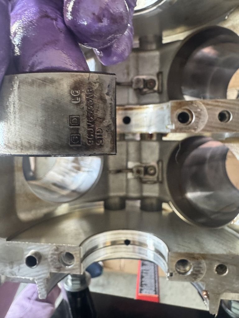

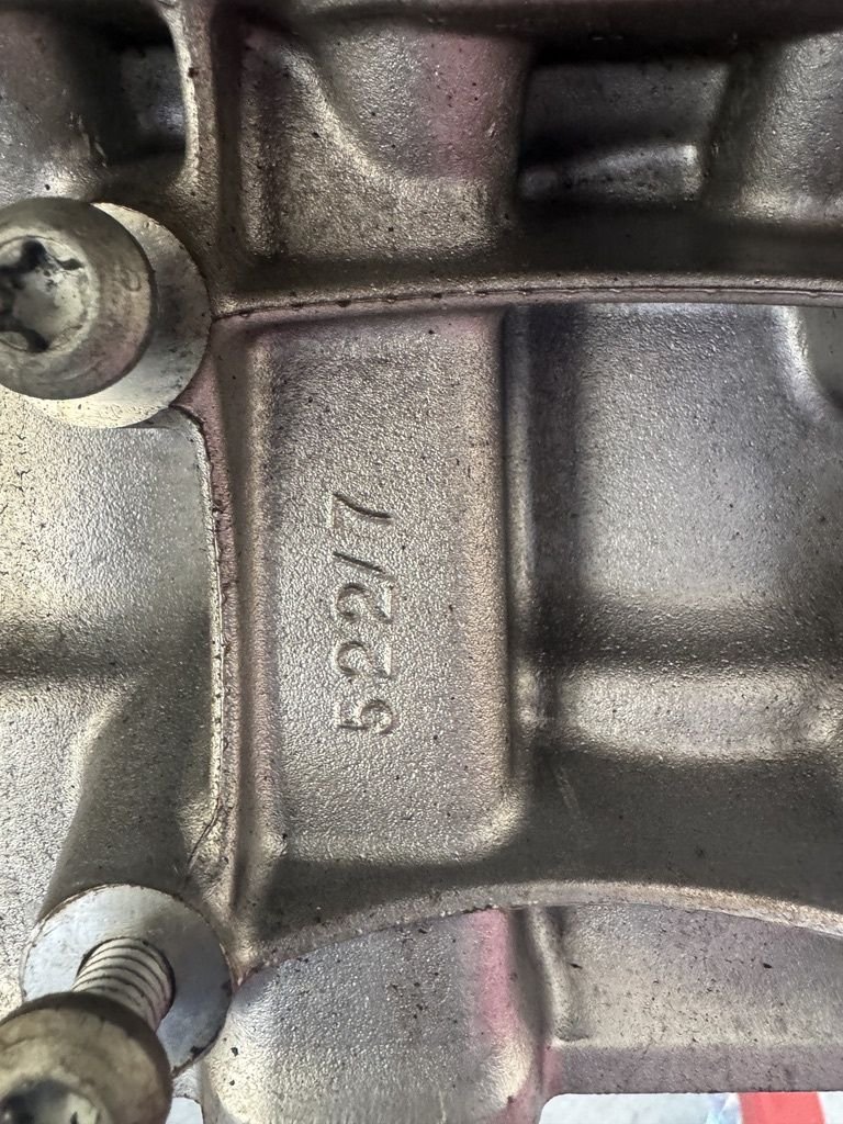

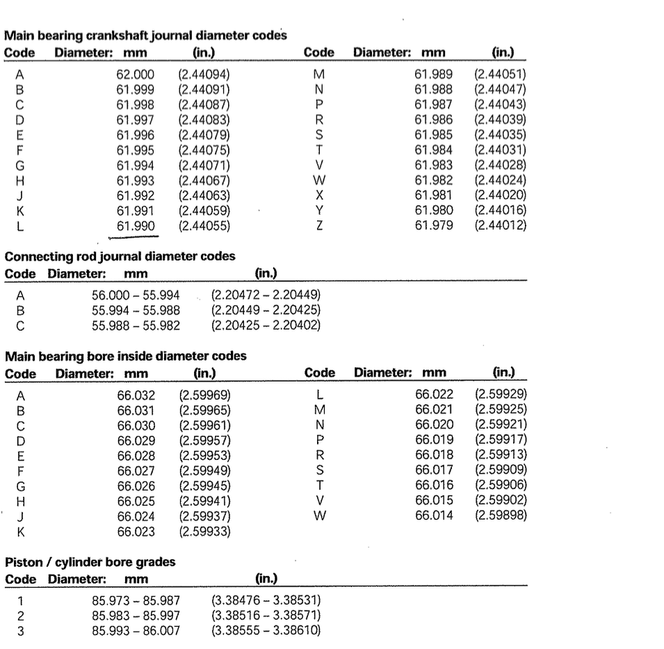

Wanted to just double check. From the "Engine Repair Course Code 168" Book, i should need the following bearing configurations:
Main Bearing Journal (Upper, Block Side):
E: 61.996 (Blue / Green) (Link)
N: 61.988 (Blue / Green) (Link)
K: 61.991 (Blue / Green) (Link)
H: 61.993 (Blue / Green) (Link)
Connecting Rod:
B: 55.994-55.988 (Green) (Link)
Main Bearing Bore (Lower, Bed Plate Side):
J: 66.024 (Blue / Green) (Link)
H: 66.025 (Blue / Green) (Link)
K: 66.023 (Blue / Green) (Link)
This seem correct? Thanks!

Looks pretty good. You will narrow it down once you get in there.
