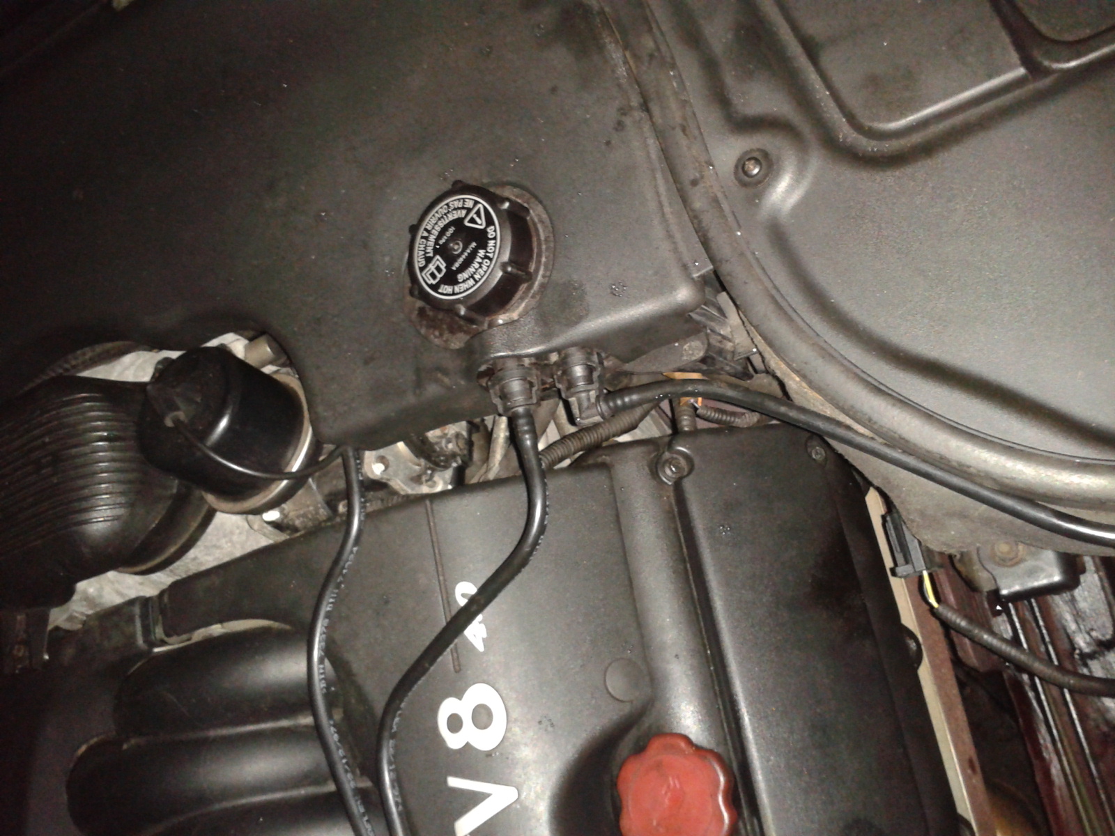

I have had it a few months and it has started happening recently , would you have an image of the pipes you mean so I could check , thanks again

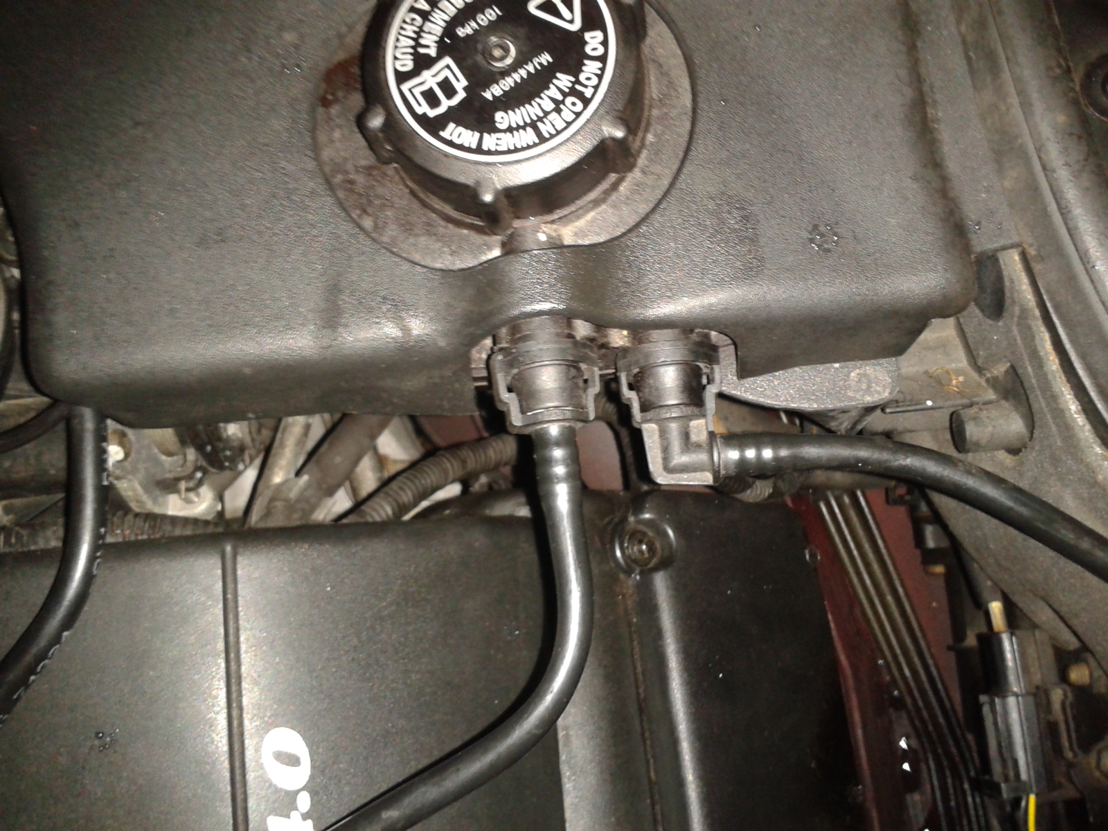

hi I have attached a couple of photos of my pipes are these correct or wrong??? Thanks

Old May 20, 2016 | 05:36 PM
harvest14's Avatar
Joined: Apr 2015
Posts: 1,386
Likes: 370
From: Virginia
They are wrong.
I bought an XJ8 a little over a year ago and noticed I had to add coolant every week or so, not a lot but still...it was losing some. The reservoir connections were put on backwards by the previous owner and I didn't know the difference. The folks on this forum informed me of the correct arrangement of those lines and after I switched them I never lost any more coolant. I have no idea where it was leaking though, I just got a "low coolant" message every week or so and topped it off.

Hi thanks for the great advice I have swapped the pipes around and so far no sign of leaking ..using the little plastic tool thingy which was attached to soime other pipe thing... Can I continue to drive the car OK for a few days until I get the correct mix of water/coolant back in at the minute it is more water than coolant because I had to top it up a bit a few times the weather is mild so no worries about freezing but I don't want to damage anything??? Thanks again for the advice
