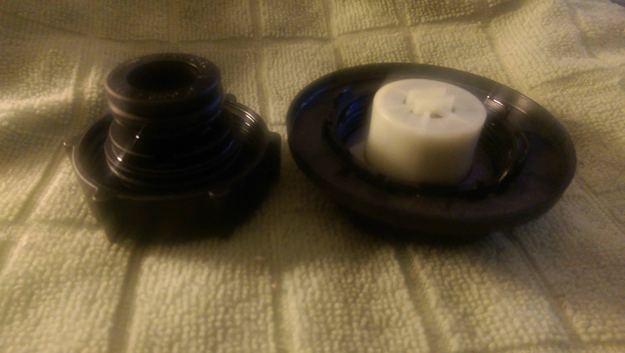

The 10238 does look different in person and the neck is not as long. I think it did have the O ring though and screwed right in nice and tight. As Im sure you saw, Amazon says it fits the car. Other vendors seem to be split 50/50 over if its the right cap or not
The one on the left is my old OEM cap, the one on the right is the replacement. Would you be worried that although the new one fits nice and tight, the neck on the OEM one is a bit longer? I doubt the new one would have me running unpressurized, as it is still afterall a radiator cap rated at 16psi and fits on to the reservoir tank perfectly. Do you guys think I should be worried about the new one even though Amazon says its a fit? Next to each other perfectly side by side, the new one is MAYBE 1/4 inch shorter.
I think I answered my own question. Started her up and let her run for about 10 minutes and coolant started to seep out, so I wouldnt recommend buying the 10238. Hope this helps someone as Amazon has this listed incorrectly
