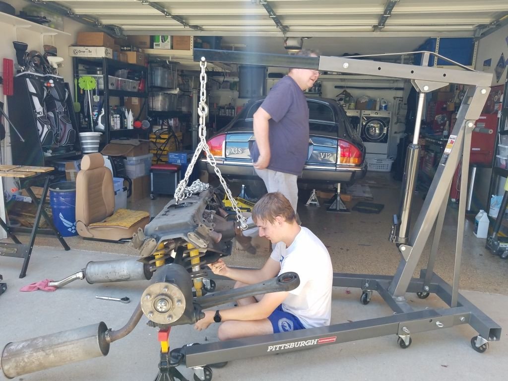

FWIW I removed the IRS to re-seal the differential and install a rear anti-roll bar. (Great mod BTW.) I don't have a lift.
I took the IRS off with the rear part of the exhaust pipe still 'entangled' and lifted the IRS high on a engine hoist.
Removal and subsequent refit (of the stock exhaust system) was reasonably easy.
HTH, Dave

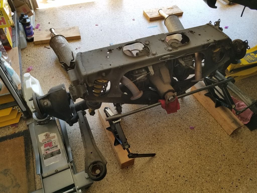

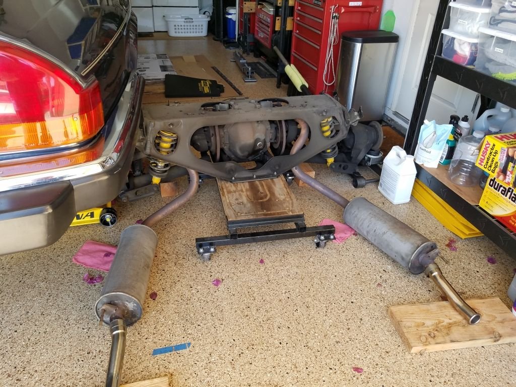

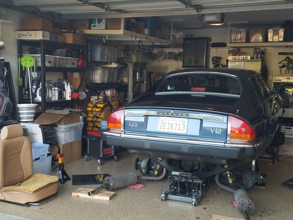

Pictures below show how my stock exhaust was routed when I removed the IRS. I put it back the same way. I believe it is correct, and have no reason to believe it had ever been removed since the car was new.
Picture shows the assembly with exhausts being transferred from ATV jack to custom dolly, and should give a good idea how the exhaust was threaded through the cage.
HTH, Dave

Originally Posted by Patrick 1989 XJS
Isn’t the pipe supposed to go thru the back side of the cage not under the cage?
No. I made the same mistake when I rebuilt my IRS, and wasted lots of time. Eventually, I reviewed all the "before" pictures I took before I lowered the IRS, and saw that only the front ends route through the holes in the cage, and the rear ends route under the cage.
