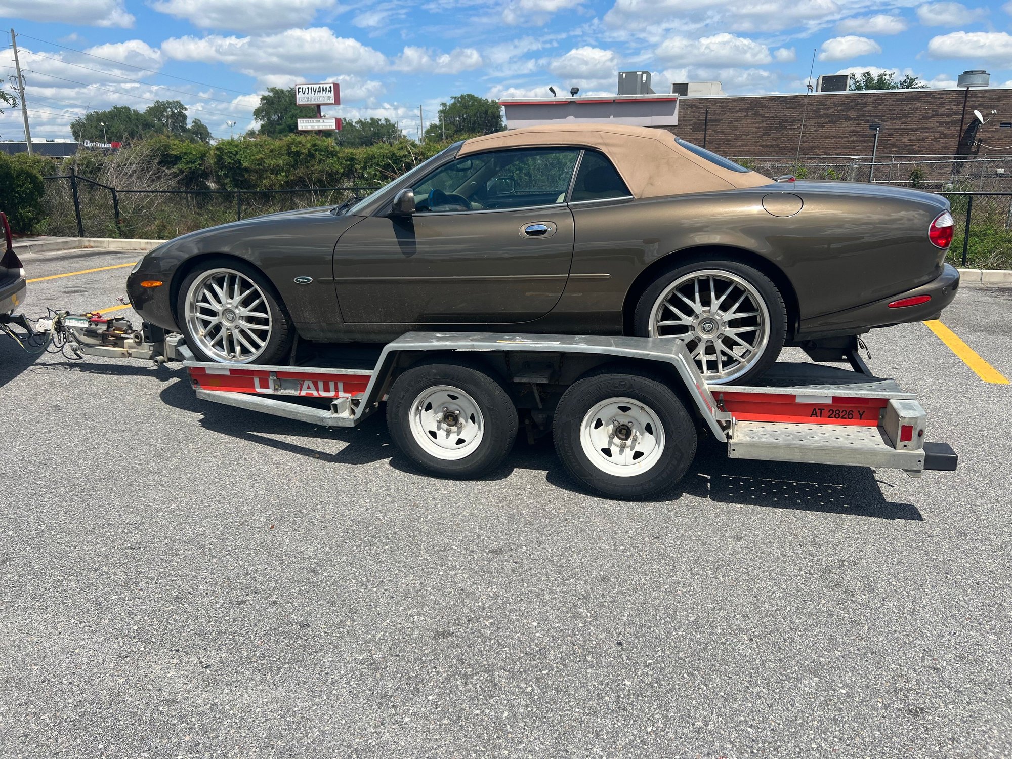

$1000 2001 with blown engine

Is that Roman Bronze? Only available for MY2001, AFAIK.
I guess another tensioner victim? Such a shame. What are your plans?
Yes. Never saw before.
Guy said was reving and locked up. He wasn’t much of an engine expert.
Not sure. Maybe LS swap, if so manual. Maybe just used engine. Is there any manual you can connect to a AJ27 that’s not $$$?

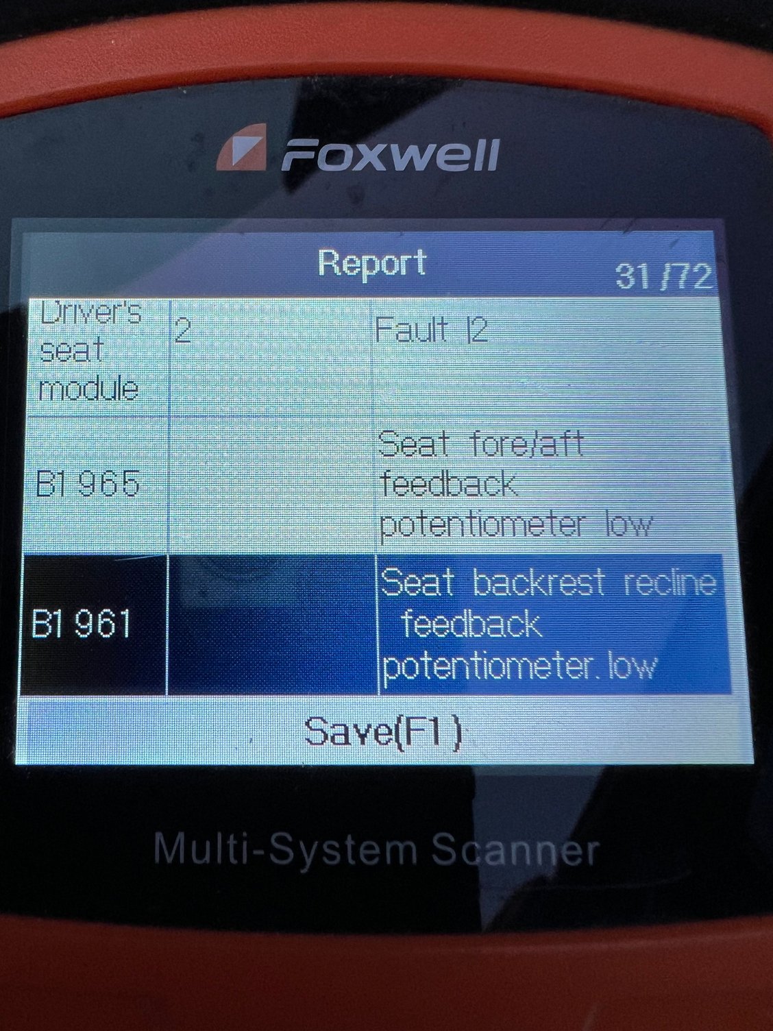

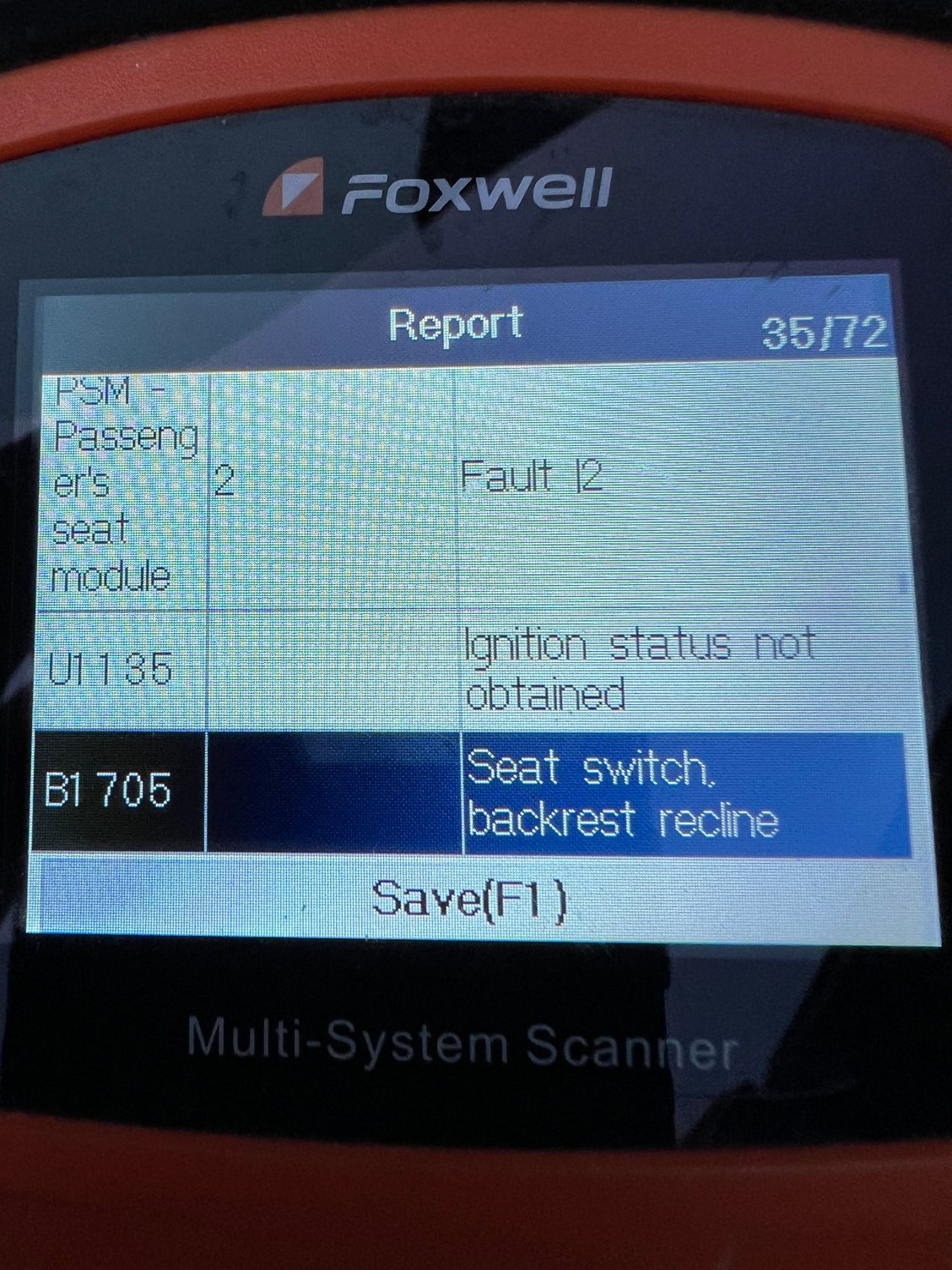

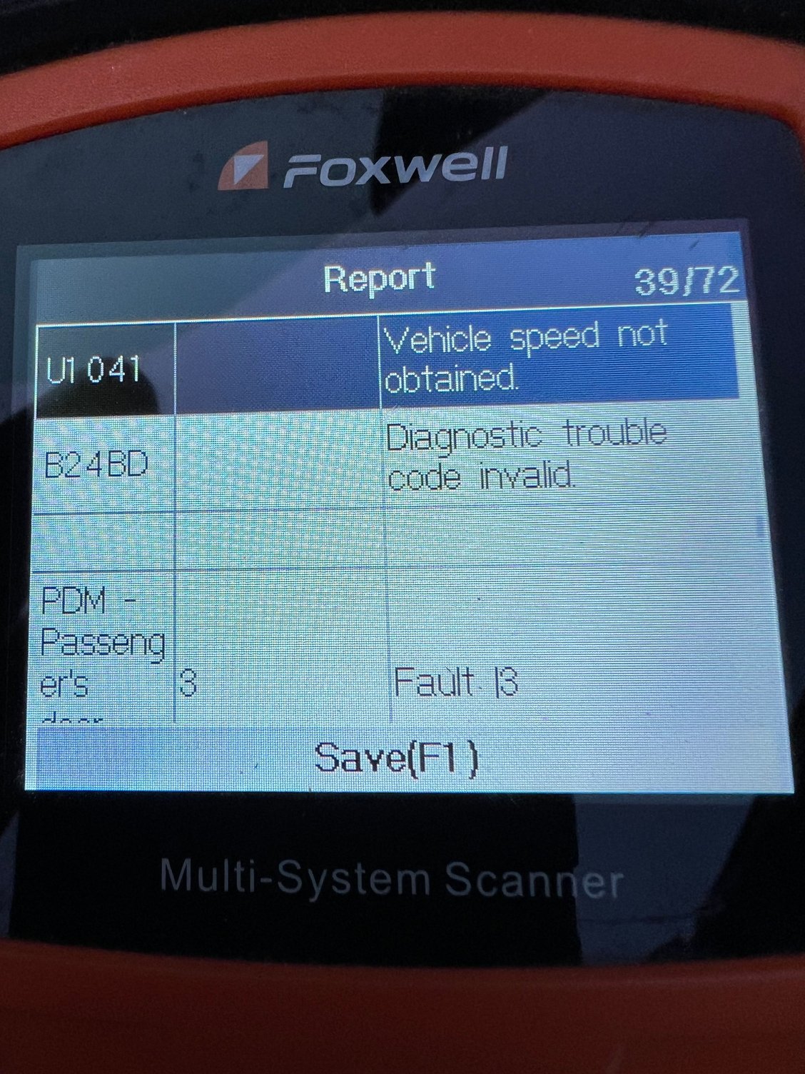

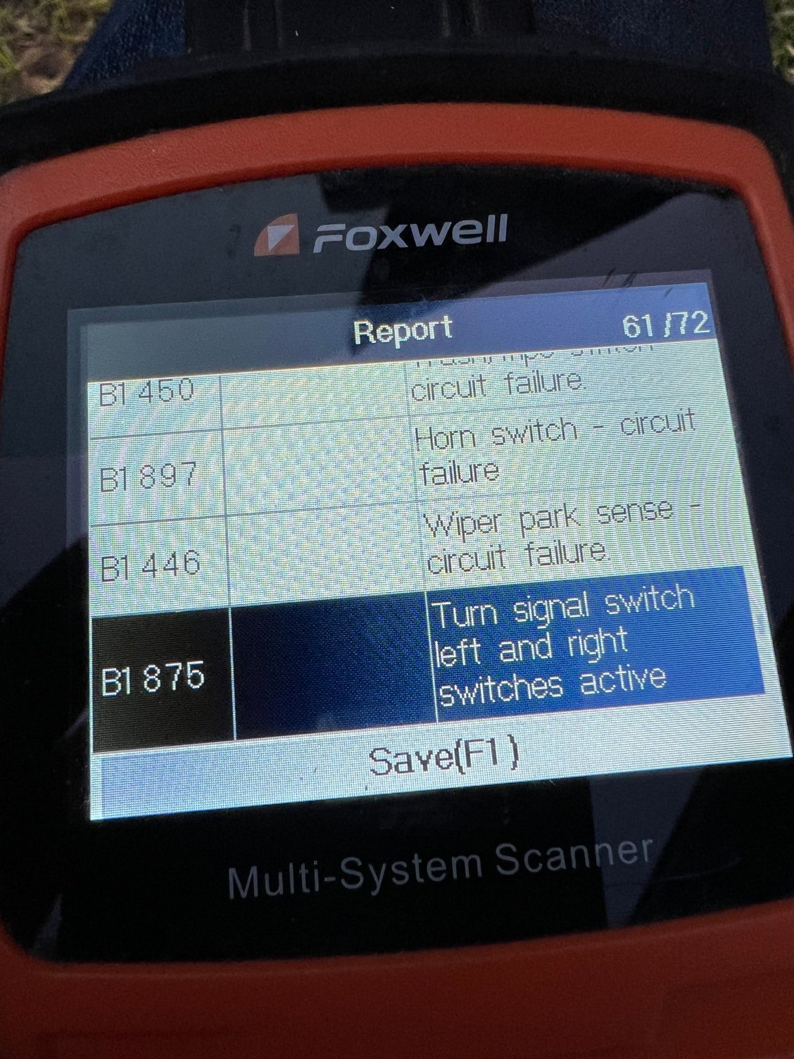

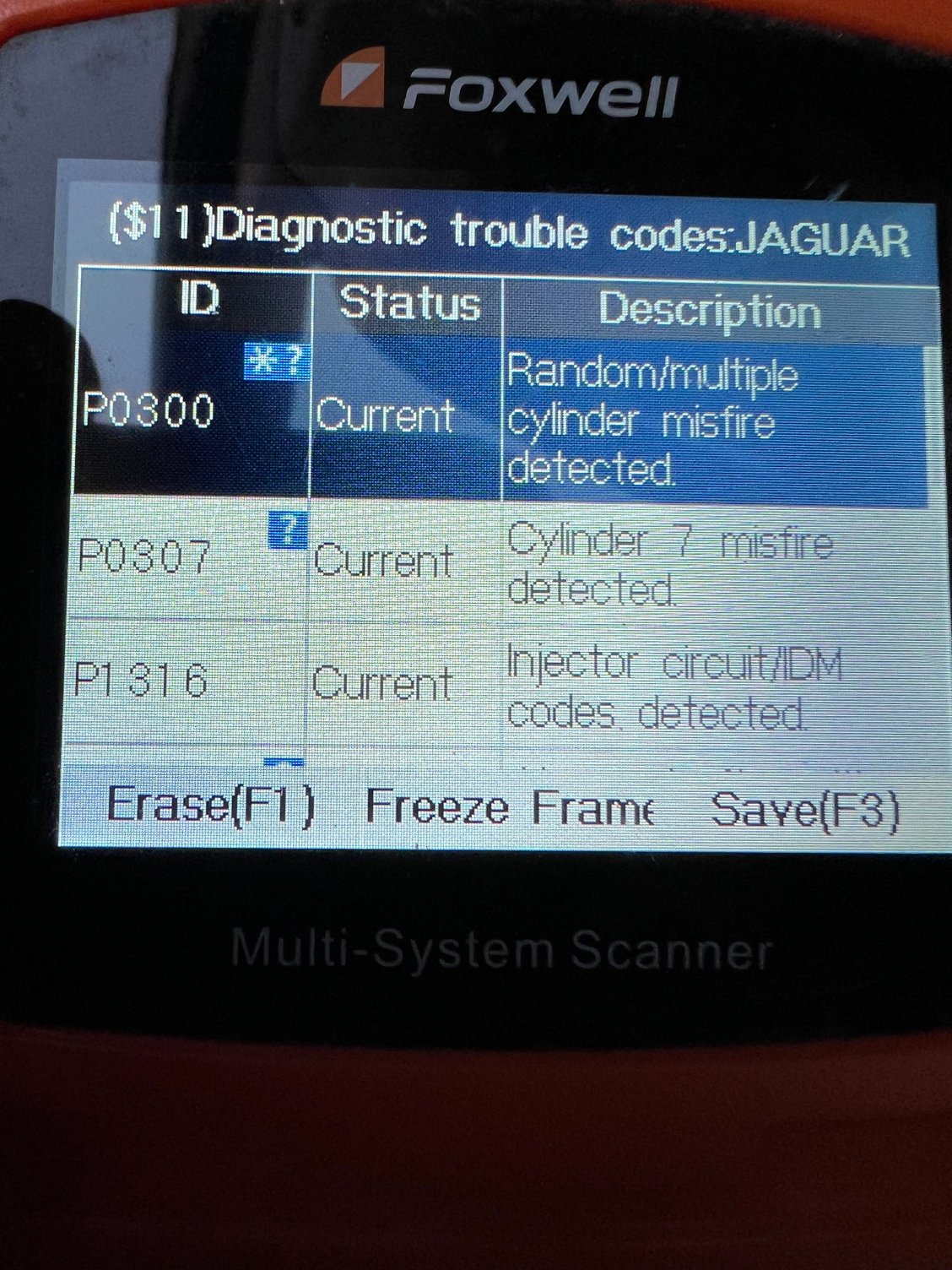

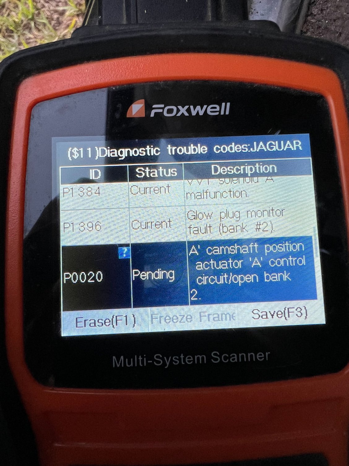

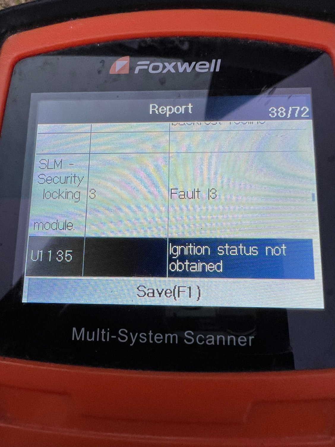

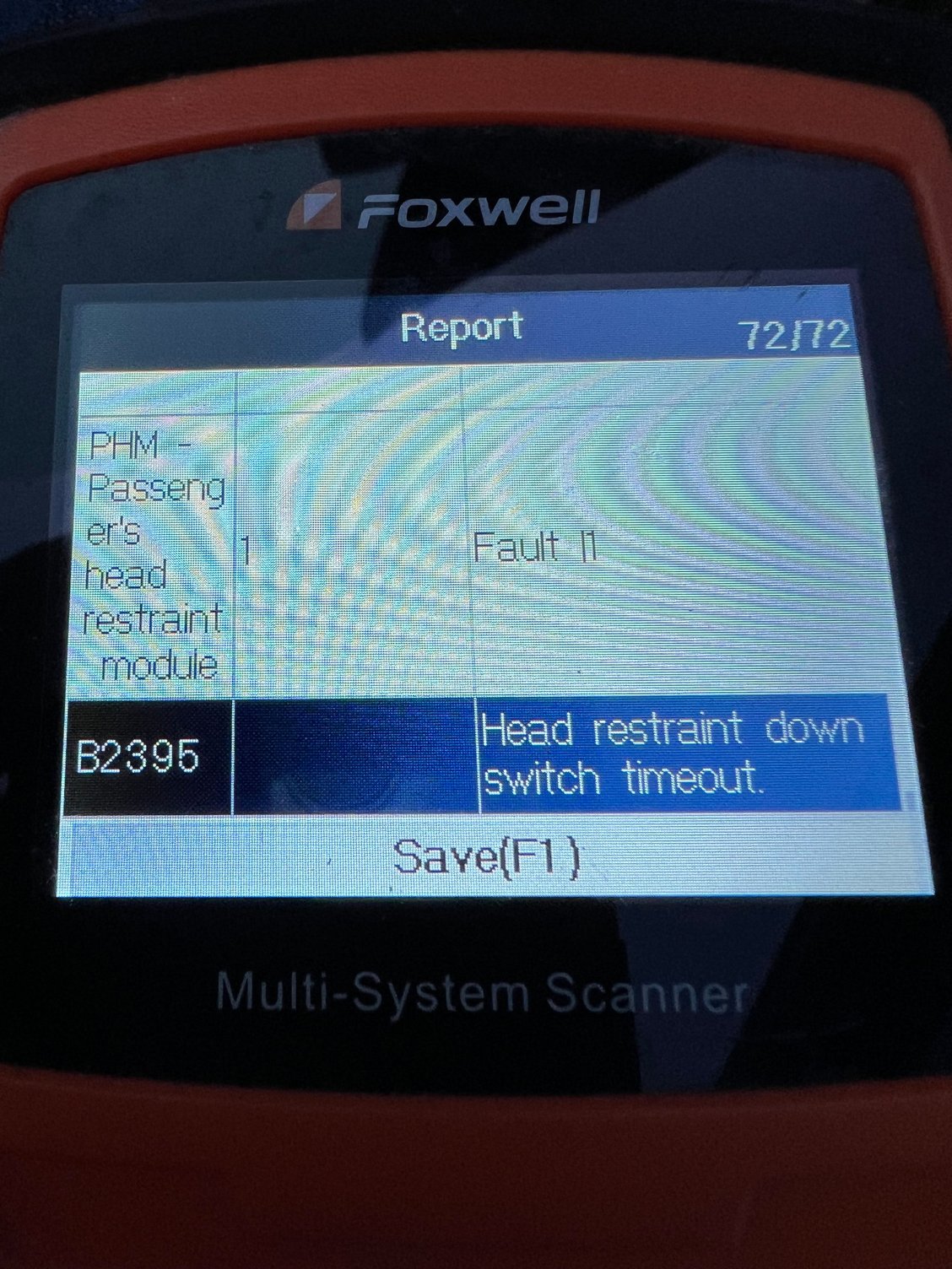

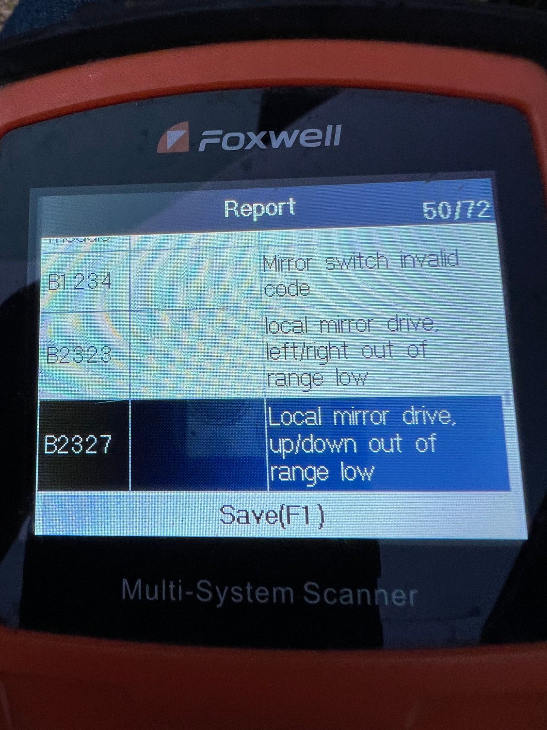

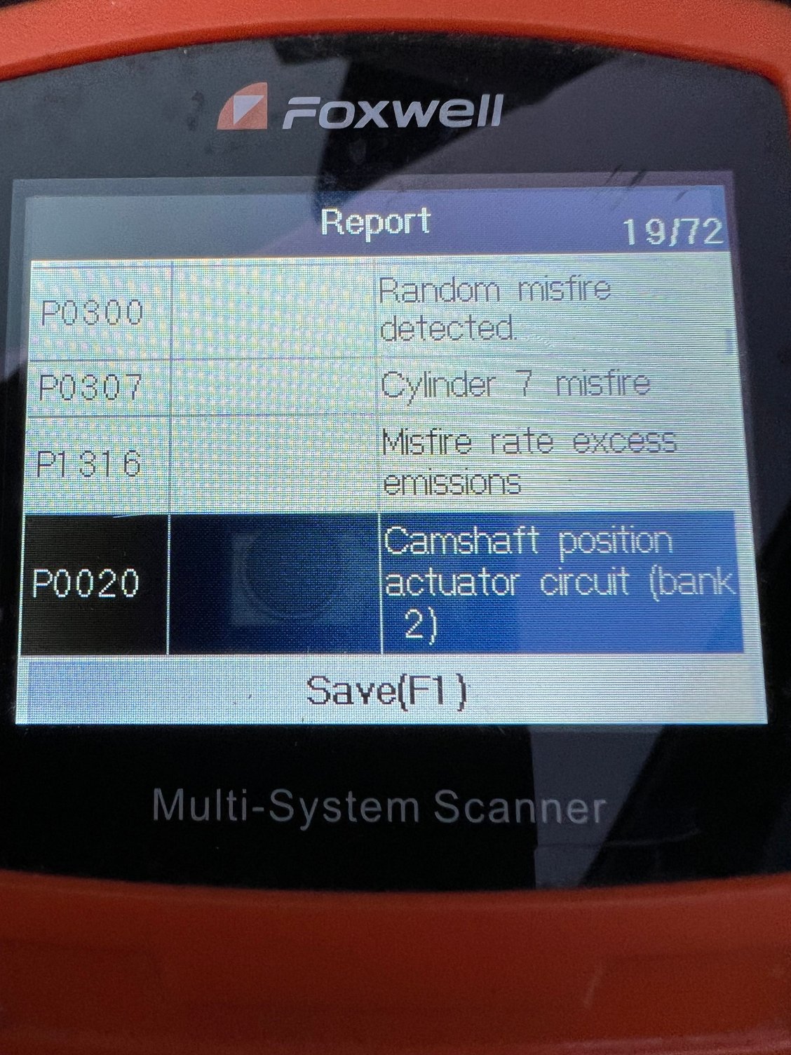

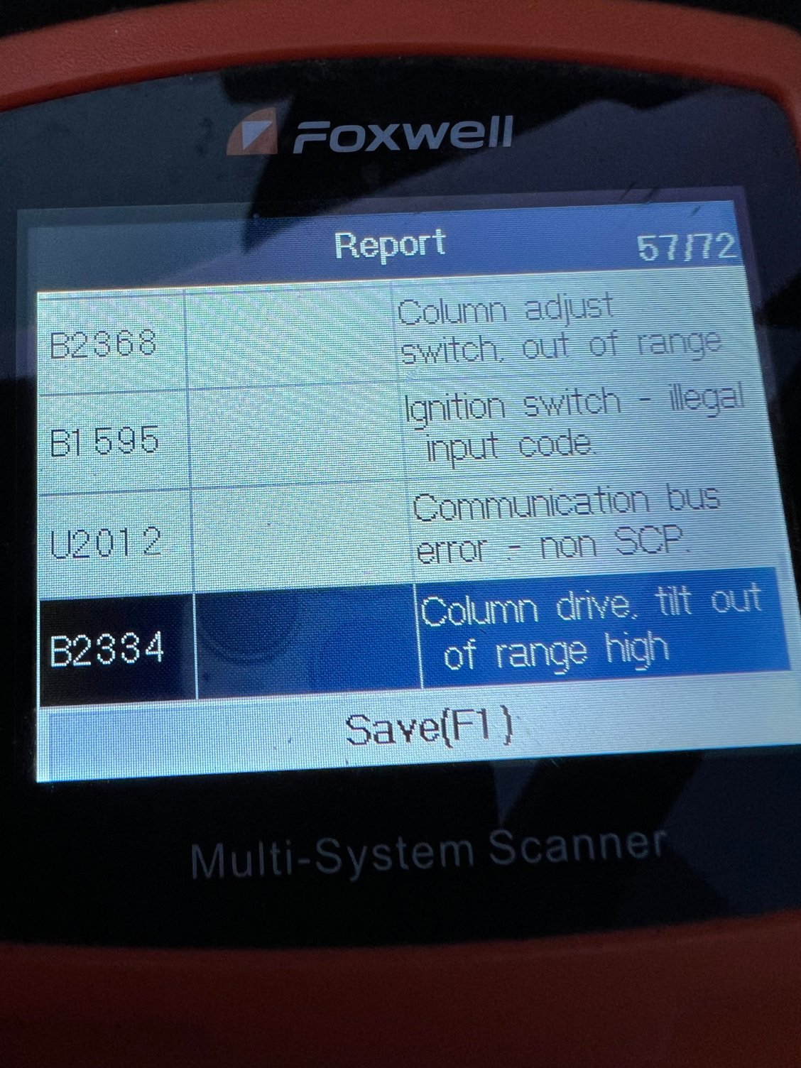

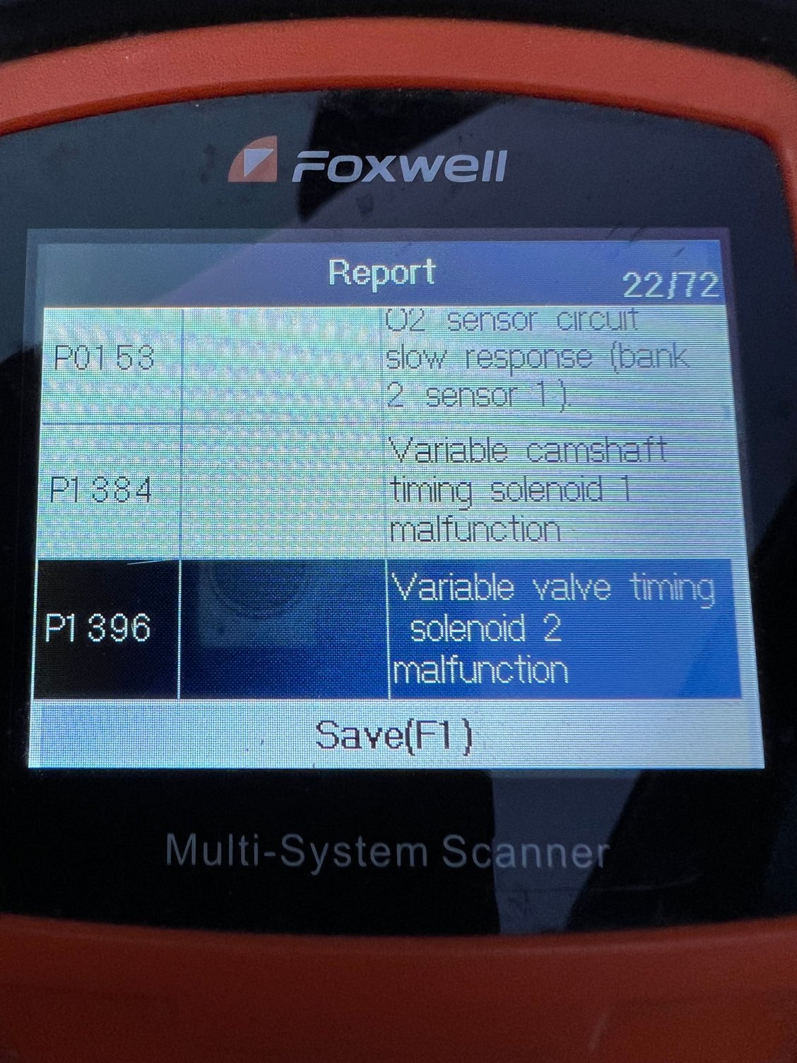

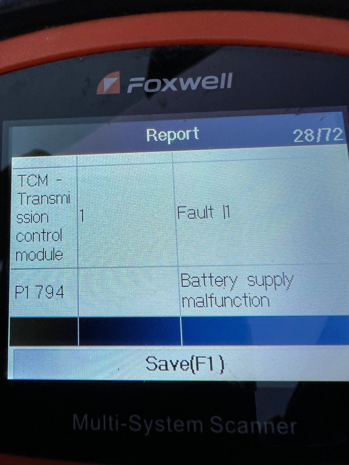

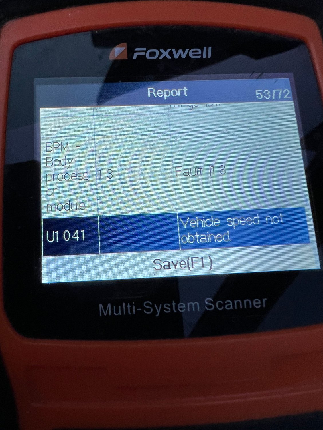

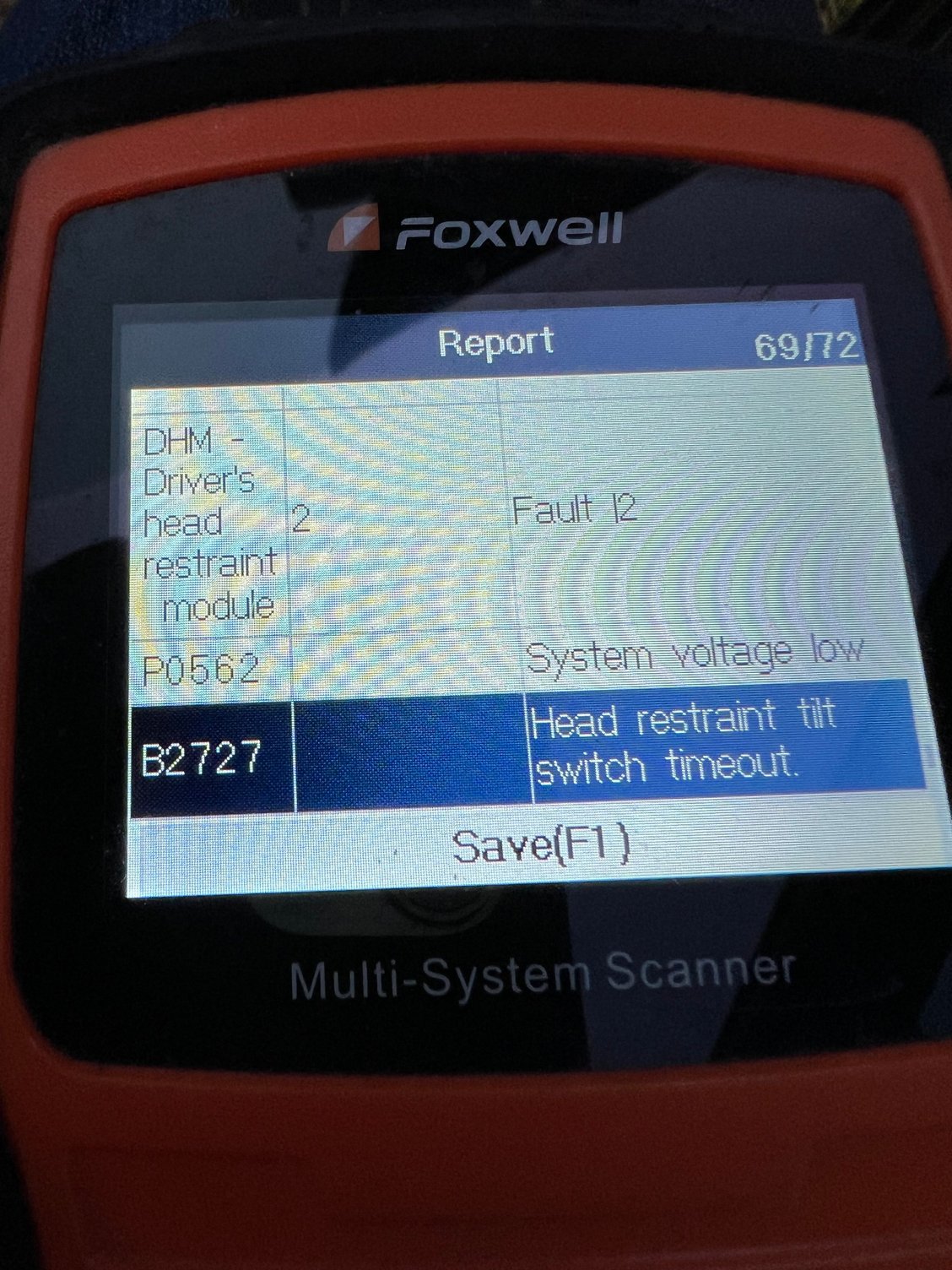

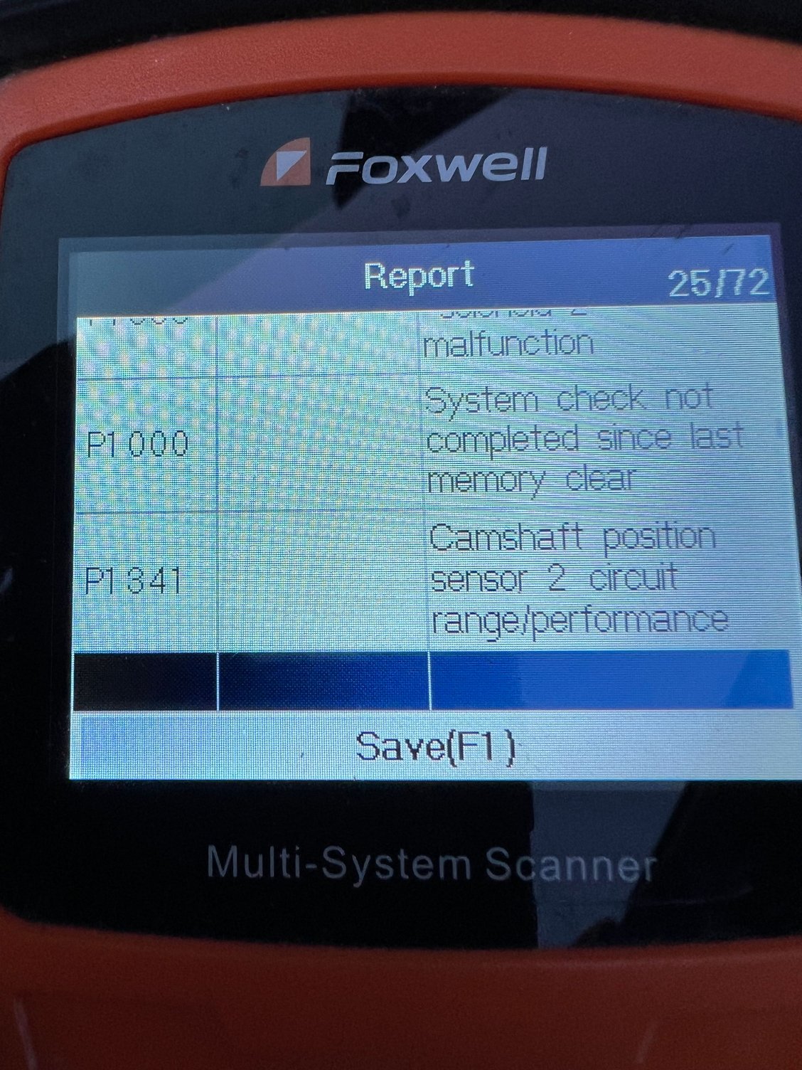

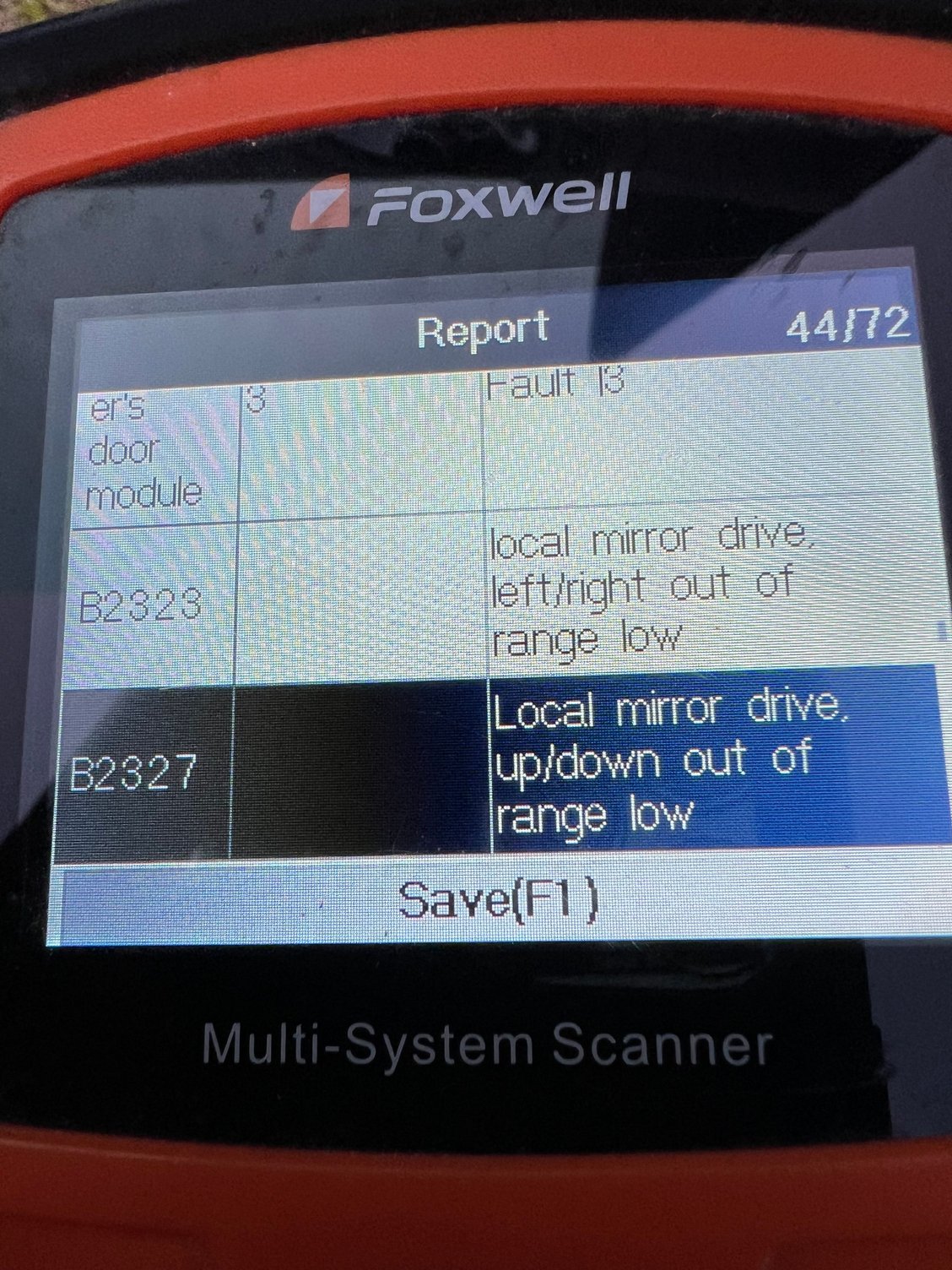

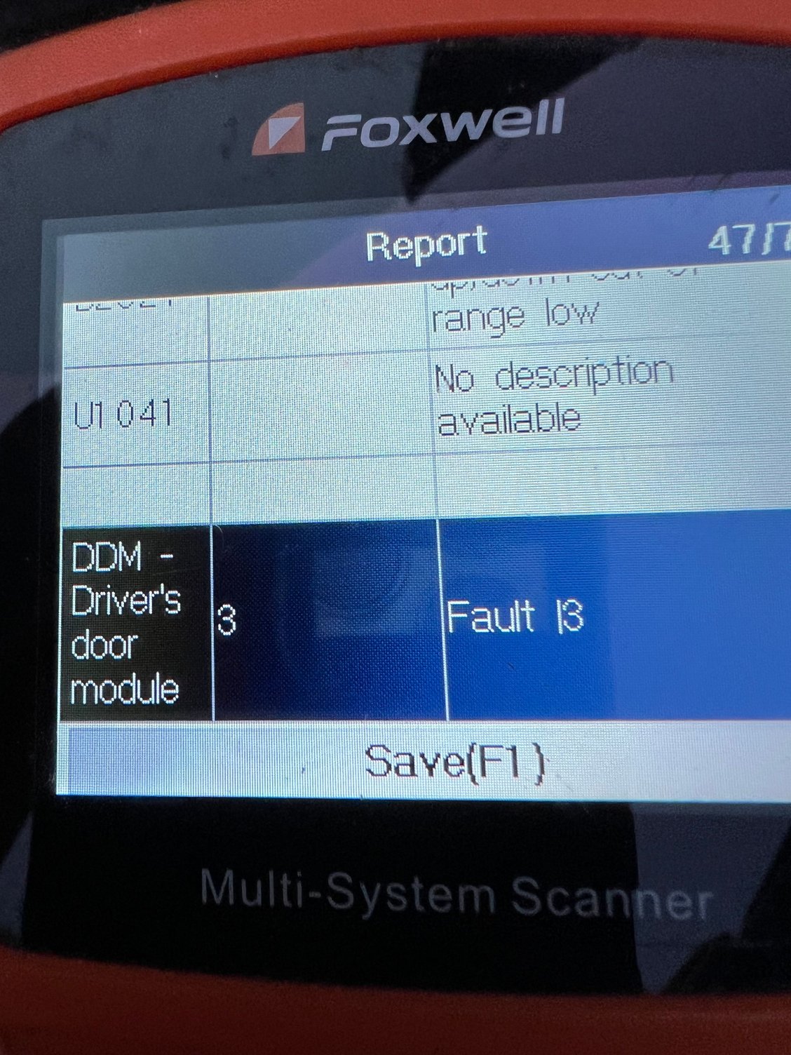

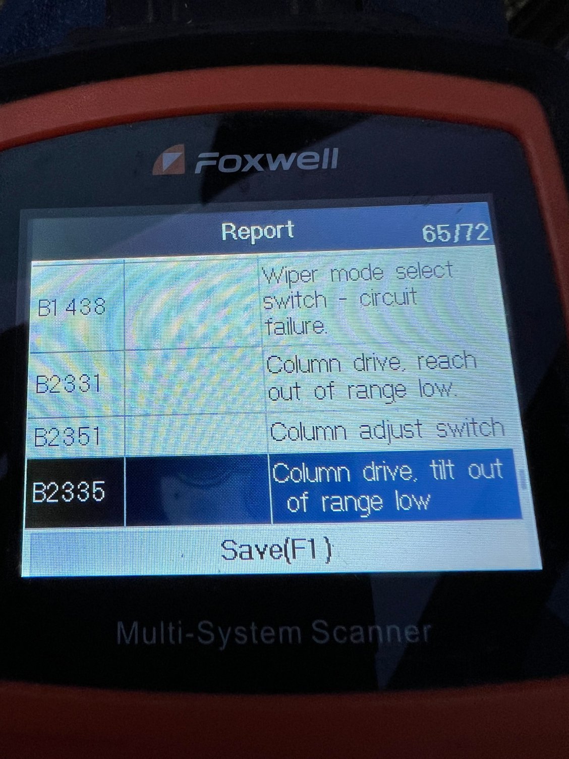

Here are all the codes. Battery totally dead. Hooked up to jumpers just for power to run. Didn’t try to crank. Last time I jumped a dead battery XK8, blue out instrument panel.
Old May 4, 2026 | 08:56 PM
Don B's Avatar
Posts: 20,532
Likes: 15,307
From: Crossroads of America
That's a very handsome car, pcolapacker!
With a strong healthy battery, most of those codes will clear and not recur. Then you can focus on what's left. Have you tried turning the crankshaft manually?

I would be prepared to re-power it, but would first check if the crankshaft turns. If yes, pull the plugs and valve covers, look at the camshafts. If THEY are turning, pull the plugs an poke a borescope in each of the cylinders to look.
Remember also that a transmission failure can cause the engine to stop.
+1
Many are either phantoms or symptomatic of low battery.

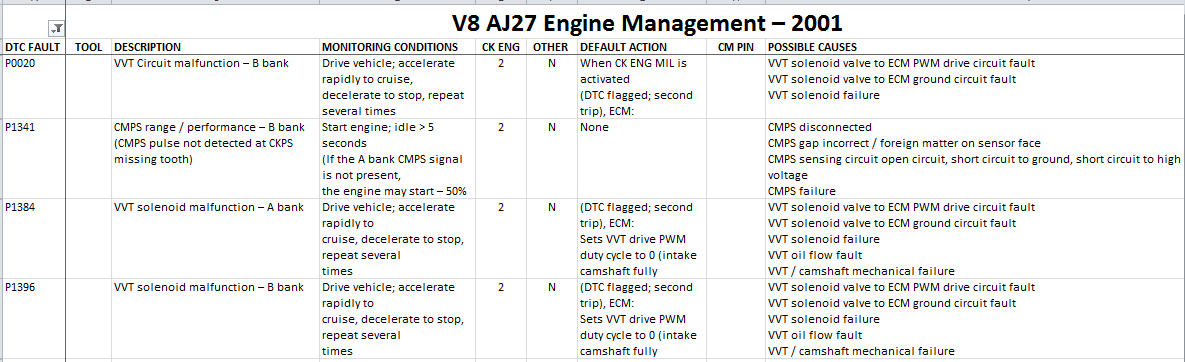

These would be more of a concern to me as they are camshaft-related:
1384/1396 (potentially cams out of phase with the crank) crop up sometimes after tensioner repairs (there are no glow plugs in this engine!). I'd lift the cam covers and turn the motor over gently by hand - if there's no more obvious damage - to see if all the cam flats line up.
Fingers crossed.
