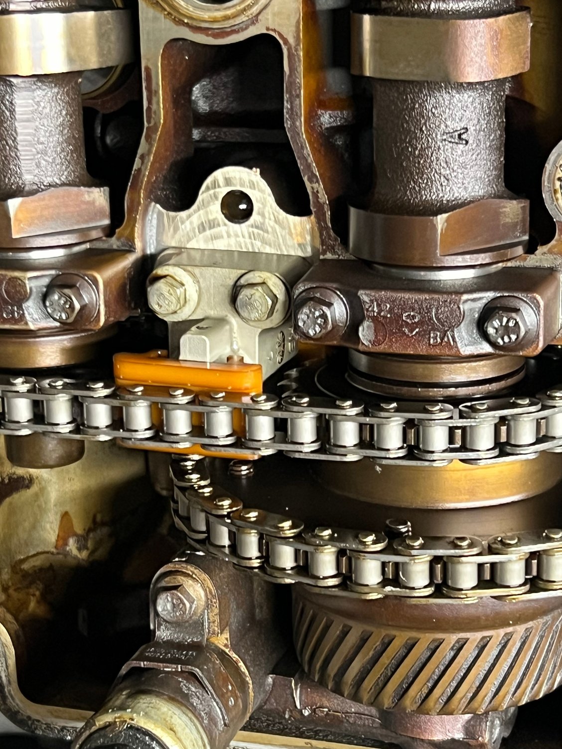

No. Going to work on this weekend. Will pull starter on small chance jamming engine. Drop pan and look for metal. Cut open oil filter. Removing valve covers will show if 3rd generation tensioners.

Fortunately our chain tensioners were replaced in 2012 by previous owner at 52K miles. At that late date, most likely the final generation tensioners were installed.

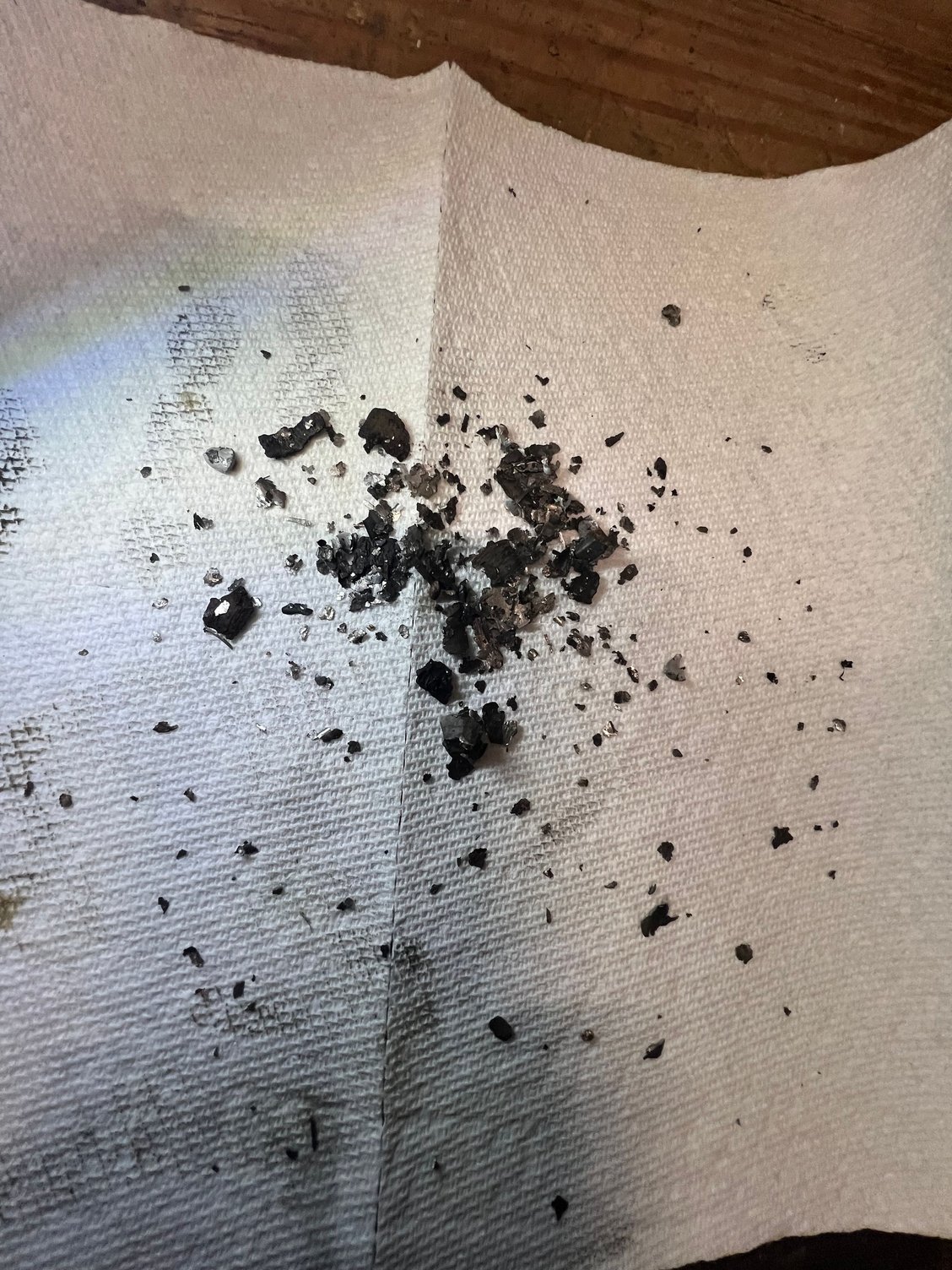

Dropped oil pan.

Are those metal pieces?
or plastic ?
either way, something happened that was not supposed to happen. But it was fixed half ***, ie they don’t clean out the pan, which is basic repair procedure.
All metal.

wymjym's Avatar
Joined: Oct 2016
Posts: 1,779
Likes: 1,259
From: near Austin
So, LS1?

Originally Posted by wymjym
So, LS1?
wj
Contemplating. If do, will be an LS3 with manual.

Originally Posted by pcolapacker
Found this is glove box. It’s an estimate. Don’t know yet if work done. Quote 9/23 includes battery. Battery in trunk sticker 9/23.
Third gen tensioners so it looks like the work on the estimate was done 15k miles ago.
