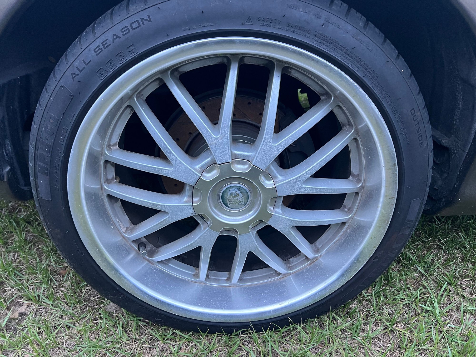

Not sure I’m loving these 20” deep dish wheels. 245 front 275 rear Advanta brand tires16k miles. Could use some polishing. If anyone within driving distance of Pensacola wants to switch send me a PM with a pic of yours.
