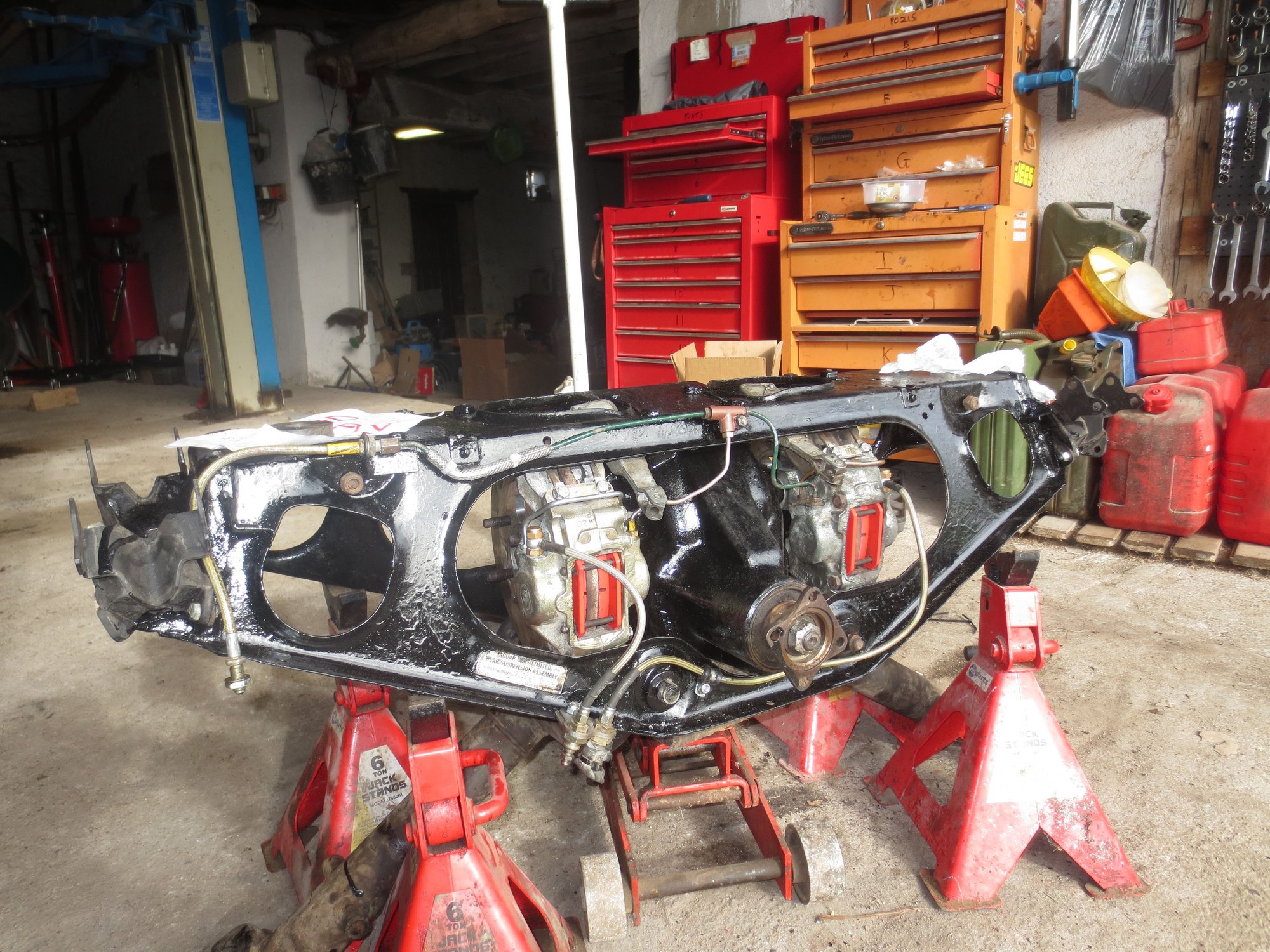

Thanks, allot for your help. Now time to repair the paint damage and reassemble the drive line. Does the brake line need to have a heatshield sleeve placed over it? How far should the sleave be installed? I purchased the stainless-steel remote bleeding kit. The hose on the kit is not very long and has to be install close to the exhaust pipe next to the brake calipers can the stainless-steel hose handle the temperature?

Which kit did you buy? Have you a photo? Mine reach down a long way from the calipers:

The pictures of the exhaust system installation and the remote brake bleeding kit are very helpfull. I have the same remote brake bleeding kit.
