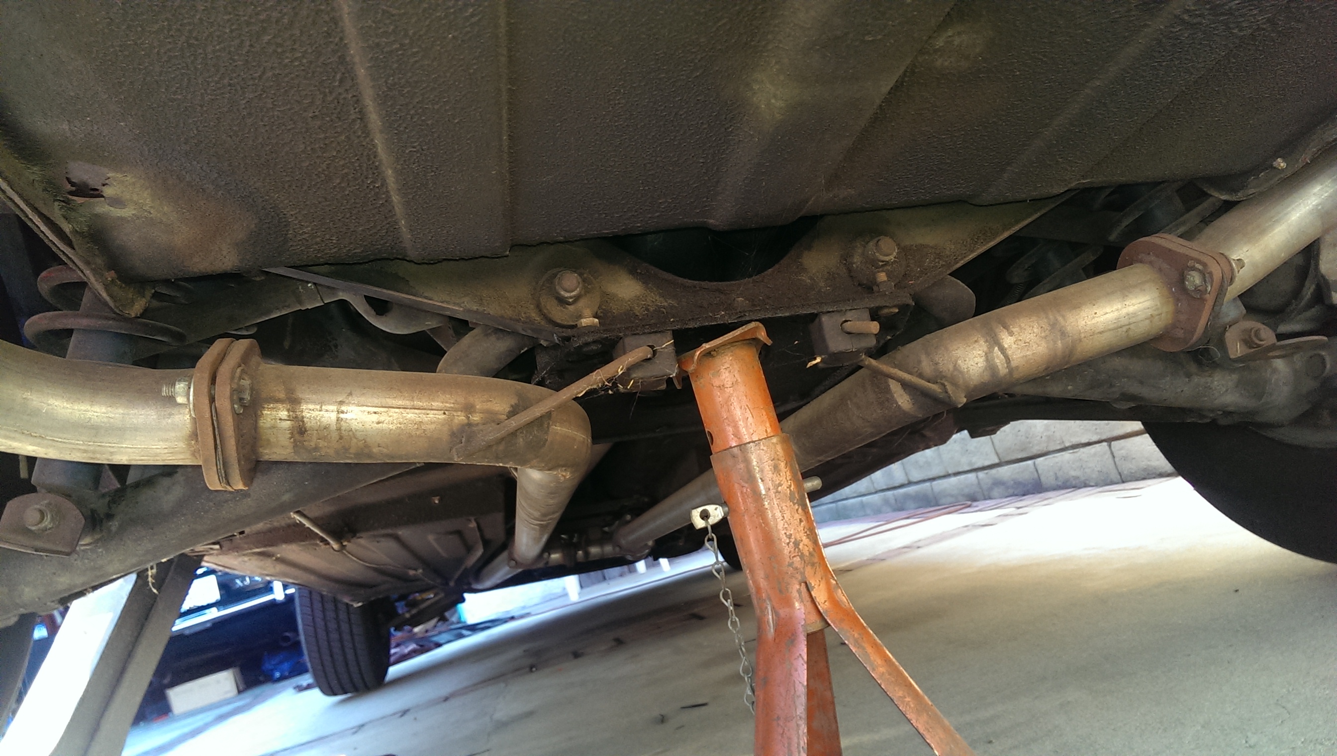

Have it run under the IRS, that way your larger size pipe will not make a difference... can even use round mufflers in the resonator holes in the rear instead of the oval ones I used that show a little. You can use any exhaust tips but the stainless curved ones from a S3 will keep the exhaust fumes out the car with the windows down... you have to neck down the last pipe to fit the smaller size Jaguar tips.
I did this on the '72 LT1/700R I used to own and am getting ready to do this to my current car. Lot of ways to mount the pipe but it ends up like a Corvette.
Second picture is another Jaguar with the exhaust under the IRS. It is the only way to go with a Lump using good sized pipe.. side exits for pipes are not a good choice... yes it is a crazy thought!
Attached Thumbnails Where does your Exhaust dump-exhaust-under-irs.jpg   Where does your Exhaust dump-exhaust-under-irs-idea-2d-time-v-clamps.jpg
