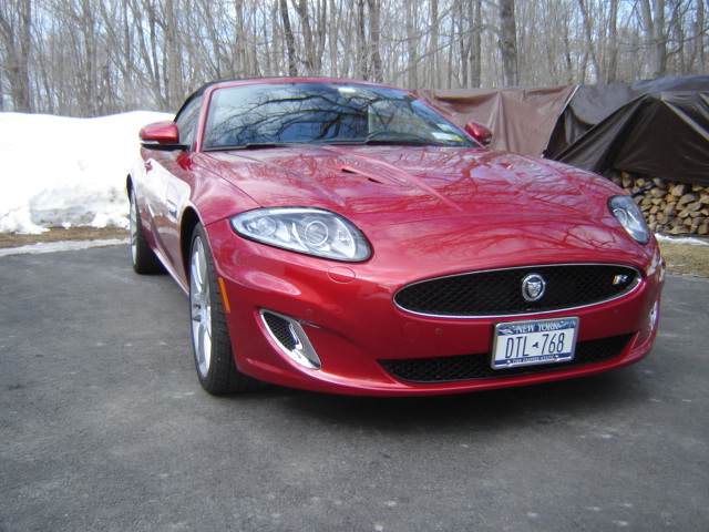

I was thinking ahead for you single plate guys. I mounted an aluminum angle under the center area below the top grill. Screwed the OEM plate bracket to it and attached the plate. There are no holes in the front so when anyone only needs a rear plate you remove the bracket and angle.
