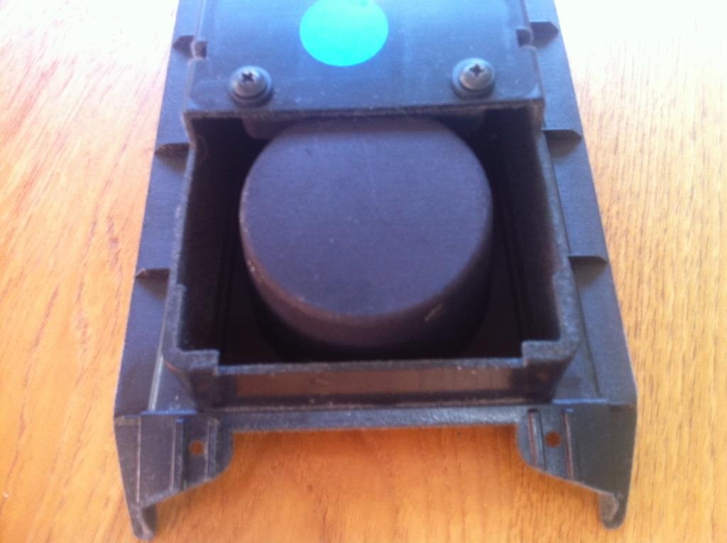

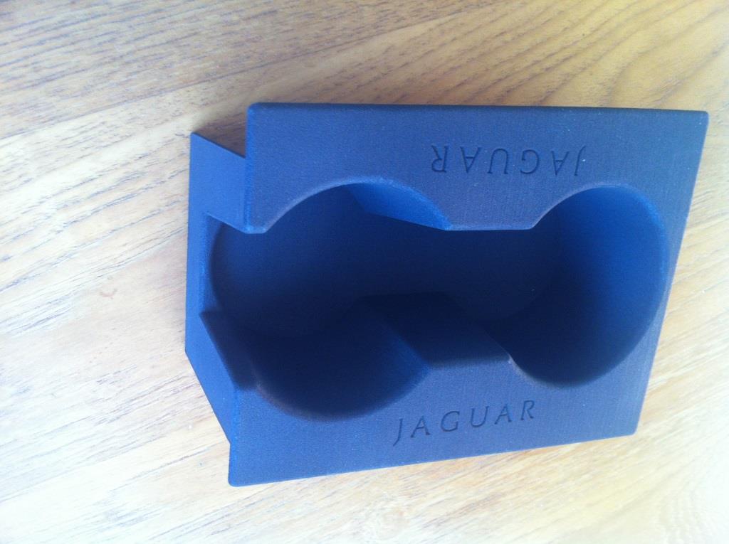

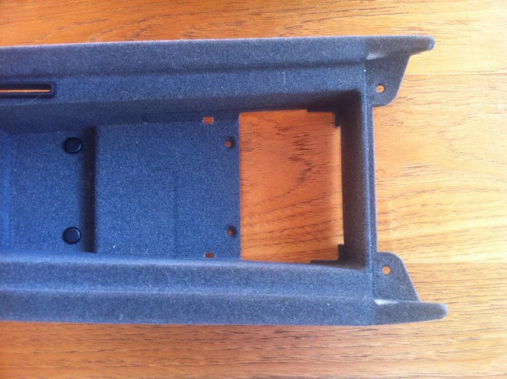

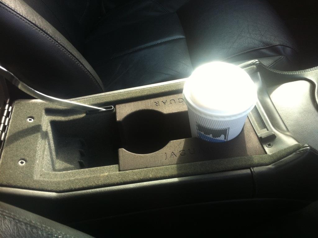

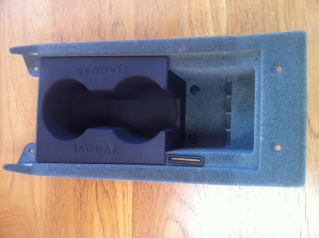

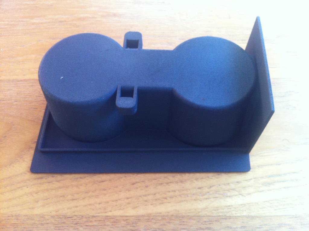

My car doesn't have cupholders and I got sick of being paranoid when carrying coffees home. But people seem to be pretty rude about the effectiveness and robustness of the factory cupholders, plus it's a drama getting a used console lid in from overseas. So I designed my own one in CAD and had it rapid prototyped at Shapeways. See the attached pictures: it sits in the armrest pocket, replacing the phone, and screws in place through existing holes in the pocket molding. Works pretty well, and I'm pleased with the part quality - not as good as a production plastic part, but would pass for one at a casual glance. Its designed to take 2 12oz cups.
If anyone else wants one I've made the file available for order from Shapeways here. Pricey at $170 (in "black strong and flexible" material, aka dyed nylon), but cheaper than it probably would have been if I'd been able to buy one from jag! No margin for me in that, by the way, that's just what rapid prototyping costs...

You made an awesome design, and it's a great idea, but what happens when you hit the brakes and the lid slams closed?

Speaking for my own use, I thought of that but I don't care: this isn't so I can drink in the car (I don't believe in that either) , it's so I can carry a cup home from the cafe or drivethru. I'll just close the lid on top of the cup.
For anyone who wanted to use it for drinking though, it'd be easy enough to file a notch in the lower edge of the lid stay so it would latch open.
