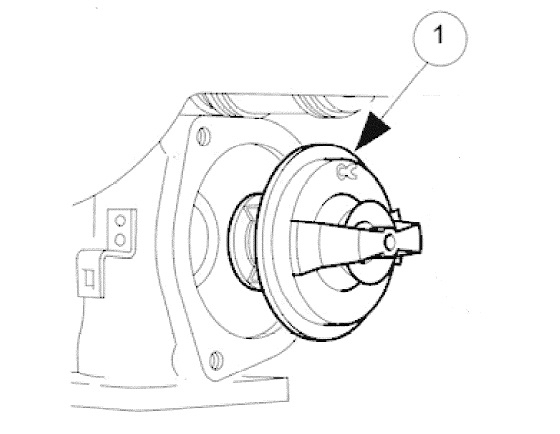

What part number thermostat did you get? The pointy end of the thermostat should be facing you in this picture.

See if this makes it clear:
If it is in right, bring a pot of water to boil and drop in the thermostat. It should open wide.
Make sure the little hole in the valve plate is oriented to the top when you re-install. Removal of the water pump is fairly easy on this car, after removing the serpentine belt.
