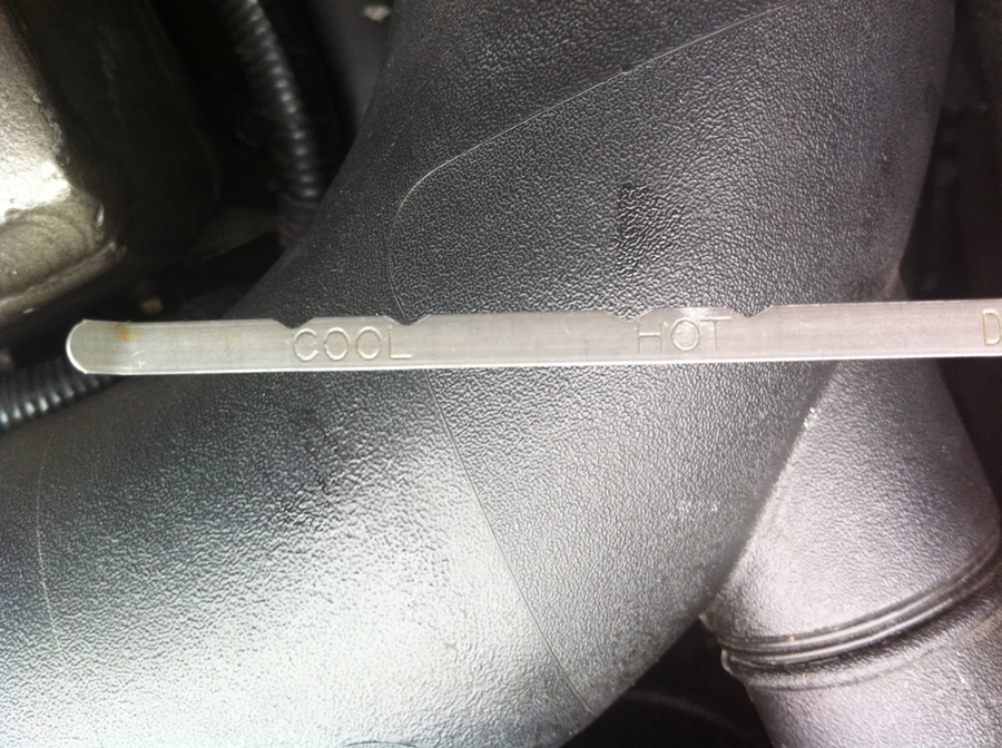

I'm completely new to Jaguars & have purchased a 1999 XJR with 104000 miles. My question is: There is a dip stick & tube near the passenger side fire wall, I suppose is for the trans. However when I try to check it it's bone dry. What should I do?
I'm afraid to touch anything under the hood?

Default Pictures of the Dip Stick
I think I have put the right locations for the photos I took of the Dip Stick, Tube & location.
Attached Thumbnails Dip Stick & Tube?-tube_image.jpg   Dip Stick & Tube?-whole_dip_stick.jpg   Dip Stick & Tube?-dip_stick_location.jpg   Dip Stick & Tube?-end_of_dip_stick.jpg

That's the right place.
But, the 1999 XJR did not have a dipstick.
So, it must be an owner add-on, or someone just needed something to fill the hole. The problem is that you have no idea of the accuracy of the markings.
You need to either:
1. get the level measured by someone with the correct dipstick "tool"
2. acquire such a tool for yourself
3. fabricate such a tool for yourself
The tool can be found on ebay by searching for: mercedes dipstick 722
What you have already could form the basis of a nice dipstick, if you can redo the markings. The problem is knowing the relationship of the bottom of the pan to the markings since the handle stops the dipstick from bottoming.

That's an incorrect dipstick. Someone may have used it to just plug up the tube. You may want to get the fluid level checked properly, in case that dipstick was used to fill the transmission to the incorrect level.

That's not a dumb question at all. But, yes, the tube leads all the way to the pan (ie there is in fact "a hole leading into the transmission").
To try and clarify what others have already posted, the system on your car was originally sealed by a cap that fit where you found that mysterious dipstick. In other words, the dipstick tube was originally sealed off by plug that has since been removed on your car. There was not an actual dipstick supplied on your car when it rolled out of the factory. Someone apparently serviced or inspected your transmission, which required that they "unseal" it by removing the original cap. They then used the dipstick you found to close off the tube (rather than replacing the sealed cap).
I would recommend taking it to a Jaguar mechanic over a Mercedes place if you decide to go that route. And don't worry about the dipstick not registering any fluid. As others have pointed out, it's quite possible that the dipstick you found isn't even long enough to reach the fluid.
