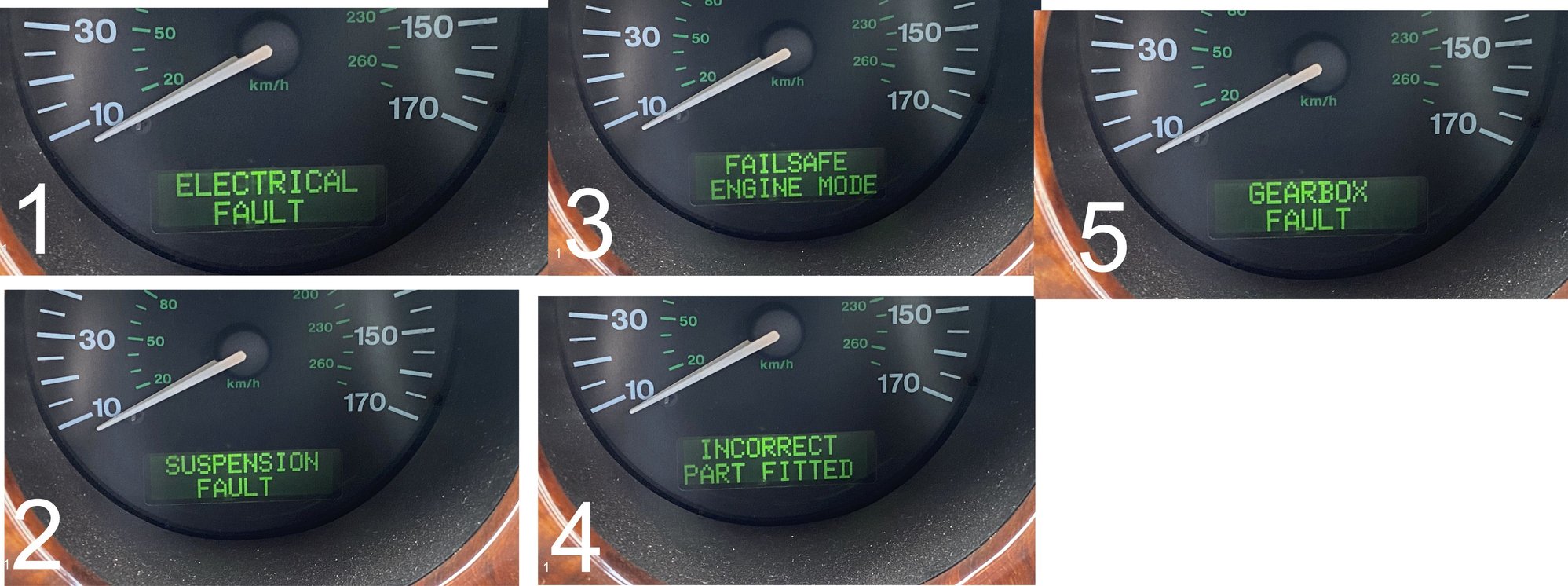

Hi Jaguar Enthusiasts, i bought my Jag xj8 (build 1998) in the UK 2009. I love it, but the MOT (in Germany TUV) stopped her Driving Life for 4 Years. A lot of rust and some holes in the Car Body we have to fix.
Now it is fixed, but she doesn't want to start. My Mechanic Friend didn't work on the electric (because that is ok). He only fixed the Rust Problems, plus Breaks and put some underbody Protection. In January 2024
we make a test Start and she starts and runs well. But than he fix the Rest of her Rust Problems (Metal holder of the Front and Rear Bumper) and finish the Underbody Protection.
Then we put a new Battery in and try to start, but she can't. She shows on the Display Electric Fault, Suspension Fault, Failsafe Engine Mode and incorrect part fitted and also the remote Key cant open the Car. With the
normal Key, i can open the Driver's door and the Alarm stops. That's it. My Friend and I are not really good in Electric. So we take her to a garage on a Trailer, but they check the Main Control Unit and every Relay, and we make a Hard Reset but nothing happened. We connected a long Cable from the Battery Negative to the Front Engine and only the "Gearbox Fault" is on. But how can we find the Ground Cable or mass Problem. My Garage is not really a
Jaguar specialist and i talk to a Jaguar Technic man in a Jaguar garage in Hamburg, but they all have no idea. Because in Germany I think we have not enough People with JAGUAR Experience so I ask here on this Forum for Help. Dorothy, That is the Name of my Jag was nearly 15 Years (minus the 4 Years of standing in the Garage for Repair) my second Love (after my Wife :_))) and I want to use her. Also because my Friend who repaired all the rust Problems and me are looking forward to see Dorothy on the Street again. She is dark red and pretty. And she is English. I am born in London but over 60 years in Germany so sorry for my English.

You are relying on the error messages on the display... Don't do that. The display will tell you anything. If there is an error message on the display, you know that something "may be" wrong, but you do not know, what it is. I have the permanent annoying message that my rear bulb is blown...: No, it's not, I just use LEDs...
At another occasion I forgot to put the connector back onto the throttle control motor, and I had all kinds of "love letters" (messages) on the display, like: ABS failure, and lots more, and all those messages were wrong.
You need a OBDII code reader. you can find them online, and even dirt cheap (AUD$ 10 - 15), and those do work AT TIMES real good, but occasionally they fail to communicate an occasional error to you, hence I'd recommend to spend a bit more...
You did already make an important discovery, when you connected the battery-minus with a starter cable to the engine block to the effect that some error messages disappeared. So yes, it really looks like you forgot to reconnect a ground cable - or did not connect it properly.

Somewhere you have a missing connection, as noted, most likely a ground.
See if the attached helps. Also, on this forum you will find a wiring diagram.
