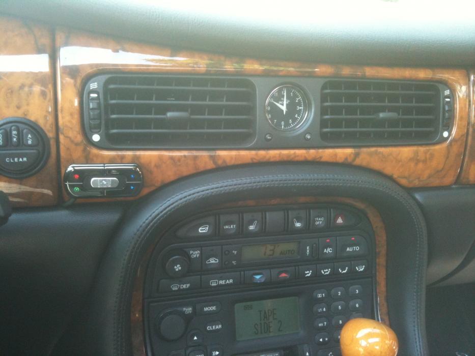

so i did it...i finally installed the motorola t605 and ditched the factory phone i was using...jim's doc worked great and i love the fact that i have a center console with storage space now...anyone want to buy an old motorola timeport
Could you share a photo of how it looks? Thanks.
pics of my t605 install below...also the center blue light on the t605 is way too bright for my eyes, so i used some foil tape to block it...i poked a pin hole in it so i could still see the blue...
After all this time, I just completed the install into my 99 XJR. I used the Motorola T605 also. It's a nice clean look, doesn't distract from the asthetics of the car too much. The controler is MUCH smaller than I expected which helps.
By the way, for anyone doing this in the future, remember that the yellow and orange wires are sometimes reversed on some of the Motorola units. I bought my unit online for $22, so when I hooked it up and could not get it to mute correctly, I thought I'd been had. I struggled with this for a bit until I read on here somewhere that it can be that way. My stereo would not mute when I went to phone. Swapped the two colors, and voila! Sounds and operates great!
I placed the controller in the same position as pdog2000.
