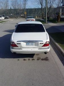

Just purchased my first car and my first Jaguar yesterday... an all white '99 XJR supercharged. It came with 135k miles and isn't by any means in mint shape, but it runs (not well, but can hit 60-80mph before it starts to lurch) and that is all I can ask for when purchasing it for $1000. I've been browsing the forums for a while and am excited to start my adventure on fixing it up and getting her on the road!
Continue reading if you're interested in my hypothetical plan of attack:
The front bearings, timing chains, and rotor need to be replaced... and there is also small leak coming from under the left-hand driver's side which needs to be addressed (I think a coolant issue). I noticed this after I drove it home (1hr drive) and it was parked for some time...there was a small stain on the ground underneath.
I'm prepared to replace the gaskets as well as work on the tranny and do what I need to do to get her as close to new as possible. Some cosmetic things such as rust spots around the wheel arches and a ripped driver's chair that needs to have the electronic adjustment mechanism fixed (currently stuck in place) need to also be addressed.
Many may think I'm crazy for buying a piece of junk but I'm invested in the project and will enjoy the process. I hope to find most if not all of the parts I need online at wholesale price and volunteer my car for repair at Autoshop class at a local highshcool. Once there, students under the supervision of the teacher who is a 30 year veteran auto mechanic will do as much as they can with the resources they have to fix my car (free labour!).
After that's completed I will go to a highly qualified Jaguar restoration shop in my region and get the car checked out by those fellas...there will obviously be some fixes that I would prefer to be done professionally (hopefully not a lot however due to the $).
I expect this to be a lengthy process and one that is far more expensive than I paid for the actual car, but if i can manage to keep the work under 9k I think I will be very happy with a dream car for roughly $10,000.
Feel free to give me any opinions or advice, I am young and relatively novice at this sort of thing. Opinions to scrap the car for parts or abandon the project are expected and probably warranted but hopefully I receive mostly positive feedback haha.
Cheers everyone have a great day!

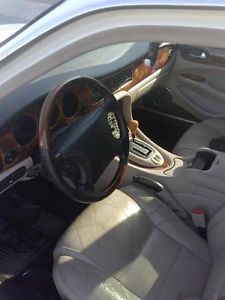

Is the interior in good shape? You could spend thousands restoring a ratty interior. At the minimum you are going to have to do the headliner and drivers seat, which probably is well worn after 130K miles.

The interior is in decent shape... the headliner seems to be in good condition but the two front seats have quite a bit of wear. the wood trim panel on the drivers door has a crack through it so I'll probably want that replaced. As far as the speakers and CD player in the trunk they both work, but the antenna has been cut off of the trunk it seems.

I would go along with Vector: maybe a much newer and better 308 for that kind of money would be a better choice. But . . . your in, so get it repaired.
The water under the car may be condensation from the A/C. No issue, leave it alone.
Why it is lurching after 80 mph would be my first concern: probably dirty throttle and MAF sensor. Maybe old plugs: lots of reasons, but need to be worked off one by one. Try a can of SEAFOAM to clean up the valves and fuel system . . . a cheap fix. Worst case: a bad throttle body. Keyword search on this forum will open up lots of threads on each of these issues.

Spend $5 or $10 on a fuel filter first. But apparently a PITA to replace.

Originally Posted by Trubs96
Hey all,
