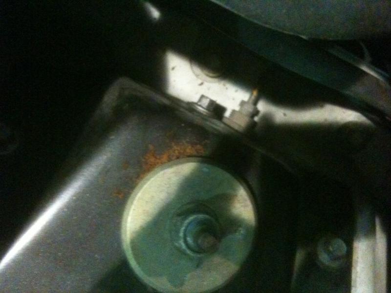

this looks bad to me...take a look at the pic...it is the rubber for the right front shock mount...as i touch the rubber it flaked on me...i am assuming this is pretty bad and if my touch and rubbing will cause the rubber to flake that the whole thing is probably in pretty bad shape...what do you all think?

Looks bad to me also. Flaking rubber, like rust, is most often worse than it appears. Got any front suspension 'knock' on small bumps?

It looks to me that you need to replace your upper bushings you can buy the replacement kit or just bushings form Shock Mount Bushing Kit - MNC2168-69.KIT or Coventry West, Inc. - Online Store or Jaguar XJ8 Front Shock Replacement Bushings (4) | eBay

Mine were flake as well, I replaced using the kit. Also replaced the bump stop on shock shaft and the lowere shock mount rubber. I probably could have skipped the lower shock mount, the upper shock mount was flakey, but wasnt quite as bad as it looks... still glad I did it though. Bumps stops were toast. pressing the kit is apain... ended up taking to a machine shop.

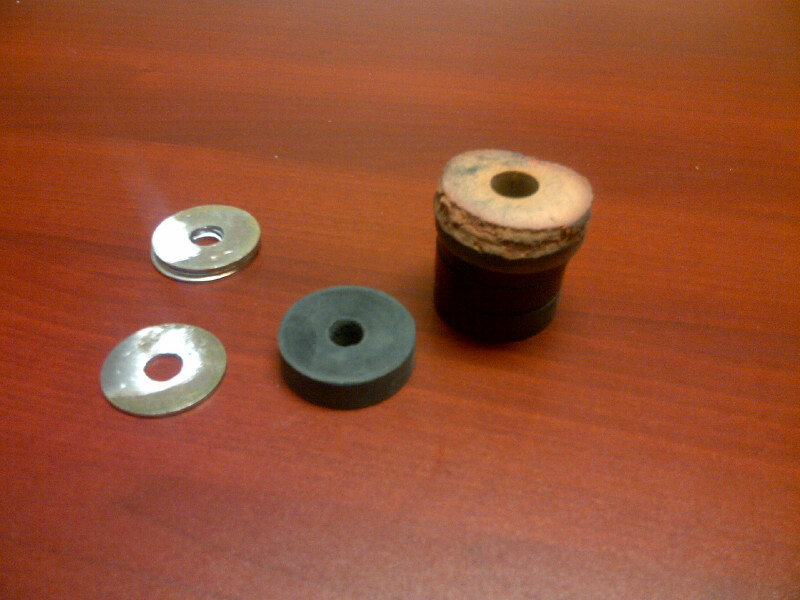

I'm new to the site and this thread saved my wallet, however being cheap, impaient, and a bit of a mad engineer I came up with some alternative parts. I stopped by the local auto parts store and saw 1 7/8" - rubber expansion plugs. Took thoose apart and thinned them out a bit on the bench grinder, then opened the hole up with the drill press. So intead of even speading the 50-80 bucks for a bushing kit on line. I got out four an hour labor and 12.92 (you need 4 plugs @ 2.99 each). I soon as I install them (tonight I'll let you know). And as soon as I figure out how to post a picture I can attach a few. Note: I'm sure I'm not the first to think of this and that you could even find better materials somewhere else. But this was cheap, quick and got my creativness flowing...

lets try this

Ok it worked great no issues at all. Expansion Plugs trimmed about an 1/8 in thickness, and ID opened up to about .550 to .620 will work for front upper shock mount bushings. I was able to pull the old one apart with a fly wheel puller and reassembled with a hammer to set and a vice to seat (couple of sockets to space). But yeah they worked great! the rudder compound of the expansion plugs is not rock hard and meant to flex a little I think the ride is great...
Attached Thumbnails front shock mount - is this bad-west-bexar-20130403-00087.jpg   front shock mount - is this bad-img-20130403-00088.jpg
