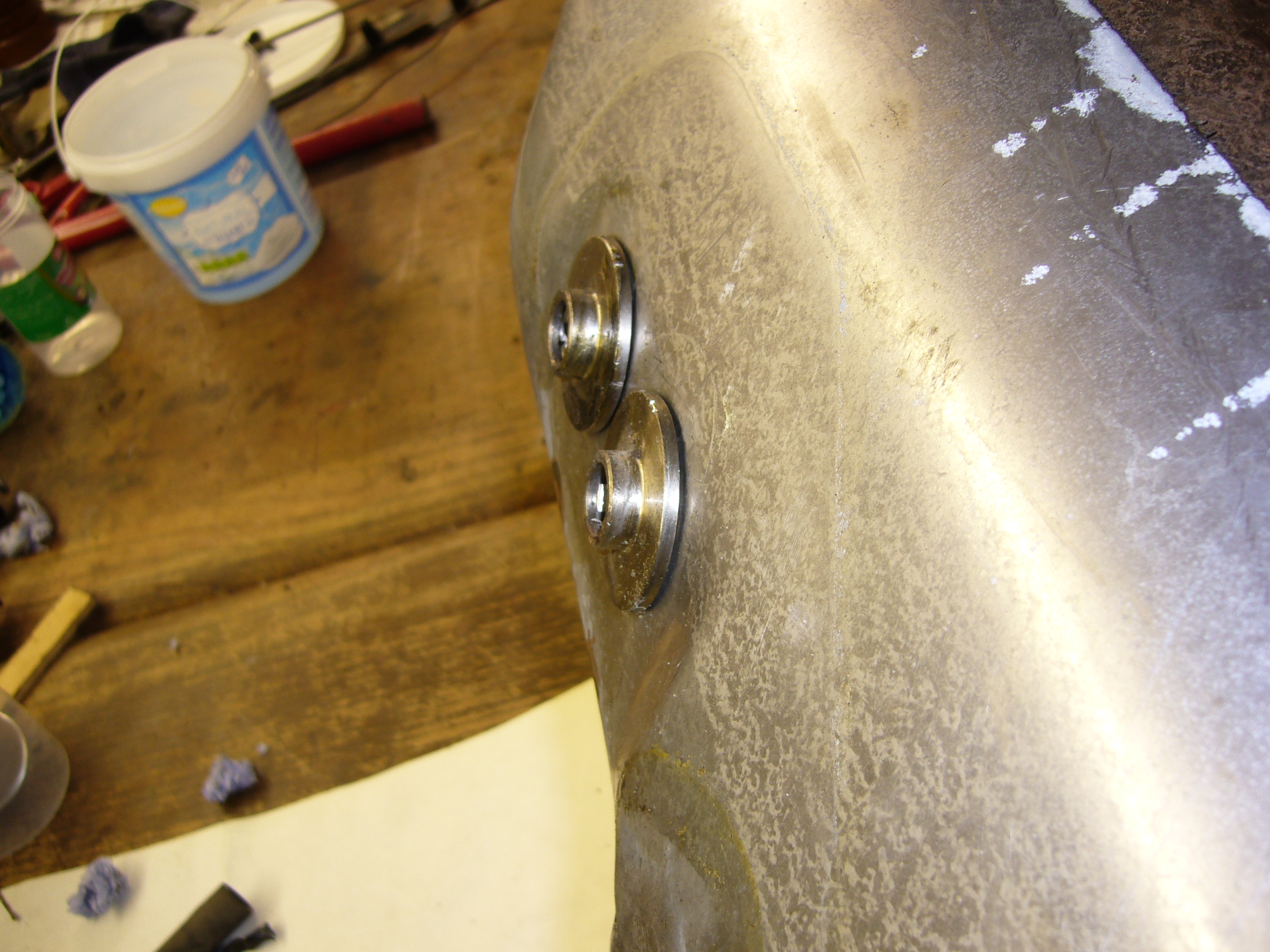

Hello everyone - this is my first post on here.
My car is a Jaguar XJ8 Automatic 3248cc Petrol first registered in March 1999.
I have problems with the 2 push in type pipe connectors built into the underside of the fuel tank. They are damaged and leaking. Is it possible to remove these female connectors built into the tank rather than having to replace the tank or are they a permanent 'sweated in' type fitting? Please see picture of the tank and the 2 fittings attached. Has anyone done this and if so how do you do it and where do you obtain replacement fittings please? Michael

Taking the tank out isn't all that hard, so don't be afraid to replace it, just make sure you either are almost empty or empty it. When I did my fuel pumps, I took a couple of 2x4's and placed them across the battery and spare tire pit and slid it out on them. Though of course when a pump fails, its almost full (like mine was)...I think that's automotive law or something. So I pulled...and tugged and wiggled...an almost full tank out using that method. An empty tank should be a breeze.

Might be available from SNG Barrat, forum sponsor. Diagram number 7 and 16.
