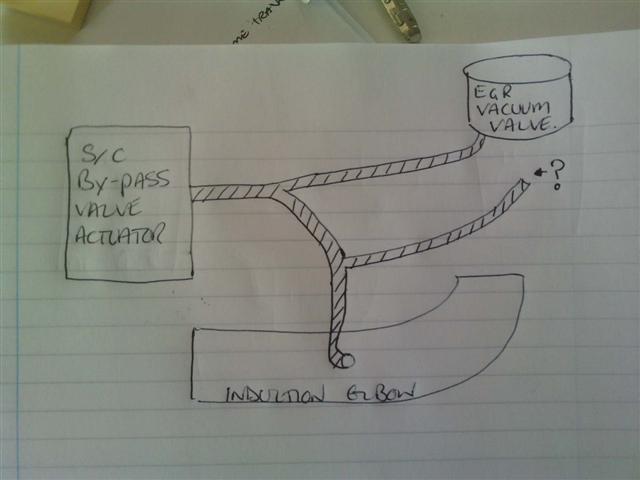

1st pic I.D's the pipe and rough location of sensor. (pipe mid right, 'denso unit' with nipple underneath against bulkhead far right)
2nd pic I.D's the pipes and connections, the question mark is for the evap valve, the one I think might be off and vacuuming...I had the exact issue some time ago, car ran great just a hissing under the bonnet at the rear of the engine. Took a while to find the hose connection, also after a supercharger swap, that's why I think it's this - it might not be as there's a fair bit to these engines, but I hope it solves your issue

ok, thank you, yea I guess I forgot to connect that, either way I still have some small hiss which is barely noticeable but doesn't affect the way it runs/drives... However, I have a new weird code which freaked me out, so I plugged it back up and started it up and got a (1) new code:
