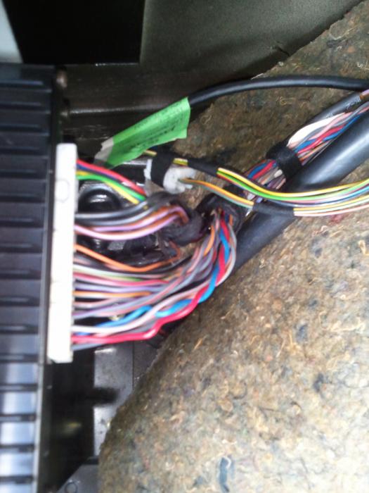

PS: Since luc has verified we have different units, it's possible this photo will be of no help at all.
Photo is looking down on AMP in the trunk.
Attached Thumbnails How can you check if the subwoofer is working?-wp_000007.jpg
