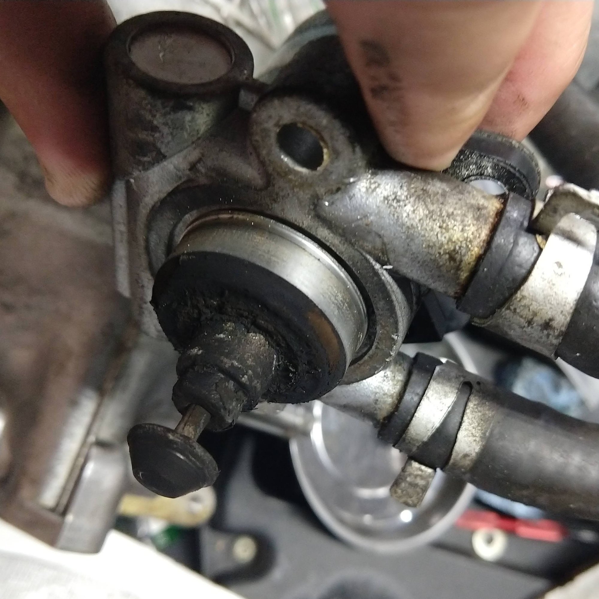

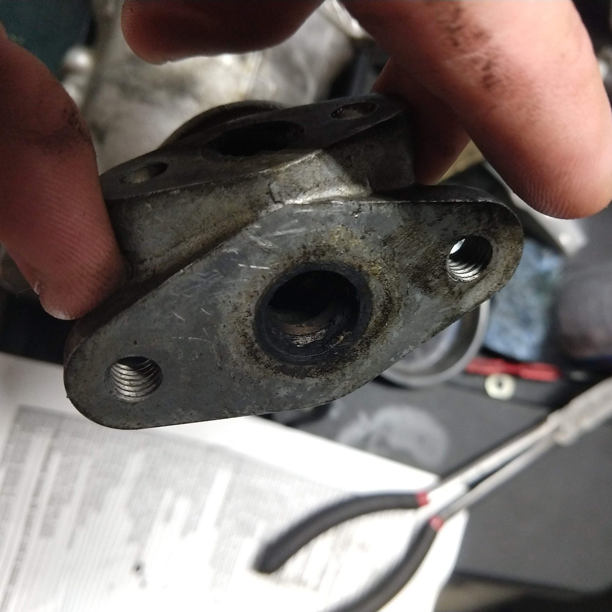

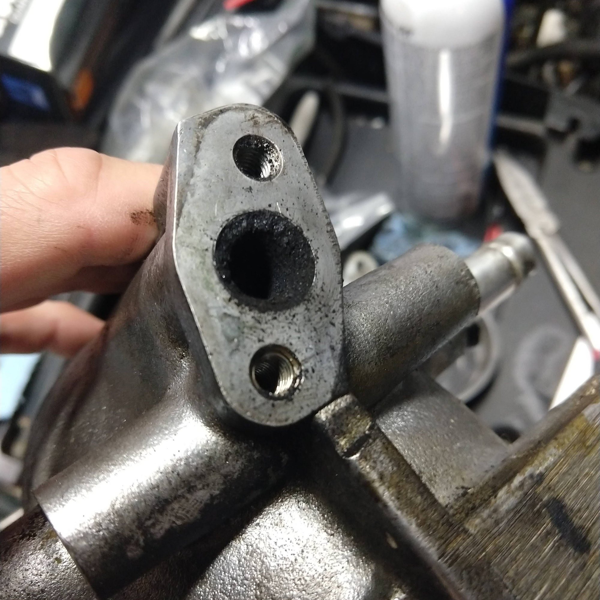

I'm putting my XJR back together and I was about to reinstall the intake throttle body elbow and EGR valve when i noticed a significant amount of carbon build up both in the EGR and in the intake elbow where the EGR bolts to it. It's pretty hard and caked on black stuff that I couldn't even seem to chip away at. Does anyone have a good method for cleaing this and the EGR?

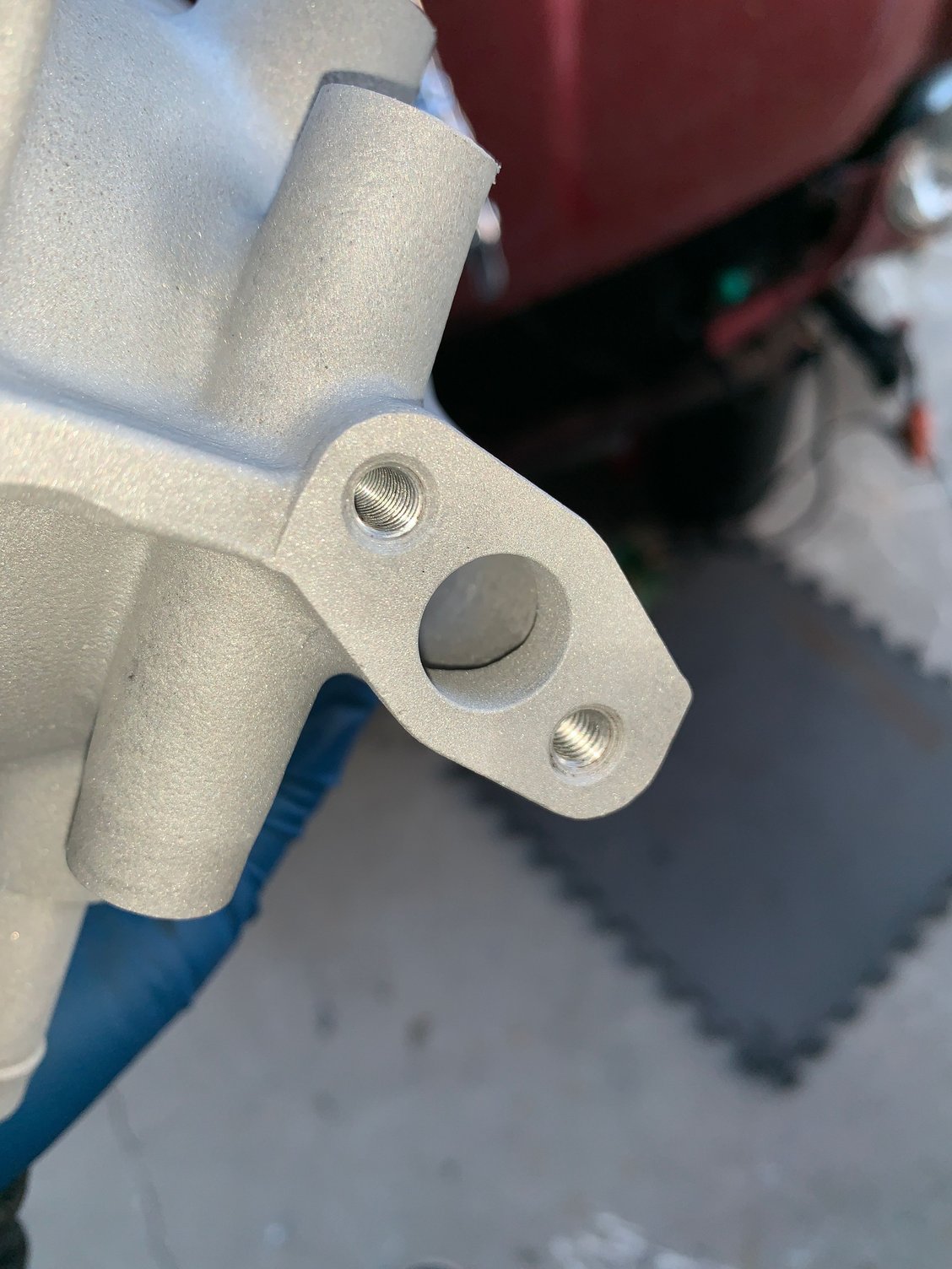

I ultrasonicly clean all my parts and hot bathed some others. Both methods worked wonders. I also sandblasted the outside of the throttle elbow and not the inside where air travels. You don’t want to blast anything inside as the media embeds itself. LAs totally awesome cleaner is cheap and cuts through carbon even more if it’s heated. A dremel helps too.

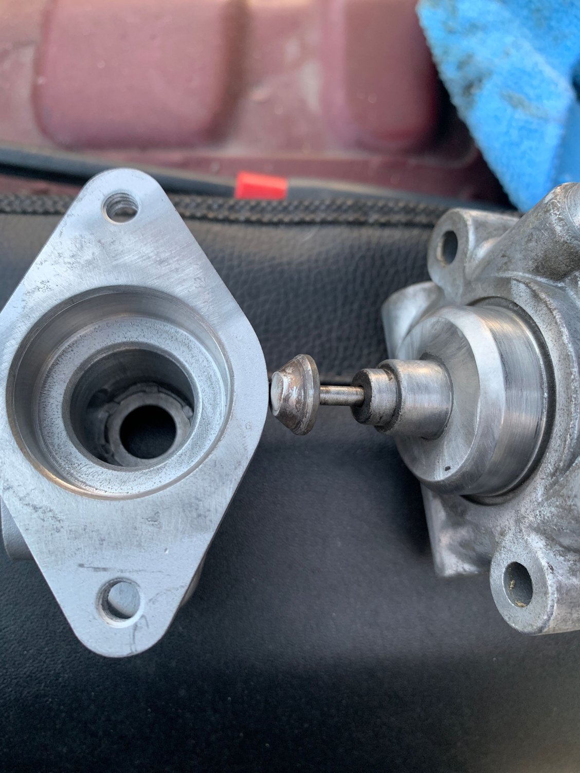

Cleaned the EGR with Carb cleaner, brass brush, and tiny screwdriver for the chunks. PORNO went all out

A dremel with the wire brush attachments did the trick. Don't think I really need to do the ultra sonic cleaning. I'm just trying to get this car back on the road, not building a show car.
