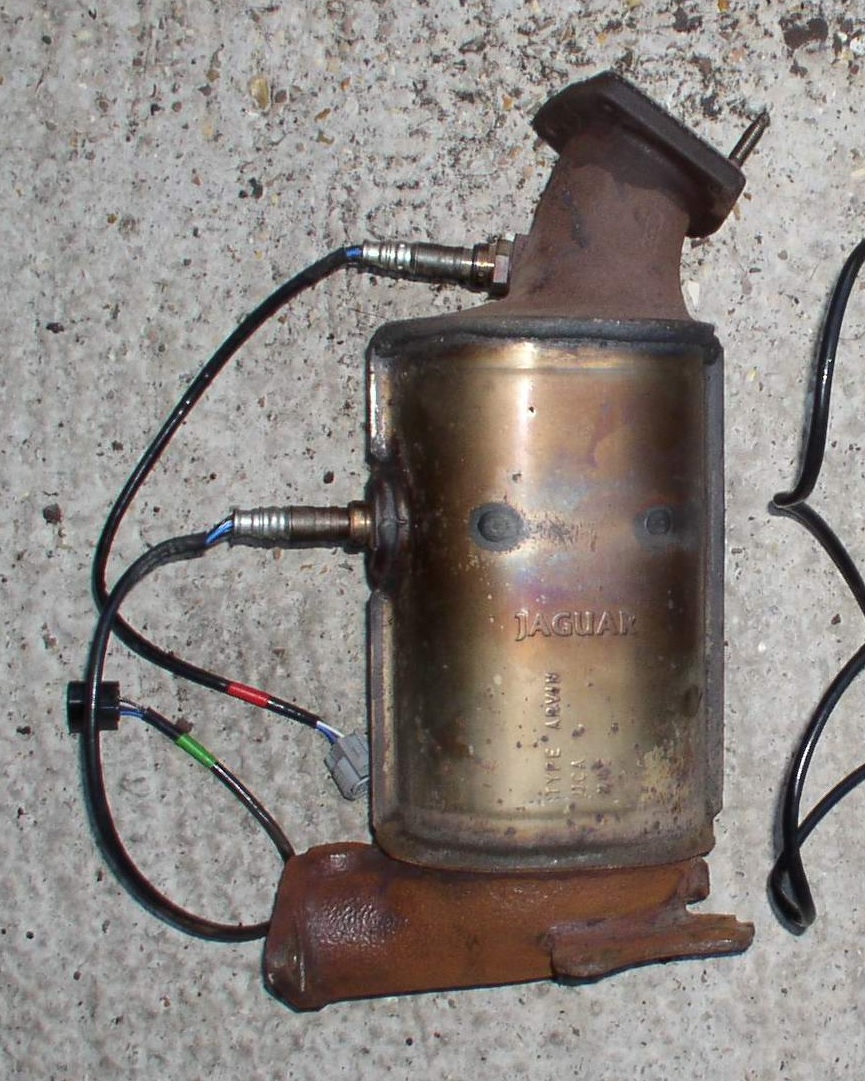

I gave up the struggle on my X308 and removed the cats to do this.
Even with the proper tool that goes over the harness the sensors were so tight and space so restricted, I just couldn't get sufficient leverage.
If you go for the same method, get replacement cat to manifold nuts (P/N JNZ100021). These corrode badly and for me they're a 'one-time' use item.
