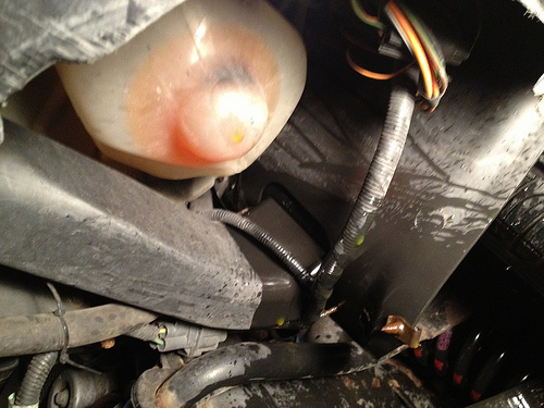

ok so i threw on the propane heater, and went looking around, the entire engine bay was completely dry, so i went under the car and started looking for where the coolant is coming from. all the hoses from what i could see underneath the car all looked completely dry, but then i saw this reservoir look alike thing
and there is a little overflow part, that looks like where it came out
what is this thing, and why would it shoot out coolant?

what do you think? should i try filler her back up with coolant?

thoughts anyone? i might try filling her back up with water, and see if she dumps another load, all the hoses seem to be in tact, just dont know why it shot out of the reservoir
