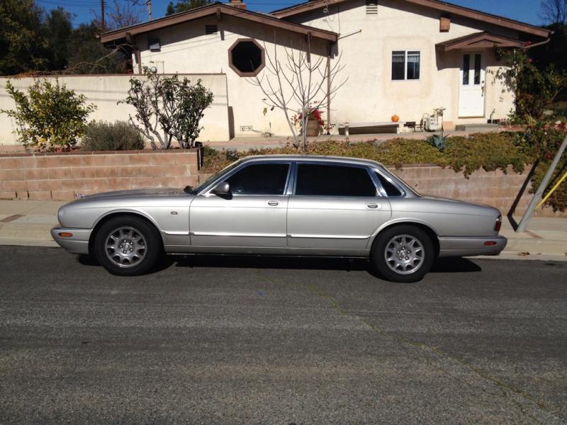

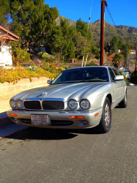

I think you got a bargain with that car; it looks to be in good condition.
The aftermarket wheels suit the car, and will be easier to clean than originals.
If you are handy with a spanner should be able to fix trans. You may find it is not broken, just electrical prob. could even be old battery.
