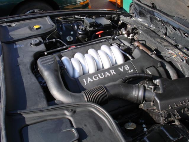

Thanks to the help of one of the members here and the great info on this site I tackled changing the tensioners on my 2001 XJ8L today. And yes like a twenty dollar hooker,there was crack involved! I have attached pics of the tensioners. The left bank had the normal crack in the body. The right bank had crack in the body,and yes that is the metal the chain was running on! I found part of the plastic part of the tensioner wedged below the chain. Last pic is of everything put back together. Car was running fine, no noise what so ever. Just hit 100K.

The pictures at the beginning of the post are second gen. tensions that both failed with cracks and the top of one was missing completely. That is an 01 engine in the pic.
