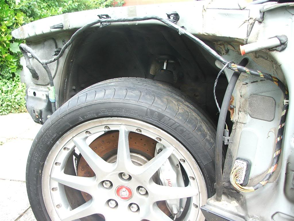

Plums, here's what's behind your wing I guess you have a hose connected where the red bung is for the sunroof? Your issue is that this hose is not fed into the inner arch?
I can see a problem here, if water from the sunroof got into the connector all hell would break loose, but if the hose is long enough, no problem.
Has your lower wing and sill rotted out?

and if you look at the second picture, there's the rubber drain hose for the air-con. I hope this helps you. It's not what I say, it's what Jaguar built.
As always your photos are a treat for those who have not gone that far into the car.
To clarify the problem, it is the fact that a provision was made by the design engineers to route the water to the exterior and that provision was ignored by the assembly line.
On a sunroof equipped model the hose would be fitted to the bung, but left hanging in the cavity to drip water all over the place.
While it is true that the water will eventually dribble out somehow, would it not have been better for the hose to actually exit through the wheel arch liner as intended by the original design? The cavity is not watertight, but less stagnant water pools couldn't hurt. Unfortunately, the assembly line didn't see it that way, even though the engineers tried to help.
Also, take a look at the rust around the scrivet in your picture. That was the second part of the caution to others ... that the cavity could benefit from the application of corrosion preventative such as waxoyl.
Sure cars will rust, but later is better than sooner.
I'd just like to point out to you that the car in the picture was submerged in some of the worst flooding that Cumbria had ever seen. Not only that, it is shown here in the process of strip down and it had sat outside exposed for a while.
I often wonder why Jaguar bothered to put a sunroof on the XJ because in my opinion not only do you lose headroom it ruins the lines on the roof.
Whether or not Cumbria flooded, would a coating of waxoyl not been beneficial?
