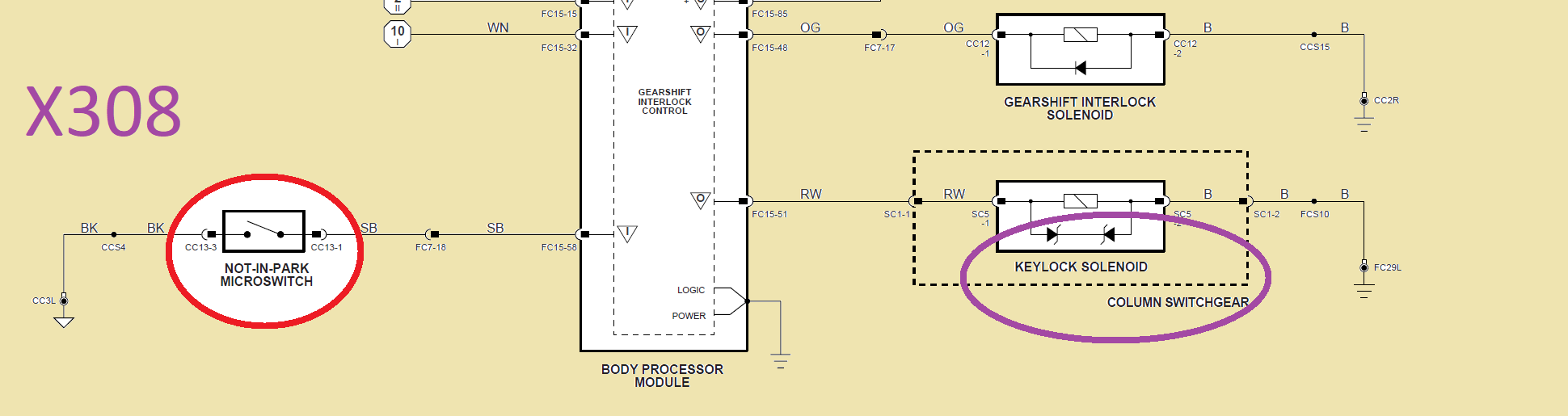

Rock the steering column and jiggle the gear shift while rotating the key and see what you get

Put your ear up to the key barrel and listen for a click as you move the gear shift handle but don't rotate key . If it fails to actuate the keylock solenoid every time it would point to the not - in - park switch .
If you can't find the whole switch with pigtail you can just read the numbers off the microswitch only as they are a common item . It's red button actuating length or throw is critical as they come in different lengths . a good hometown electronics store will have them on the shelf

That you for your responses. I will certainly try to listen for the keylock solenoid being actuated (or not). Also, thank you for including the links for additional information and pictures of the microswitch, and the exploded view of the gear change control with all parts identified.
