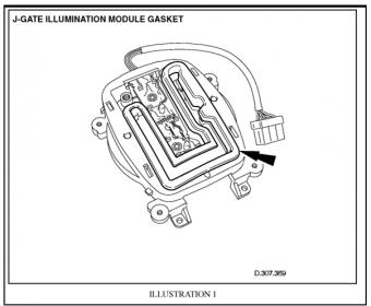

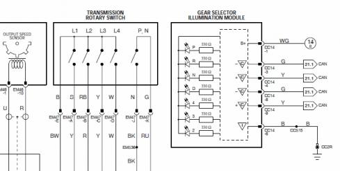

I think the switch is under the j-gate module

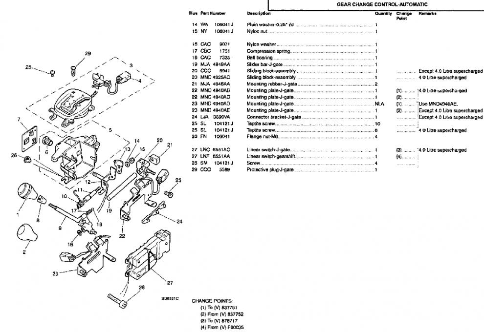

Old Mar 6, 2010 | 04:27 PM
Gus's Avatar
Gus
Joined: Jul 2008
Posts: 11,356
Likes: 2,236
From: Berlin Md.
I think item #27 is the switch
https://www.jaguarforums.com/forum/a...1&d=1267914556
