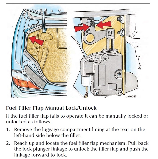

Sorry to hear about your lock issues. Whilst you're checking the possible causes, if you're locked out of the tank, it can be opened manually:
