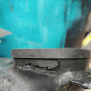

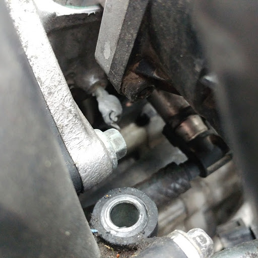

Brake booster hose that goes from the bottom of the throttle body to the booster. Broken at the throttle body. RTV and a standard vacuum fitting inside the hose was used to fix it. I don't think it was doing the job, but the brakes did work, or maybe it was.
Someone had put RTV on the hose nipple on the exact opposite side of the throttle body, to stop that one from leaking and the hose was just laying open in the engine bay.
The air intake turn down at the top of the throttle body is cracked and I believe leaking there also.

I've attached pictures.
