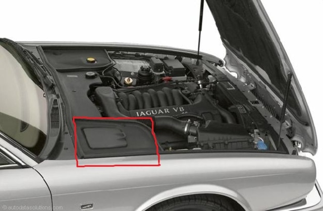

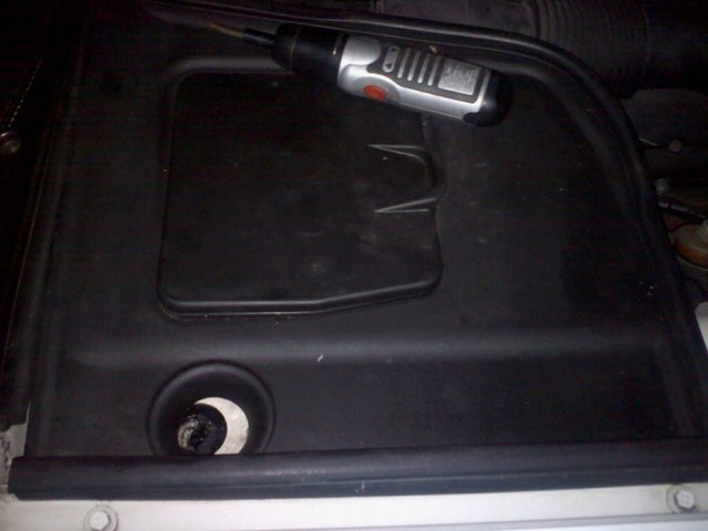

On a side note when I popped the hood a piece of the engine's top cover was vacuum stuck to the hoods foam , so I had to put that back. But I what I need to know what is it lol ? It has a cover which I opened to find nothing lol I'll attach pics below.
Yes my neighbors love me tinkering @ the wee hours of the morning lol.
Mine
Where it is in stock pic.

Long, long time ago, in the land far away,........ people that build this car, put a tool kit in that spot. These tool kits can still be found on Ebay. That was the time when people who drove cars like this, didn't mind to tweak and fix on the go. I am without Jaguar for a moment, but I kept my oil checking rag, and a tire gauge there. Tool kit I carried was in the trunk, and it was better than what was provided with the car at the time.
