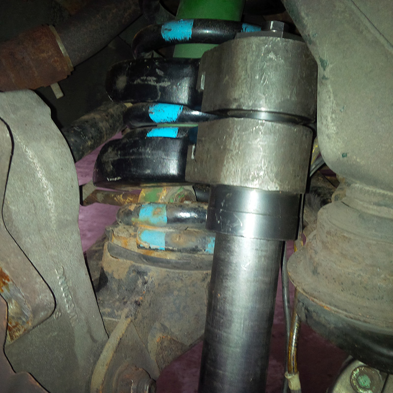

Since my XJR got massive springs, I had to use a solid spring compressor (see attached picture). Pressing the bushings out and the new in was easy. As the old bushes fell into pieces while pressing them out, I could use them as an adaptor/guide to press the new bushings in. When pressing in you should avoid to put pressure on the guide bushing for the damper bolt (red marking) - so the outer ring of the old bush is very helpful. But first I had to remove the rubber gaiter for the pressing process. Afterwards it's easy to put it back on the bushing, even though it's a little fiddly.
I did the replacement without removing the wishbone from the hub carrier. After removing the brake disc, I compressed the spring and unbolted the shock absorber from the wishbone. As shown in JTIS, I retracted the damper through the wishbone aperture and locked it temporarily with a bolt through the spring coils and shock absorber lower bush. After unbolting the spring upper mounting (4 nuts) from the body and securing the mounting to the spring using a tension belt, I could remove the whole spring+upper mounting+damper assembly from the car.
However I'll go with removing the hub carrier from the wishbone next time...probably that's way easier to get the spring+upper mounting+damper assembly out of the wheelarch.
Then, you can remove the damper and start with the bushings. The spring is compressed during the whole disassembling and assembling process. Watch out to use a quite solid and heavy duty spring compressor. The spring compressor that I used had discs with barbs to prevent the spring coils from slipping off the compressor.
