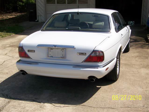

I just bought what think is a 98 XJ8. Now my question: Is this a "Vanden Plas" or "XJ8" or "XJ8 Vanden Plas"?

98 XJ8 VDP would be my take on it, with the VDP denoting higher spec trim than base.

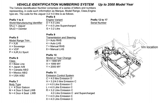

What is the 5th char in your VIN?
For pre 2000
F=XJ8
H=Sovereign
K=VDP
P=XJR,XJ Sport

1st 5 are SAJKX...........

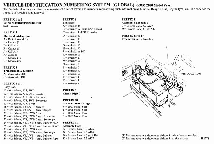

Interesting, does your VIN fit in this range?
I believe you can email Jaguar Customer Service direct in the UK with your VIN and they will return all the details they have when it left the factory, I dont have the address but i'll have a look around see if I can find it and repost.

In addition to checking the VIN details as supplied above, a quick visual way to see if you have a VdP would be to look for an inlaid inscription "Vanden Plas" in the veneer to the right and below the clock. In addition, the badge on the right hand side of the trunklid will state Vanden Plas too (plus the picnic tables on the back of the front seats are another indication).
I believe all Vanden Plas' are long wheelbase i.e. stretched 5 inches or so compared to the standard wheelbase.
If you have a stretched version (rear doors are longer than the fronts) but it is not a Vanden Plas, then it will be an XJ8L.
If your car is not stretched then you probably have the XJ8.
If you still wanted confirmation then post a picture - that will be guaranteed to resolve it for you I'm sure :-)

It's a Vanden Plas. Just wondering to what to call it when others ask what model I have. Do I say XJ8 or Vanden Plas or XJ8 Vanden Plas?
