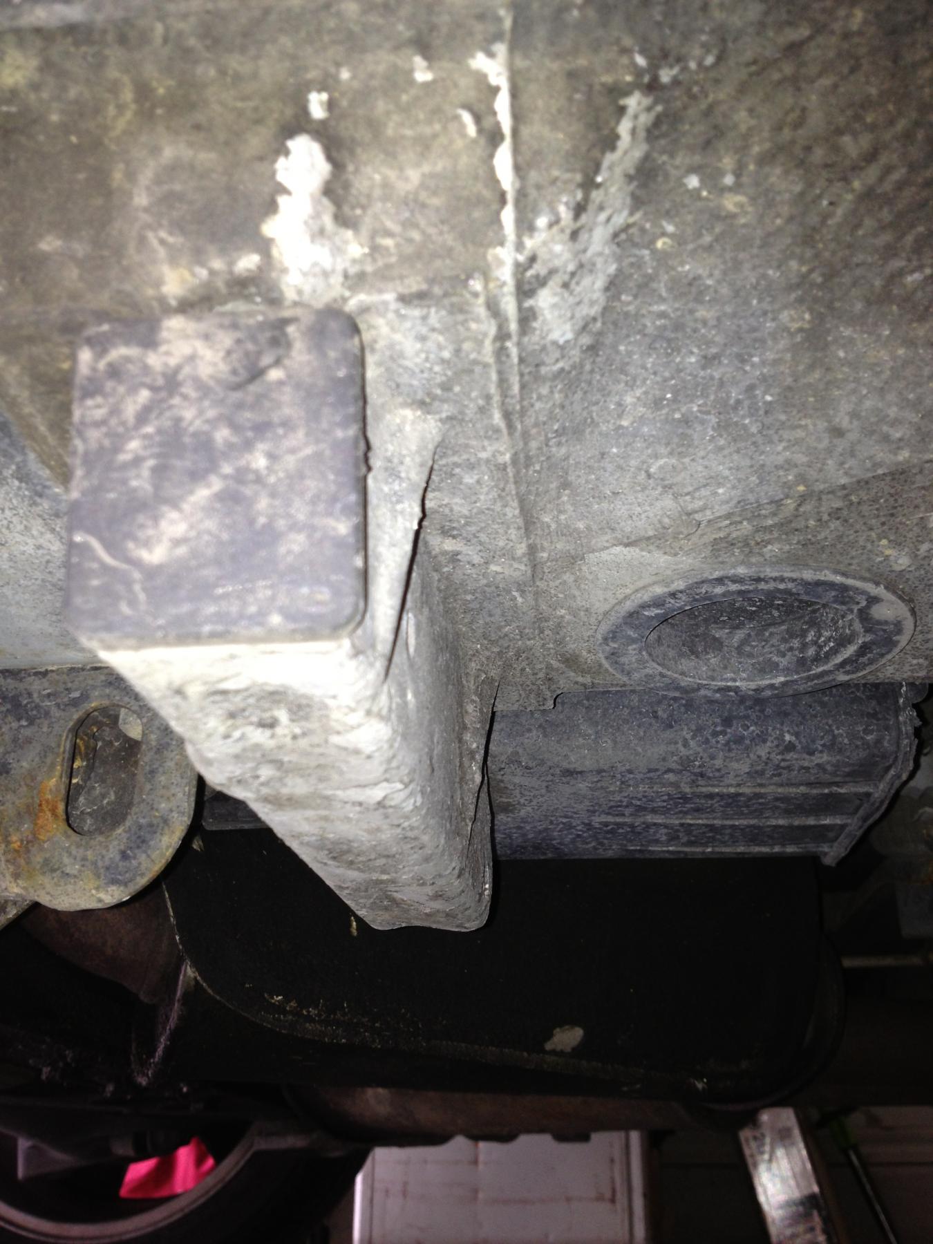

My first order of business was to replace the valve attached to the charcoal box at end of the vent hose from the fuel filler neck. It is located just inward of the jack point on the passenger (USA) side. My understanding is that gas vapors are vented through this hose to the charcoal box, which is connected to the engine as part of the vapor recovery system (someone more knowledgeable than I can correct me if I am wrong). At the end of the hose is a valve that opens to allow vapors into the box when filling, and closes when vapors are not present. The problem is that if the valve malfunctions and remains in the closed position it will not allow vapors to pass into the box when filling. With no where else to go, the vapors travel back up the gas line when filling and trigger the automatic fuel shut-off on the gas pump. You put the nozzle in, pull the trigger, and get virtually nothing.
It is an $85 part at the dealer and a simple part to replace. After doing so, I took it to the gas station and filled her up. Worked perfectly! However...

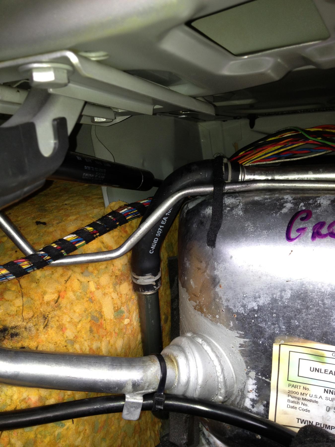

"Your car still smells like gas", says my 12-year old. "I know, I am working on it", I hiss. Dang it, I still had a gas smell! I crawled under the car to double check my connections to the charcoal box. Nope, they're good. While making loud sniffing noises like a hound, I moved to the backseat area and found that the odor was stronger on the driver's side. I then moved to the trunk area: strongest odor was coming from the corner ahead of the CD changer. I started removing trunk panels and found... a rubber hose coming off the gas tank that some clown forgot to reconnect. Idiot, I muttered (amongst other profanities), as I reconnected it. Bam! No more gas smell!
