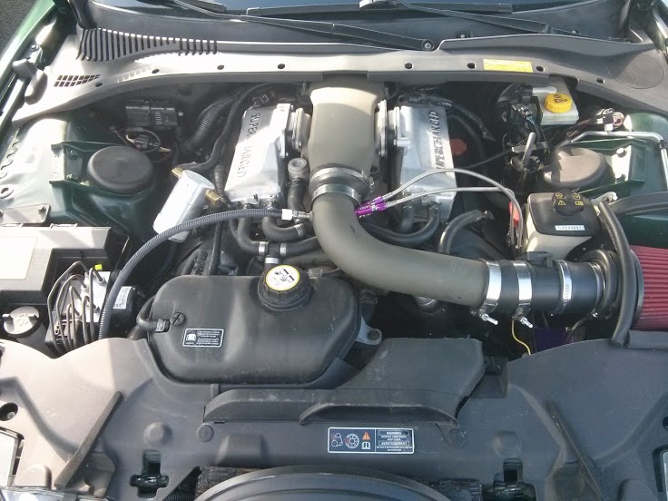

Muppet Labs strikes again. 0-100 10.4 seconds @ 18-19 psi
Exhilarating stuff these top fuel dragsters, imagining what is happening technically to accelerate is just mind boggling considering what we are doing.

I did try on the dyno without meth and only lost 7 hp. So with the small increase in boost the meth only gave 7 hp. I expect the gain will be bigger with my now 18 psi.
I am currently waiting for my supercharger to return from a minor fix. When I had it rebuilt the guy put in a solid coupler which, as it heated up and flexed a little, made a clicking sound as the rotor was hitting the case. The fix was to send it to Steig and have them machine .010 off the case and go back to the stock type coupler. It should be back to my house this Sat or Monday, and I'll have it on the car about 1.5 hours after it arrives.
As soon as I determine all is well, I will schedule for a dyno so I can then report on what the AFRs and power outputs are with and without:
Water/meth
Kenne Bell boost a pump
First run will be with water meth and the 17.5v boost a pumps running, then, as I assume it will be as you say "pig rich" I will start backing off the other stuff (and try injecting water only vs "boost juice" to see where the AFR goes. I'll keep it on the richer side to be safe, but I would be happier with 12:1 than 11:1 . Yes, with approx 13 psi I was running about 11:1 AFR as can be see on my video dyno (this was my last set up with approx 13 psi,) and I am now running a solid 18 so it will be interesting to see what mr dyno says. Here is the approx 13 psi dyno This car ran a 13.2 @ 105 in the real world on street tires. The #s are from a Dynaflow which multiplied by 1.22 would = a dynojet, so this 299.4 x 1.22 would = 365 RWHP on a dyno jet

After getting the dyno numbers, I'm pretty much calling the car done enough for me. The car is somewhere in the mid to high 12s in every day street condition, on street tires with a full trunk of junk.

On a side note for AFR on a boosted aplication I would suggest tuning for 11.5-1 or richer. 12-1 on a boosted application is slightly on the leaner side.

Just 75 on the nitrous, and I forget the size of the injector for the meth. I want to wait till it warms up until I try it out though. From what Ive read the nitrous and meth play very well with each other so let's see if I can get mid 12s
