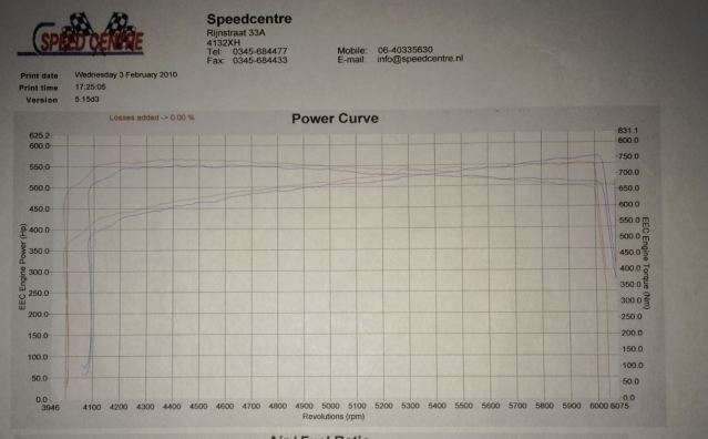

Here is his first dyno claiming 337 HP
Here is the first dyno I ever did on my car, it was bone stock back then.
The engine power has been calculated (about 17% drive train loss), it is of course the wheel power you should look at. But I need to add that the 17% drivetrain loss used is more to the truth than 20%.
The rwhp came to 327.9 uncorrected, and the din correction for the day was about 1.03 so acutally 337 rwhp (they only corrected the rule Power with this, and it was 86 degrees).
Dont' want to hyjack this thread either, only want to show you that my 4.0 engine (very similar to yours, though with some small differences as it is a AJ27 versus the AJ26) also has had a high output and without any modifications at the time. This doesn't mean that the modifications you have haven't brought you anything, as maybe your initial power output could have been lower.

He states his car is stock.
He gets reading of 337
Everyone else in the world gets 307
Proves his dyno read 10% too high
631-63 equals 568
Show 1 TS dyno or 1/4 mile that proves more than 568

All my other runs (60+) have been the same dyno in another place (closer to where I live), where on average at start my stock car made more in between 310-320 rwhp din corrected (I never look at the uncorrected figures).
This was also similar on that same dyno with other 4.0 R cars I had tested there. My latest 524 rwhp was on that same dyno, and that isn’t the max you can get with the kit, that is not holding it back…
Just as a side note, If you convert this 327 number you saw to SAE for the environmentals shown, you would get about 326 sae net rwhp, so still close to the average you seem to come up with.
So, my dyno is not reading 10% high, you are incorrect.
But good to mention, I could have gone back to that 1st dyno for a higher reading; my last run would have probably been there 540 rwhp then and 650 HP. But I wasn't doing the dynos for others (have you any idea how expensive this is here)? This was for me to see what I could get.
So, I have given the facts, and If you don’t believe this than that’s your right!
Now shouldn’t you ask similar proof from WD to show an increase of 100rwhp? I haven’t seen anything yet, or have I missed something?
