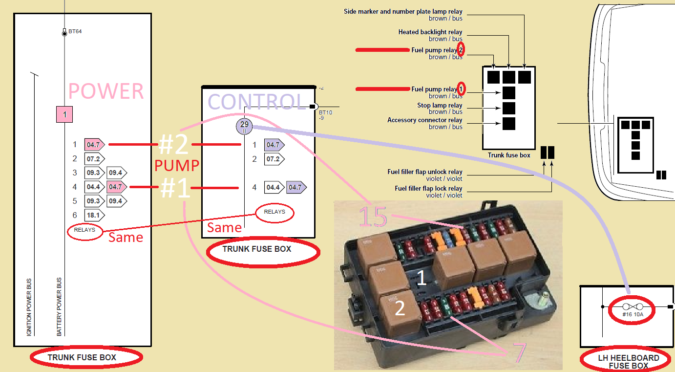

You can jumper the # 1 fuel pump relay to pump it out
This will be socket 3 to 5
Should put in a new main fuel filter that has o - rings
You can hear the initial 3 second fuel priming if good ears or head in trunk
You can click on image twice to magnify and drag around

Soon you will be doing this

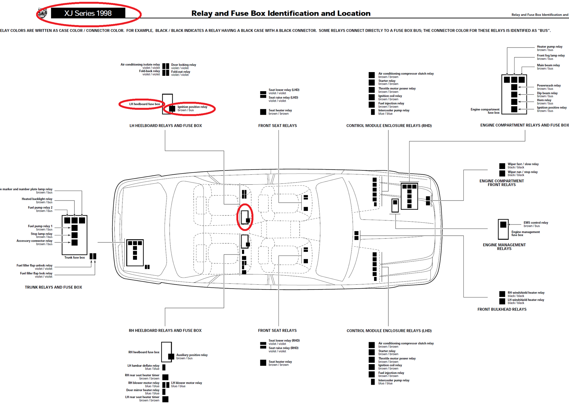

The basics of the cars electrical distribution is the ignition switch which provides a ground to close the king relays
See page 93
jagrepair.com/images/AutoRepairPhotos/jagxj2000.pdf
The king relays are the left heelboard ( ingnition positive relay # 2 ) and right heelboard ( auxiliary positive relay )
EMS relay
Ignition Positive Relay # 1 in the engine compartment fuse box
something different about the location of the Auxiliary Positive Relay between the 98 and 2000
There was a electrical design change between those years

There is a big fuse pair called a high power protection module down from the positive battery post
this can be seen on page 93
The fuse terminal nuts can come loose from reading
I have a pic back a few weeks ago from someone posting
Page 36 and 93 of the 2000 wiring guide would be the accurate information on the Auxiliary Positive Relay location
This relates to later in the control of the fuel pump relay and a fuse

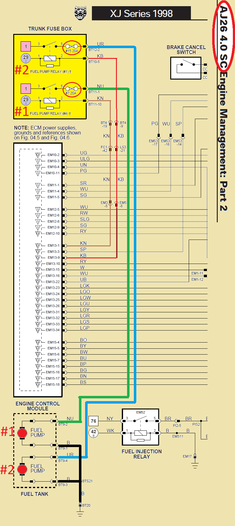

But at this time you are directly powering the pump
something to note is 1/2 of the fuses in the fuse boxes relie on the king relay to close to be powered
the other 1/2 of the fuses bypass the king relay and are hot at all times
the fuel pump ( s ) power fuse is one of these hot at all times
This pic is for a 98 and would have to double check if accurate for a 2000
point 1 square is directly wired to the battery
you have the fuse after the relay in this case not normally seen in diagrams

The big fuse block nuts are very tight. Here is what I did. Your colored diagram shows the #5 FP relay lug to go directly to the pump. I jumpered #5 directly to the positive battery lead. Nothing happened. The 20 amp fuses for each pump are good, so that should turn on the pump. I did it for both pumps. Silence. Are both fuel pumps shot? I measured the resistance across the fuel pump windings and got 2 megs which is way too high for a motor winding. It seems like the motor winding in both pumps is open or the wires to the pumps are broken. I think I will have to pull the gas tank to further evaluate the pumps. Bummer.
