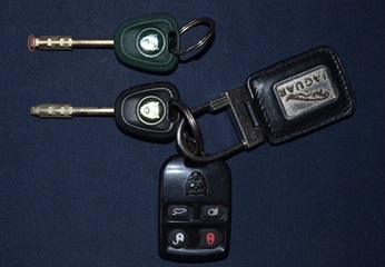

The keys (both black Master and green Valet) can be cut by a competent locksmith but have to be matched to the car on the dealer diagnostic system. A few specialist Jaguar Indy's also have this equipment.
Note the Master and Valet keys are cut differently but coded the same. The end of the Master is reduced in diameter compared with the Valet.
This is what enables the Valet luggage compartment lockout feature.
Before proceeding, make sure the blanks do have transponder chips embedded in the plastic head. (see red circled area)
Some good news is you can program another Remote/Fob yourself.
