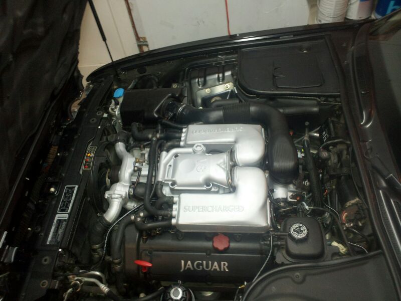

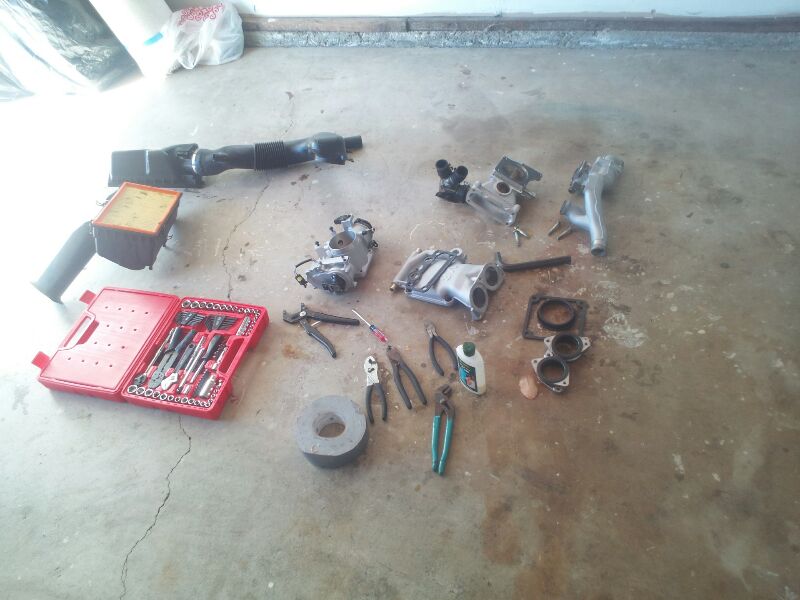

Pic 1 is parts on the ground at 6:30 P.M.
Pic 2 is showing the ported blower (steigmeier port, but High Speed Lab rebuild and rotor coatings) with special rotor coatings from The High Speed Lab that are immune to meth, fuel, etc. The port may not look like much, but the "v" is 4mm wider at almost each spot, and the inlet was ported too, so approx 10%? larger openings and now the intake and outlet are supposedly well balanced. This should be of some use when I add the +4 lb lower pulley soon. This will spin the rotors 14,500 rpm at 6000 rpm. Supposedly cavitation starts around 17,800 rpm, so I'll stay more conservatively cooler and only do the lower pulley.
Pics 3 and 4 are showing the car running smooth as a sewing machine at 9:00! It took only two hours to assemble and find my two vacuum leaks (brake booster hose not installed-duh, and one of the billows/seals was sucked in) and then 1/2 hour to fix the 2 air leaks to get it all running perfectly! No codes! I am relieved.
Took her out for a quick spin. Very smooth, but I can tell the intake is really holding her back. This will be fixed in the next week.

I am very relieved to have been able to get it all back together and running perfectly in only a few hours. I had changed a lot of things, so if there were any problems, it could have been difficult to find them. The two air leaks were loud so they were easy to find and correct.
