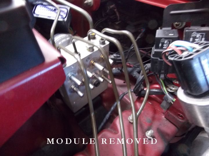

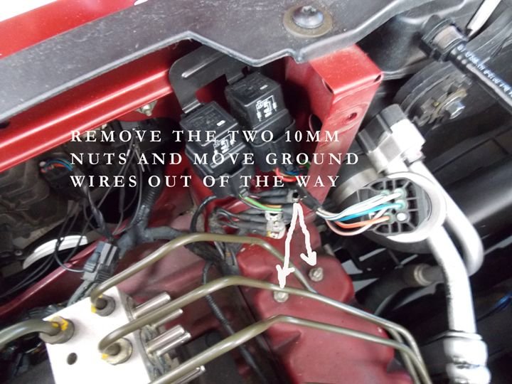

If you decide to repair the ABS module it is an easy fix.......... it would have been a lot easier if Jaguar had mounted the ABS unit 1/4" higher, and routed the brake lines just 1/4" further way, but even with these obstacles it was still pretty easy.
You just need to remove the two E30 torx screws holding the wiper relay bracket and move it out of the way. Remove the two 10mm nuts holding ground wires, and move the wiring out of the way. The ABS unit has a little flexibility in it and if you bend it back slightly you can access and withdraw the 4 E-5 torx bolts holding the Module.to the ABS unit. You need to pull the sliding latch holding the multi-pin connector to the module, and move it out of the way. Then squeeze and wiggle the 2-pin power connector to the module and also move it out of the way. Now all you have to do is bend the brake lines a little and the module will slide out.
There are tutorials on the internet showing how to cut your way into the unit to repair the solder joints, and others showing how to cut a window into the unit to do repairs, but I opted to send mine to a specialist shop for repair and testing https://www.shop.modulerepairpro.com...2001_c1140.htm (Van Nuys CA) ($99 plus $15 return shipping) It is a speedy service, you know the unit is fixed because it has been pre-tested and comes with a full lifetime warranty.
Minimal tools are needed.
