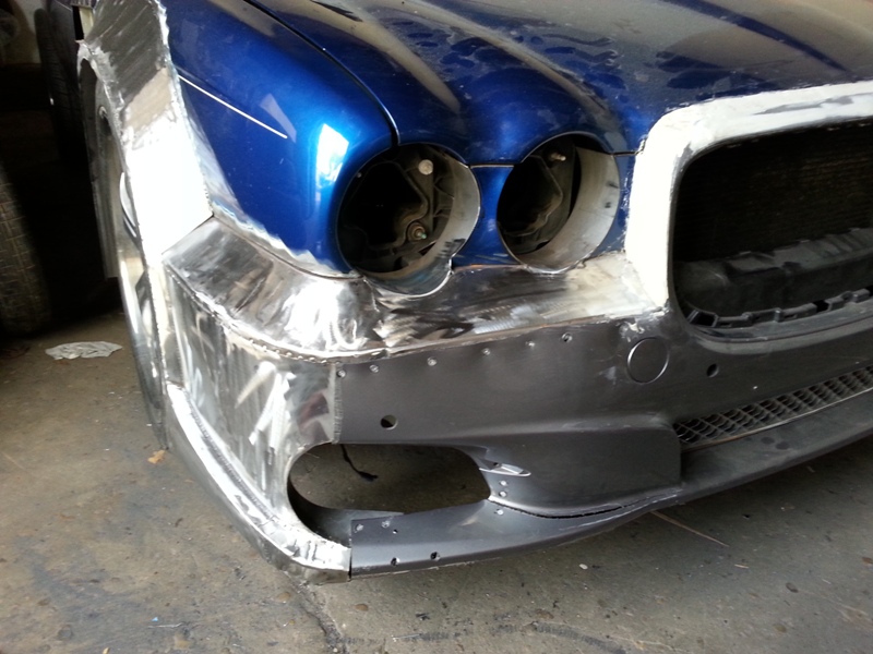

A couple more....... The bumper is nearly ready to fill up
I have had a change of tact...... Think I will take on what Sean mentioned earlier and do a coupe....... I have 4 front doors available to me would be a shame not to use them !!!

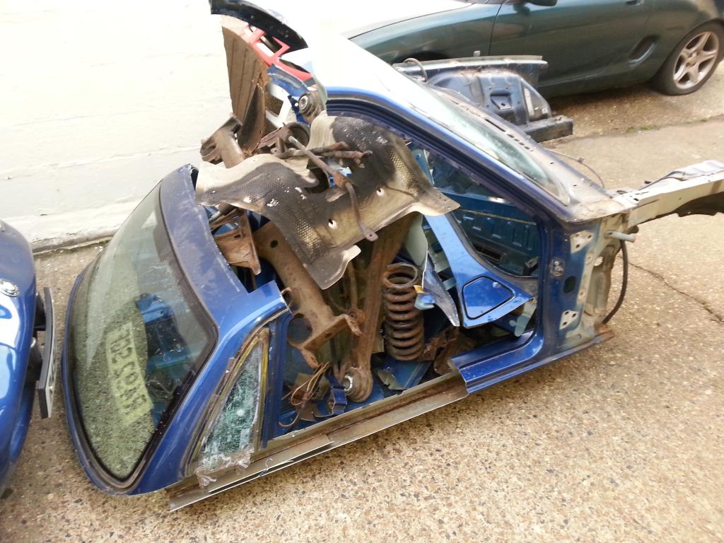

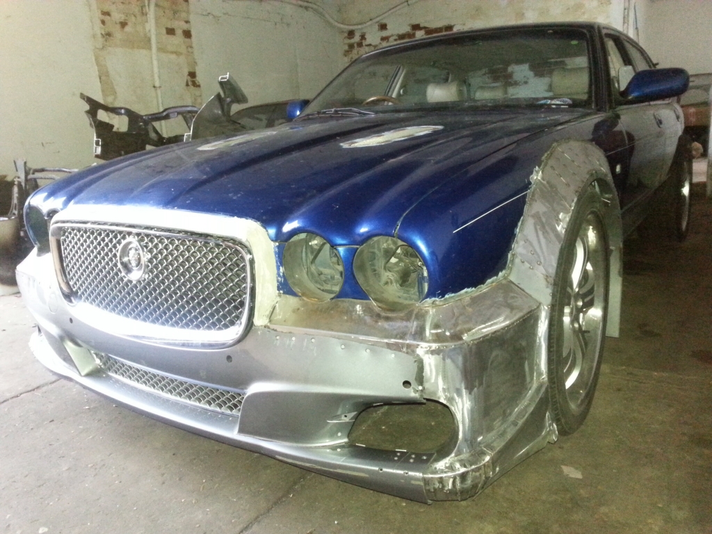

I believe I did mention on an earlier post this particular XJ will be stripped and scrapped...... Well here it is....!
This is the car that is going to be used..... The front I made has been fitted(ish) and the real modification will begin..... Once the weather has warmed up a bit that is

Some of the joy of having a donor vehicle..... You have spare doors and can cut sections out to weld in new positions.....
