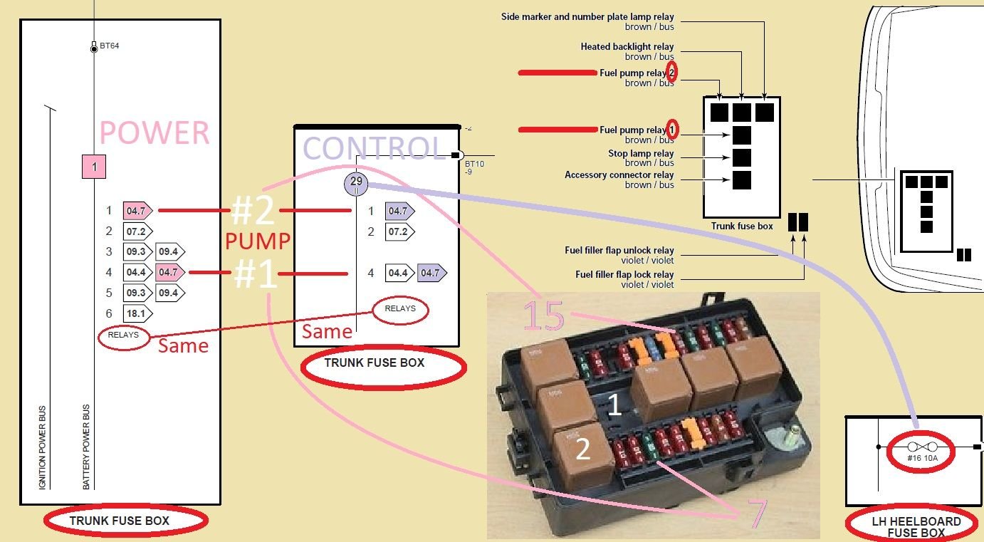

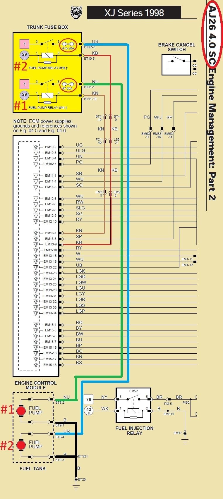

Main thing is to place finger on # 1 fuel pump Relay and feel for click closed on key rotation , 3 seconds then click off , than click back on on engine spinning / turning up in starting
The fuel pump relays are " controlled " by a secret small fuse at the rear seat other than the large power fuses in the trunk
# 10 left heelboard fuse box , this fuse may have to have the ignition positive # 2 relay ( in the fuse box ) click closed to power the fuse , there are relay swapping options to test , researching
This control wire path is very defiantly affected by the inertia / crash switch
At the # 1 fuel pump relay the large # 3 socket ( battery power , hot at all times ) to # 5 to the pump motor ( jumper wire option but the pump will run at all times draining the battery )
Is contolled by this small fuse having control power " sitting " on small socket # 1
The relay closes by the engine ECM providing a ground on socket # 2 to close the relay
This socket # 2 can be tested by a common meter as 0 resistance ( pump relay closing ) with no harm to the engine ECM
The socket back on # 1 will blow a replaceable fuse inside the meter if left on resistance position , so check before touching
This ground will be provided for 3 seconds only on key rotation
The ground will come back when the crankshaft position sensor sees engine rotation for the duration of your drive , safety design
There is a specific engine fuel injector relay to allow them to open , you can see it hanging out by itself at the bottom of this pic

With the XK8 the specific relay and fuse #s given are for the 4 door sedan XJ8 but follow the same form
The relay sockets will be the same ( 1 ; 2 ; 3 ; 5 ) but not the car location or fuse location
Old Feb 24, 2025 | 10:00 AM
Parker 7's Avatar
Joined: Aug 2021
Posts: 4,683
Likes: 1,325
From: Kansas City
For your 97 XK8
See page 24 and 33 ( NAS ) North American Specification upper left corner
Do you have starter rotation ?
For fuel You would have to put your finger on relay : EMS relay , Fuel Injector relay and Y and feel for click when starting also the fuel pump relay in trunk , fuel pump relay 3 clicks On 3 seconds - Off - On . The fuel pump " control " has a secret fuse Z , and of course the inertia / crash switch reset , this switch has nothing to do with airbags blowing
Fuse Z is # 3 / 5 amp trunk fuse box , this fuse requires the ignition positive relay in the trunk fuse box to click closed
You can jumper the fuel pump relay between socket 3 and 5 to directly power the pump but will drain the battery with keys in your pocket
Use medium gauge wire with blade type wire ends that the auto parts store can put together for you with a kit under the cash register , take the relay for blade size
