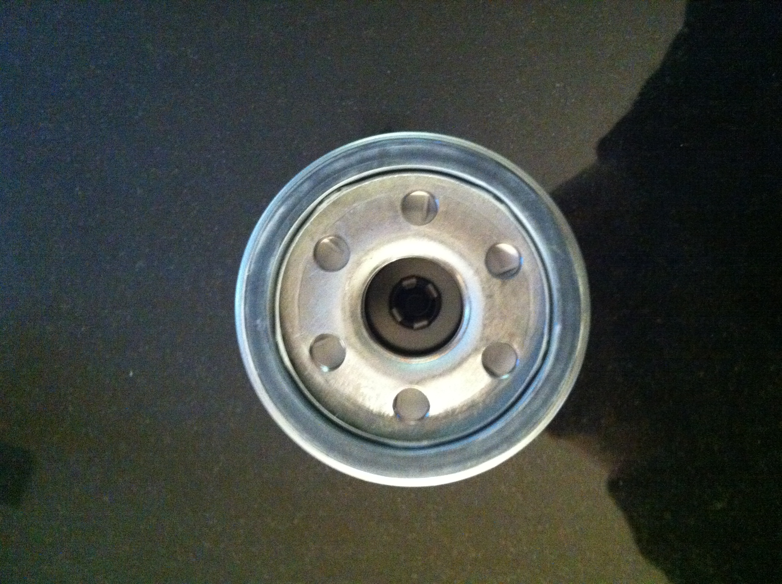

Old Feb 13, 2016 | 12:37 PM
yeldogt's Avatar
Posts: 1,887
Likes: 346
From: NE
This is the OE filter.
You can see it has a proper rubber bypass with a proper spring w/ support.
It's a hefty filter.
