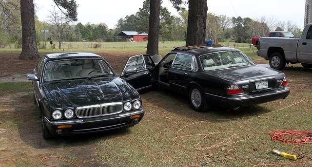

Here are the evil twins earlier today, swapping parts and plotting mayhem.
So far I have locking doors and partial window functions on the #1 car.
Not bad considering no new bloodshed!
