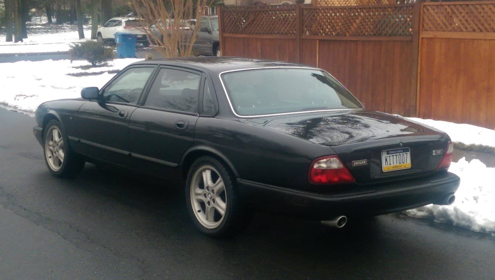

Ok, so its not just me. BTW, beautiful big cat! Heres mine

I'm rather amazed at the difference in the background of your car's picture, and mine.... I wouldn't be able to bring myself to take her out in those conditions.
Anyway - Enjoy!

That was the day I bought it and brought it home. I just had to take some pics for myself as well as family and friends
